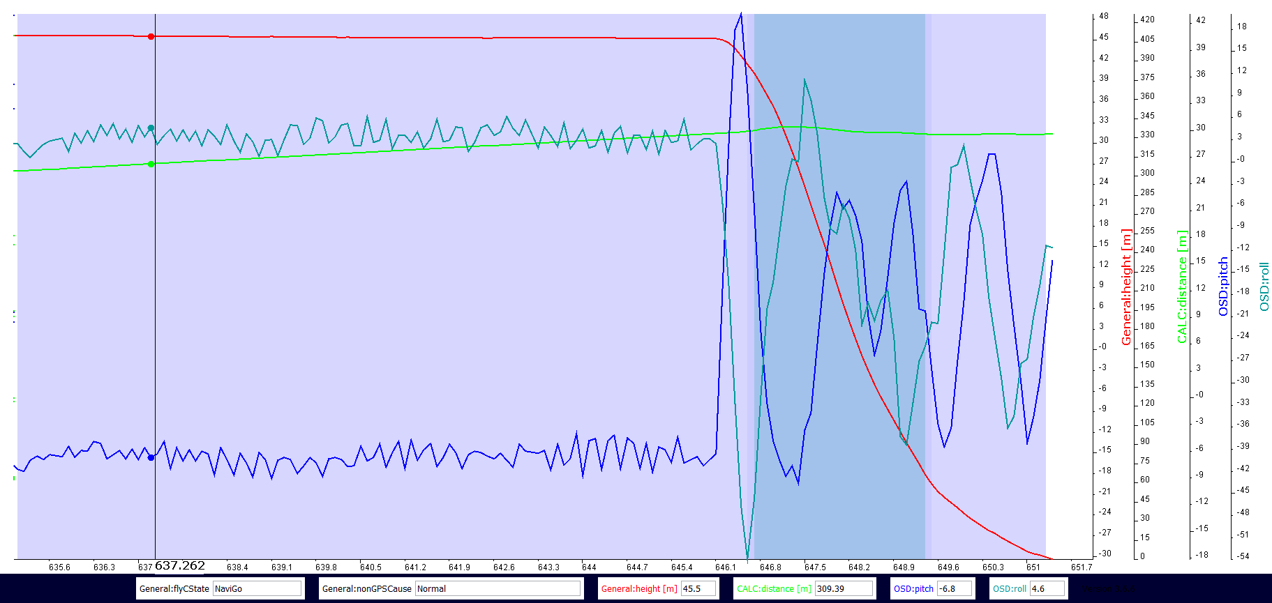

Still have never figured out why my P4P fell earlier this year, maybe someone here can help
Same scenario as the one I started the thread about.
This appears to be exactly the same as the previous flight incident, except a different prop this time. If you compare the two together you can see the difference in the Roll angle. It would be good to see the device .dat along with this .txt file to verify.
This current crash--the drone is in real bad shape. I have it in my possession though. Can I still get the device .dat from it when its extremely damaged? Here is the .txt file
