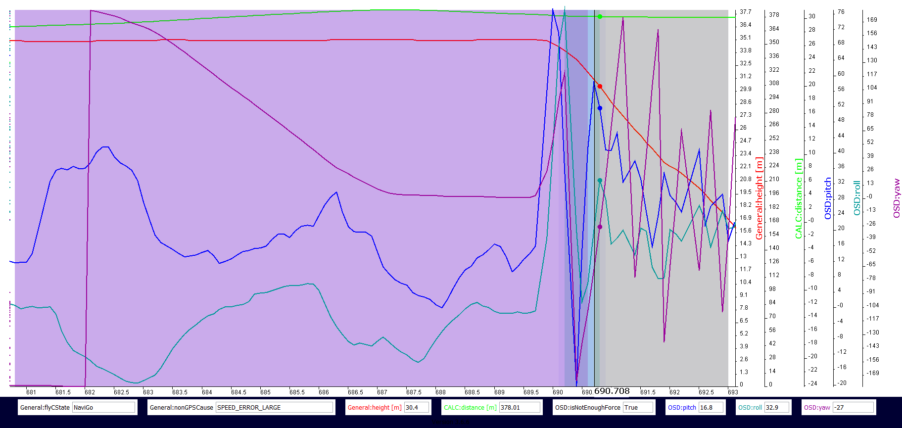

The flight is going well until 11:29.9 when there are sudden changes in pitch, roll and yaw data that indicate the Phantom has tilted backwards, rolled sideways and rotated clockwise.
The numbers increase and the drone is spinning a full rotation every 0.7 seconds, leaning heavily to one side and tilting forward and back as it loses height.
If collision and losing a prop have been eliminated, that just leaves losing a motor.
The cause could be the motor itself or the ESC that controls it.

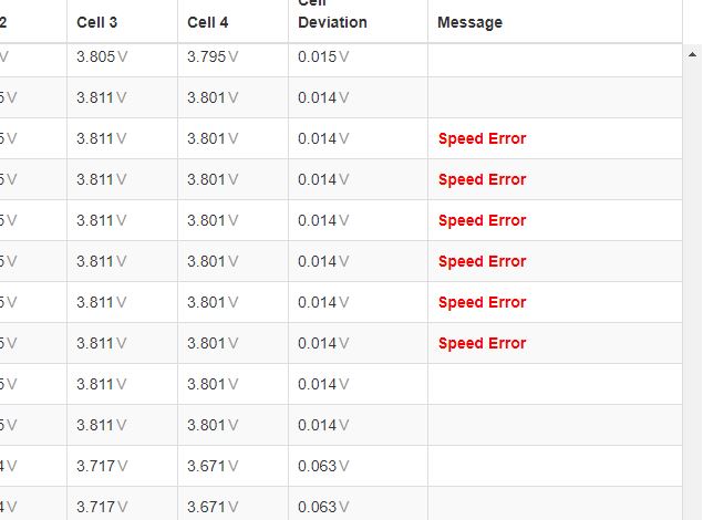

  • Sad
Reactions: JoBe and Havasu Tom
This is what i saw in your logfile right at the end.
Those messages were after the tumble began. Irrelevant to the incident itself.
Reactions: JoBe
