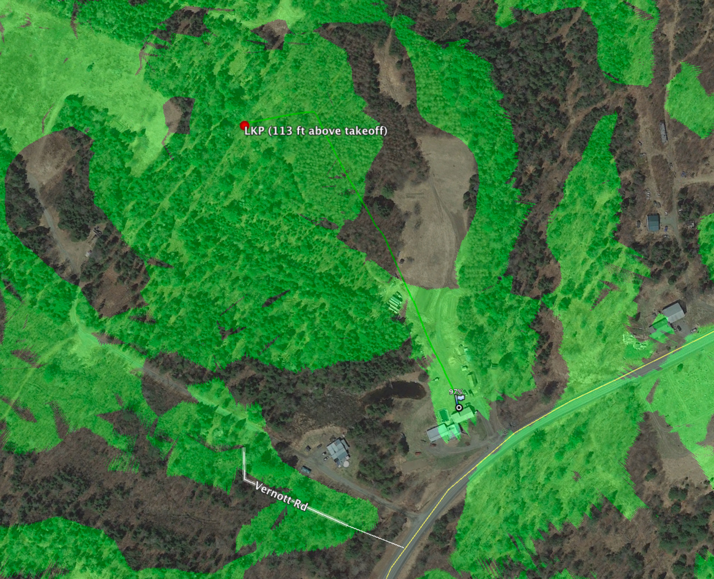

Flight Log.
Anyone tell me why it lost signal?

DJI Flight Log Viewer - PhantomHelp.com
There are a couple of problems evident here. The uplink was fine but the downlink was lost quite suddenly at around 950 ft, which is why the log ended. Secondly, the aircraft was probably too low for the terrain - you launched at 545 ft MSL but the terrain where the log stops is at 625 MSL, so with an altitude above the takeoff point of 113 ft the aircraft was only 33 ft above ground level. The log does not record the collision with the tree though.
There was no problem with satellite reception - the aircraft had 15 locked at the end of the log.

It lost signal because you did not have a clear, unobstructed line of sight to your Phantom.
Treetops were blocking the signal.
The number of satellites has nothing to do with the quality of the radio signal between your controller and the Phantom.
it was 113ft up, so don't believe it it the trees.
The height shown is the height above your launch point.
At the point where the flight record ended, the terrain was about 74 feet higher than the launch point and the Phantom would have been about 39 feet above ground level (not counting tree height).
If the trees were 40 feet high, that is all the explanation you need for the incident.

Once your Phantom has crashed into a tree it doesn't matter how many GPS satellites it has, RTH isn't going to happen.
How do I check the RTH Altitude?
You can check in the app when you have your Phantom powered on but it wouldn't matter what RTH was set at in this case.
The Phantom never got a chance to RTH.
In a Litchi waypoint mission, the mission will continue even if signal is lost. RTH will not be initiated.
In a waypoint mission it is extra important to make sure that you have sufficient height to clear all terrain and obstacles like trees because Litchi will fly exactly where you program it to. Even into a mountain (or treetops)

The OP was apparently flying using Litchi, but manually - not a waypoint mission. But, other than changing the RTH behavior on uplink loss, that doesn't make much difference. The line of sight question is marginal - I was going to post the viewshed from the last recorded point (see below) earlier but, without the trees, it indicated that line of sight existed. The downlink was lost before it hit the tree, however, and the signal quality was clearly degrading. The only slightly puzzling feature is that the uplink was still very good.

I also thought about why seemingly only the downlink was compromised. Might it be that a custom channel was selected for the downlink and the operator was unlucky enough to have another service operating on that channel? I’m not sure if the custom channel setting is stored in the AC or is GO app and controller specific (would not carry across to a litchi use instance).

The Litichi log reports that the system was using Channel 15. Does it use the same channel for up and down?
I don’t believe so. That is why the 32 channel hack was often helpful in increasing range. It made one extra channel available for the control signal.
