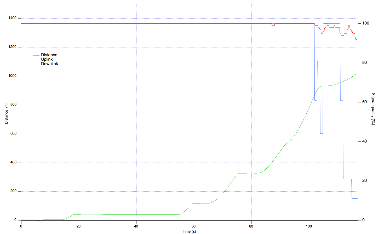

Signal lost, Why, Fly Log Attached
There are a couple of problems evident here. The uplink was fine but the downlink was lost quite suddenly at around 950 ft, which is why the log ended. Secondly, the aircraft was probably too low for the terrain - you launched at 545 ft MSL but the terrain where the log stops is at 625 MSL, so with an altitude above the takeoff point of 113 ft the aircraft was only 33 ft above ground level. The log does not record the collision with the tree though.
There was no problem with satellite reception - the aircraft had 15 locked at the end of the log.
Where in the flight log do you see the MSL elevations?
Why did it lose signal, because of tree obstruction??
Anything between your controller and the Phantom will reduce signal.
Get enough trees in there and you lose signal completely.
