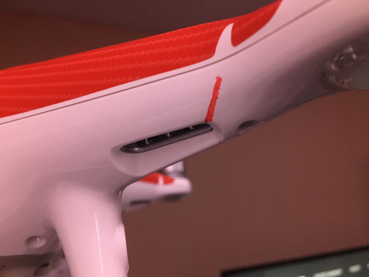

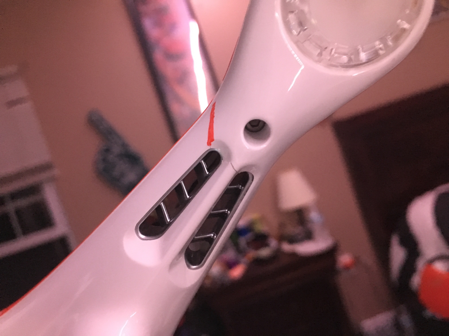

I just passed my part 107 test and bought a pre Owned phantom 4 pro. But when I got it I noticed these small cracks. I’m sorry that one of cracks having a red line its just so I could check if it was continuing to become bigger. I’m new to owning a drone and don’t want to have my drone fall out of the sky. I’ve been flying slowly because I’m scared to loose my drone that I just got. I just started up my drone business and I don’t wanna loose my drone while on a job. Any knowledge sent my way would be greatly appreciated.

Ok, first let me get this straight. You bought a used aircraft for Part107 use?....How long have you been flying? A license is just that. An "authorization".....You need much more than a test to fly commercially with any hope of profit from such. As far as the cracks, Yes ( To the point of being concerned )....these have been around for a long time.....

In that instance yes, if you do enough research you will find that the issue is relatively common with P3's and some P4's....it is an issue, but can be "patched" if you will. Yet still, it is an air frame integrity issue and can ( and sometimes will ) result in the loss of the aircraft.

May be just me but personally, I’d get it fixed. Equate it to a wing spar crack on a full scale aircraft. Not airworthy. Is that next unforeseen high speed sudden air-stop you make going to be the one that puts that arm over the edge? Send it to DJI or if you know someone with above average soldering & mechanical skills, buy a new lower shell and DIY.

You could resolve the issue by replacing the body shell. It's not a job for someone not experienced at precision work, soldering, and gluing, and you'll need some uncommon tools. I managed to do it okay on my P4, which is my backup to my P4A+. So you could send it to a repair place for the shell replacement.

My P4 is 2 year old, has 83 hours and just started cracking badly around the legs. I patched and reinforced everywhere I found a crack with 3/4 oz glass cloth and Ca glue. A couple layers works fine.
