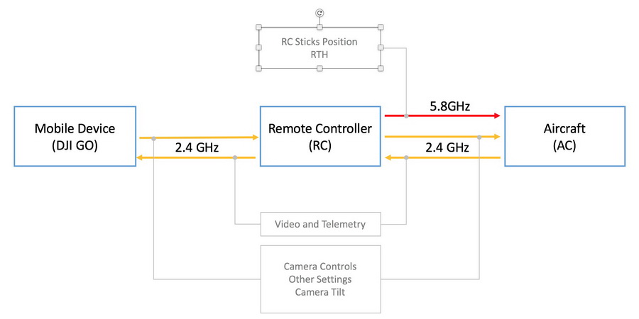

Sorry if this is a stupid question but am I right in saying the controller uses 2.4Ghz to connect to your phone and it uses 2.4ghz and 5.8Ghz to connect to the aircraft? What band does the controller use for video and what band does it use for control?
@Fly Dawg, @RodPad, @kevinp3s and myself had a bit of an offline conversation about this topic, and this is a diagram that will hopefully answer most questions about P3S communications:
PS: Camera Tilt could potentially go via 5.8GHz from RC to AC as there's a dedicated dial on the RC, in addition to the slider on DJI GO, but my guess is that it goes up via 2.4GHz, like all other camera-related controls.
PS: Camera Tilt could potentially go via 5.8GHz as there's a dial on the RC, in addition to the slider on DJI GO, but my guess is that it goes up via 2.4GHz, like all other camera-related controls.
Ah perfect, thanks!

Looks Good, still needs something, but I don't know what. ;)
