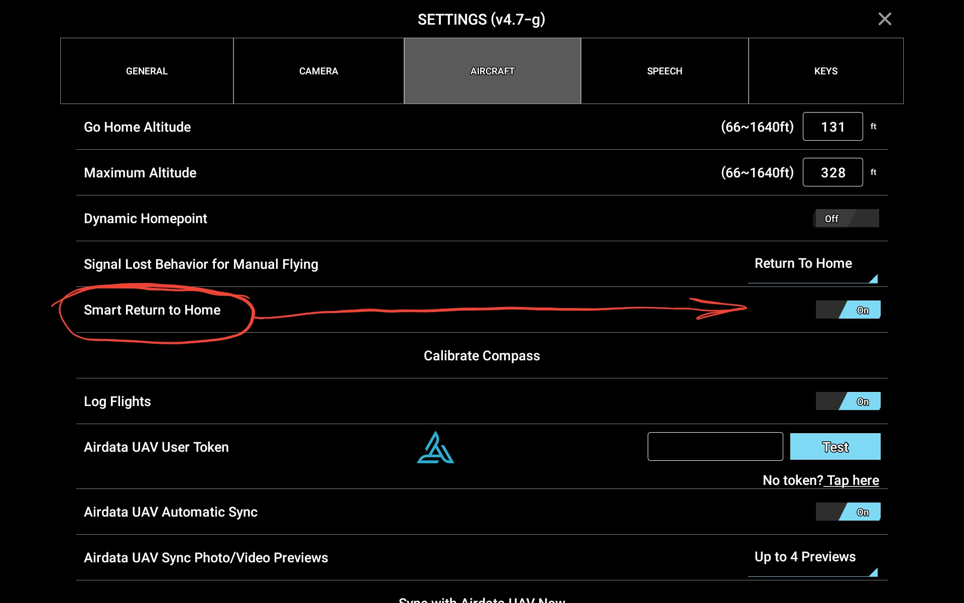

Is this what you mean,this litchi with p3s,it's got a smart rth
,,,,,should also add litchi a great flying app,good live info from recorded lady about all that's happening while in flight,height speed home point distance battery power,saves looking at screen to see what's what,,there's a free pdf download for the litchi manual,,have a read
Is this what you mean,this litchi with p3s,it's got a smart rthView attachment 100890,,,,,should also add litchi a great flying app,good live info from recorded lady about all that's happening while in flight,height speed home point distance battery power,saves looking at screen to see what's what,,there's a free pdf download for the litchi manual,,have a read
Thank you very very much for your input. Have you ever, when flying P3S in VR FPV lost signal? Did return to home initiate automaticly? Have you ever experienced any problems and or glitches with litchi failsafe modes? Sorry to ask nearly redundant questions. I am researching the litchi app for purchase. I am reading the litchi manual following your tip. Just looking for some experience based rth failsafe reviews. Please inform, I sincerely appreciate your input. Thanks in advance.
Sorry bit of a lemon answer here,I have not used p3s in vr mode,only p4,I just knew that the options are there,no I have never had any issue with litchi app or settings,because I not used on p3s it hard to comment on it,you might have to give that your own controlled test in good open area,sorry I can't give you a solid reply on this but do think it will work just fine

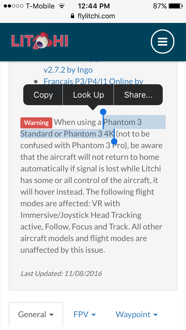

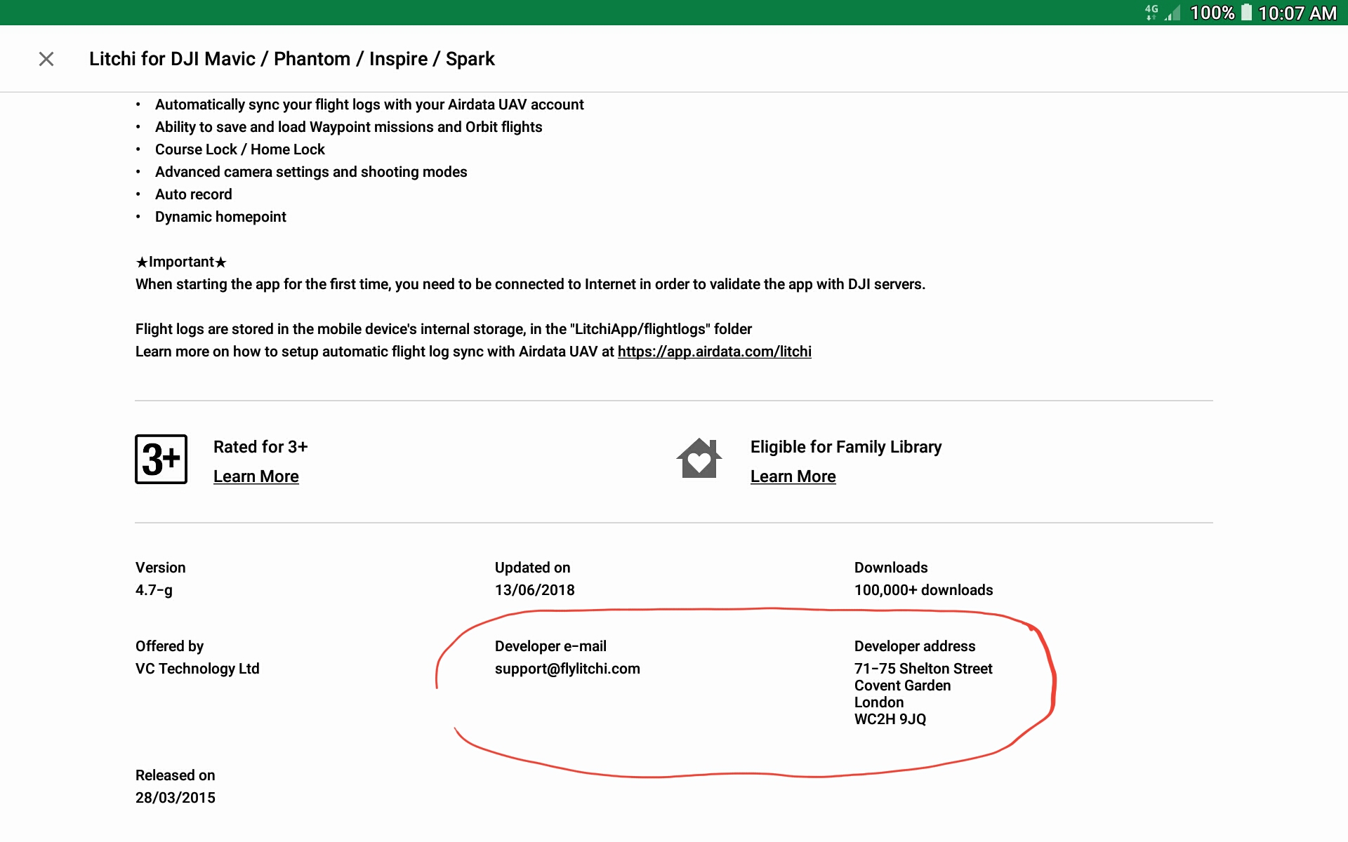

Do you have some reservation about making an enqy with the litchi developer? There were monumental issues with the DJI SDK and litchi the best part of two years ago as depicted in the following grab from the litchi help page.
They will tell you if there is a current problem.

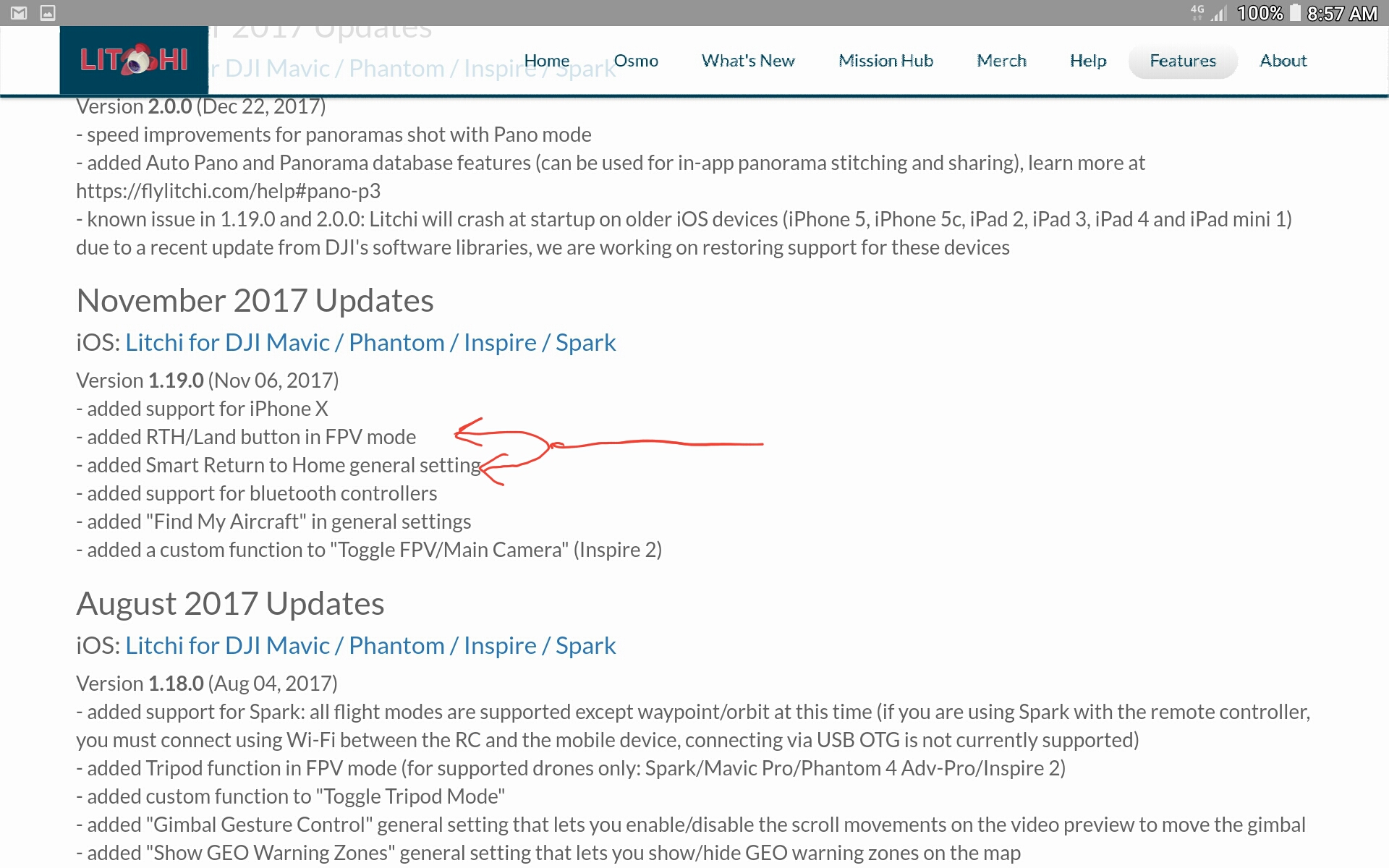

here's a newer one I find,someone's been updating, might have been added
View attachment 100917here's a newer one I find,someone's been updating, might have been added
Might have been.... Easy way to find out. This issue wasn’t about Litchi fixing anything. The problem was in the DJI SDK. From observations of DJI conduct it may well be they never bothered fixing the issue as they had newer models to support with money to be made.

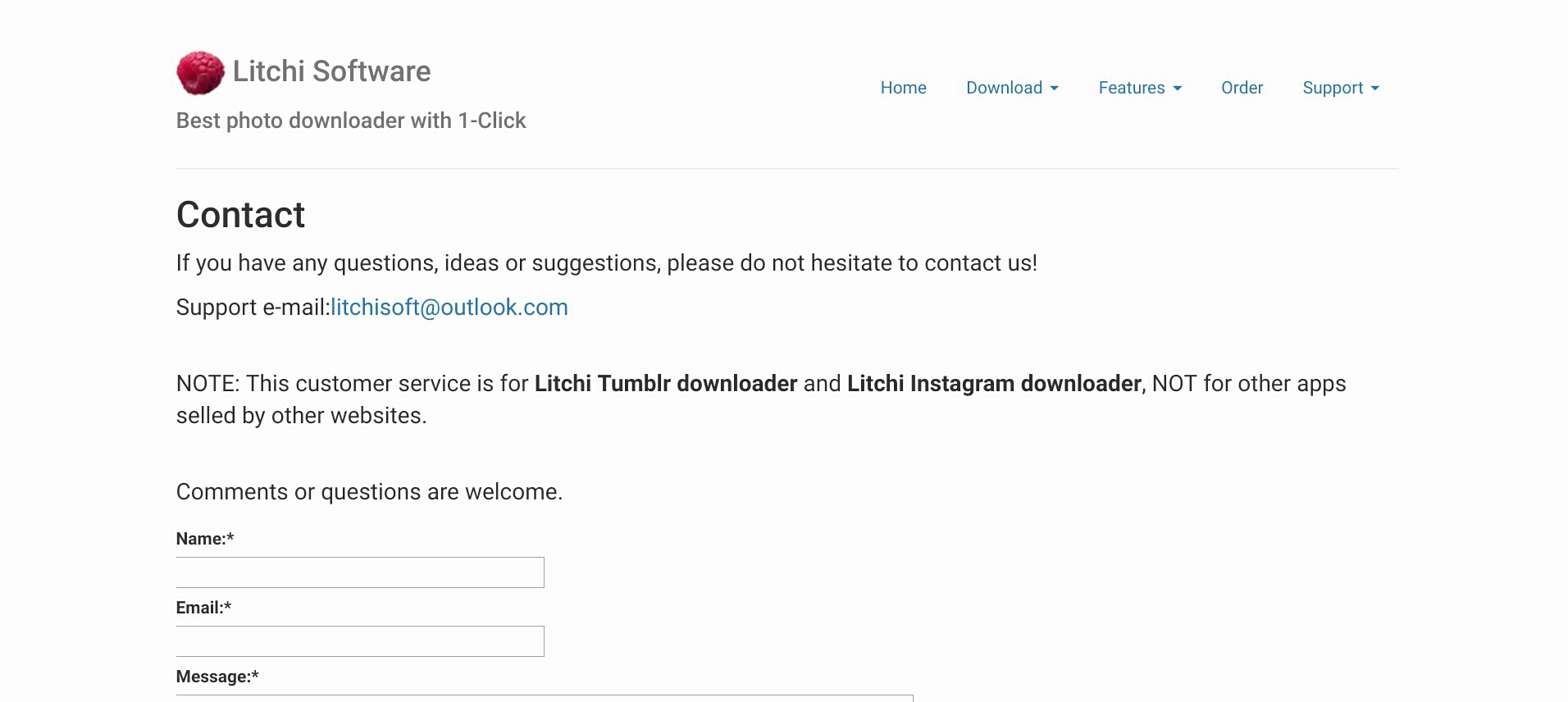

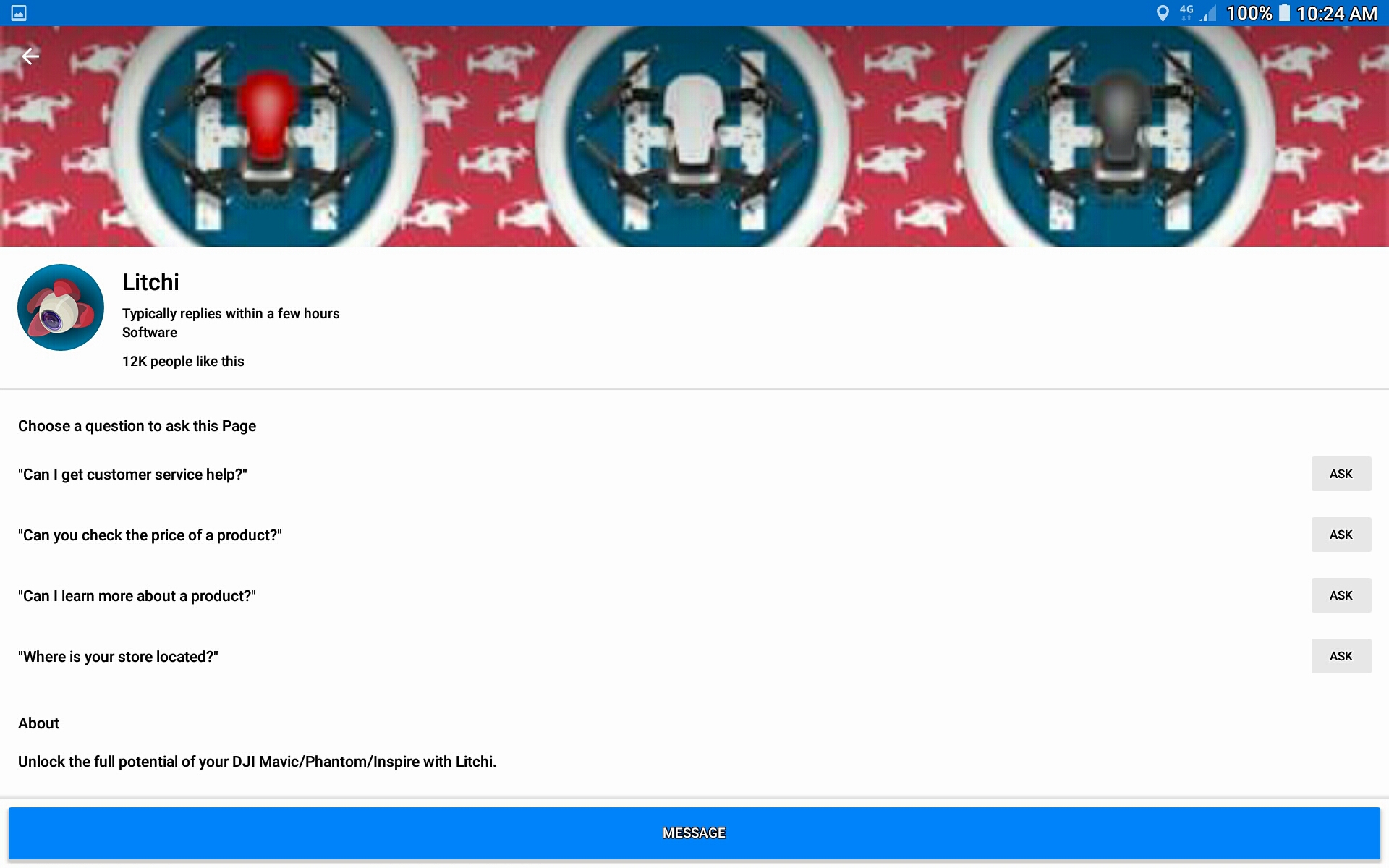

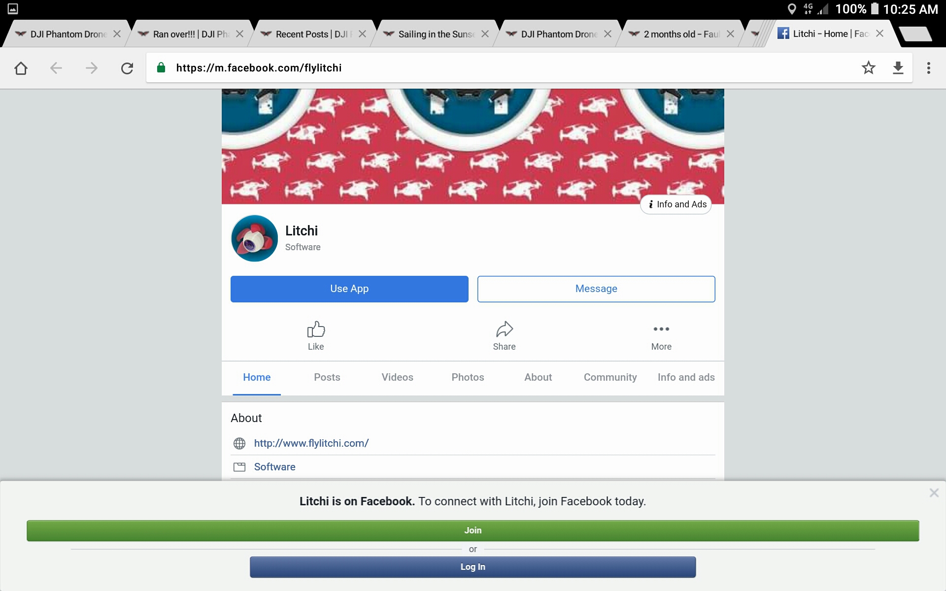

On facebook it has a message to them area,it say they respond in 12 hours if not in a hurry,,,send a message if no luck with the email above

Unfortunately this isn’t true. Both litchi and autopilot (and perhaps other third party apps that use the DJI SDK) have had issues where RTH did not initiate on signal loss in particular flight modes. Rather than initiating RTH the AC just hovered untill autoland on critical battery.

Yes, You can fly without the app and RTH will initiate following signal loss if you have set it to do so. The OP is asking specifically about litchi. The RTH performance issue was very real and perhaps still is to the extent DJI didn’t fix the SDK issue.

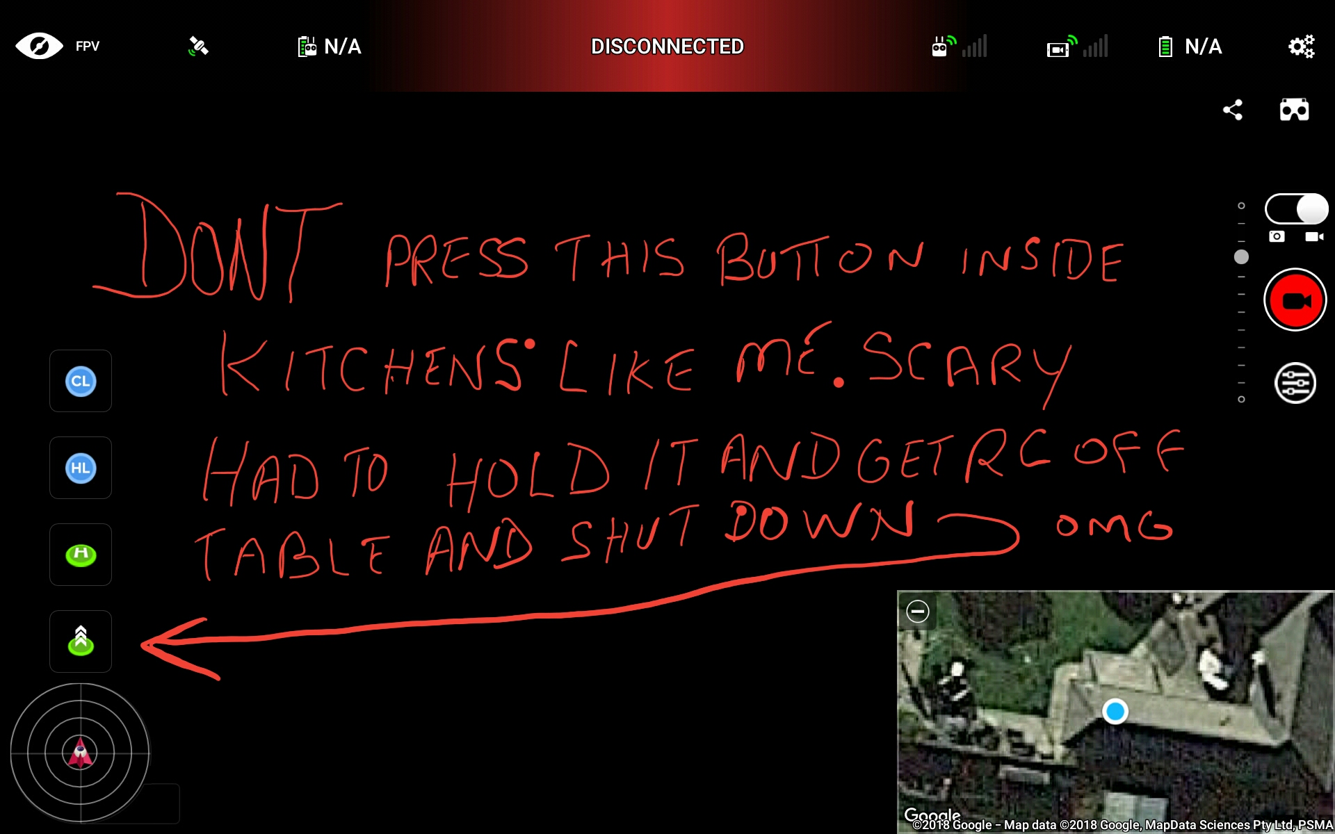

Had to add this,was very rookie moment
,,it was before I learn there was a litchi manual,never done auto take off so unaware what it did,
