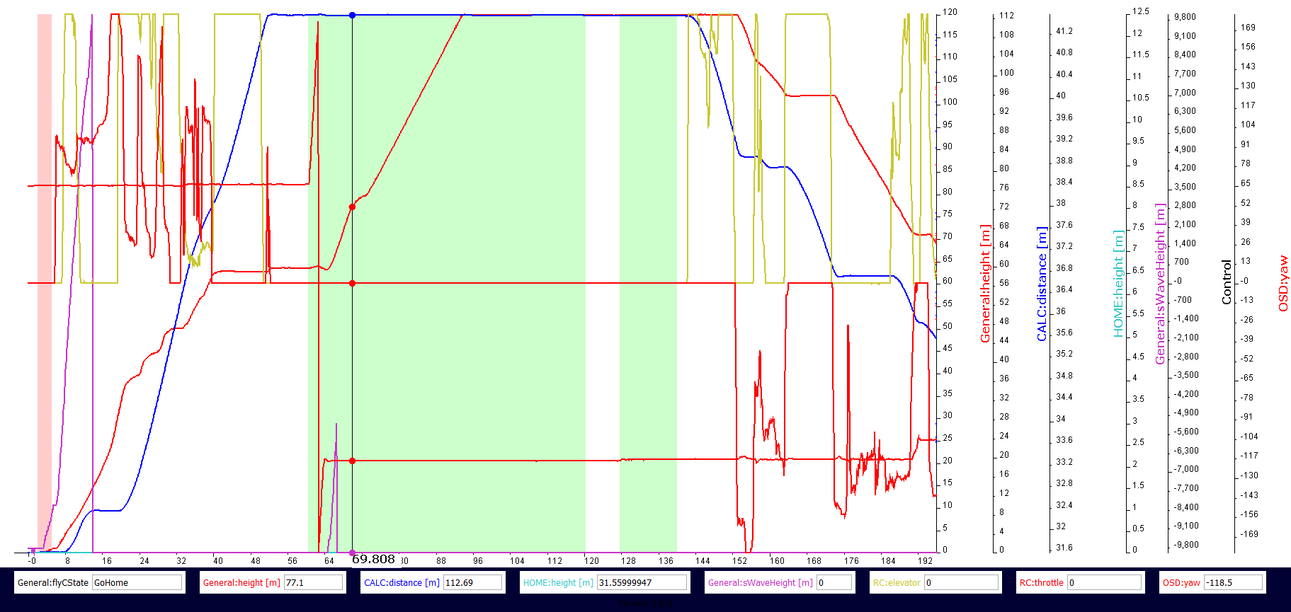

No, it does not. This one is a bit different. Other than one small spike from the VPS right after RTH was initiated ( Which should not mean anything ), we may need to see the aircraft .dat file to know more. I always prefer more "eyes" on the data, just in case. @sar104 Your opinion?
Yes - what is happening is that the FC is detecting an obstacle to RTH, and so it climbs to try to avoid it. Since the obstacle is spurious and continues to be detected, the aircraft climbs to its maximum flight altitude and then hovers.

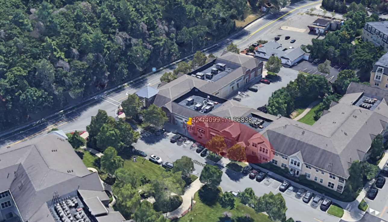

After looking at 5 of the flights, all of the RTH initiations were done in the approximate area below. I am suspecting that the VPS, and/or OA is seeing this building or the trees. That is a commonality in each flight. Try a flight in an open area where there are no buildings to obstruct the sensors and see if you get the same results. Then you will know for certain, since the aircraft functioned normally with the VPS turned off.
Doesn't that seem a bit unlikely if it was still detecting obstacles at 400 ft AGL?
If you are looking at the flight over the baseball field, I believe that was before the OP removed the gimbal guard.
Yes the flight over the ball field was after the guard was removed. I just went out and tested several times in the location with the buildings and all OA sensors on and it worked fine. Must have been a glitch in the initial firmwarw update
