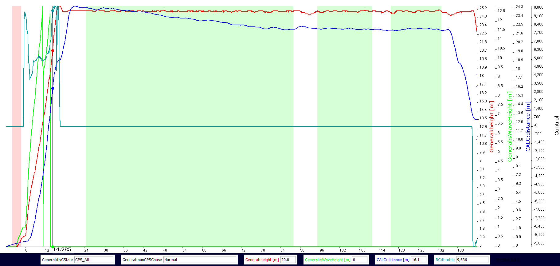

Ok, the first flight from Post#9, shows that you gave full throttle up to the set max altitude. You initiated RTH, and the aicraft was returning as it should. As you can see the distance decrease below. You then cancelled RTH twice more, and re initiated.
Still the aircraft was performing as it should as fare as I can see. I have not looked at the other two sets as of yet, but this is a quick preliminary.

It was at max height, but if you look at the distance in the graph above, it was decreasing (aka...returning )

Another quick glance at the other files. Nothing detailed here but I noticed in ALL flights you were only a max of 75ft from the home point. That could be another issue. That is approximately the max range for RTH and not landing. You are right on the cusp there.
Here is another one of me flying it further away, when I click RTH, it just ascends to max height and hovers. I guess distance could be an issue since its not too far away but I am unfamiliar with the area I am flying so I dont want to take it too far away until I figure out what is going on. Dont know why it ascends to max height and yes I see that it is descending very slowly distance wise. When I was consistently flying over a year back it returned much quicker
Same scenario here for the additional flight. Notice how close your RTH and MAX altitude are...setting wise and actual.
