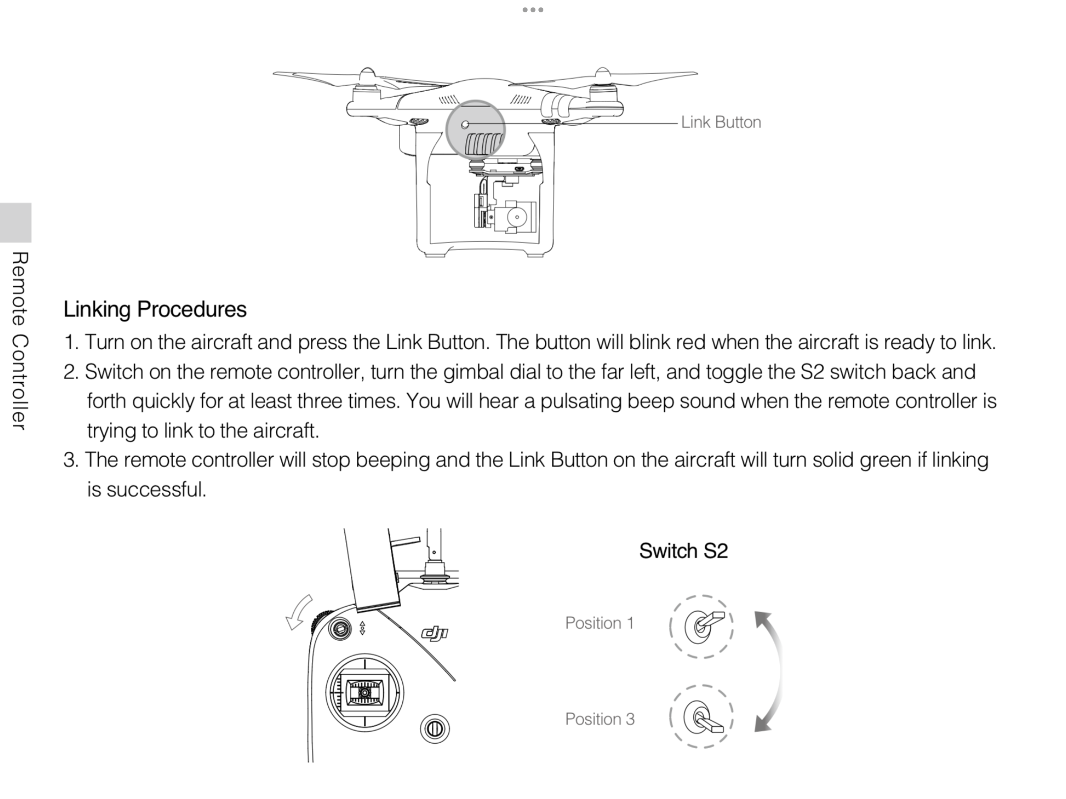

This is the linking procedure for the drone and r/c not using the app. Both the lights on the drone and the r/c will be green when linked.
As mentioned before, do NOT mess with the firmware yet.
