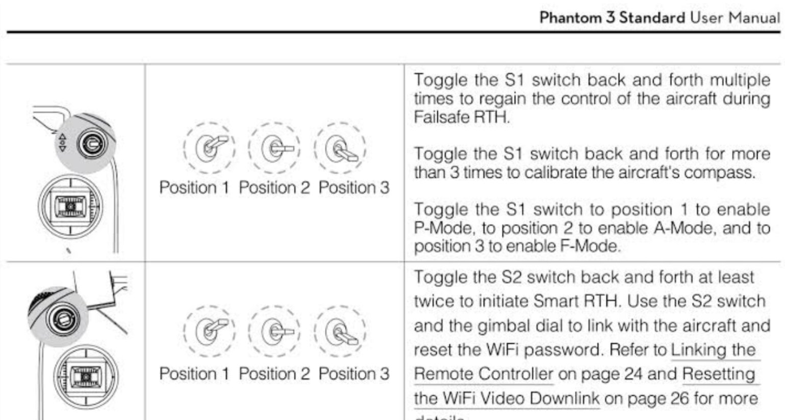

Hi, I own Phantom 3 standard but have not used it for about three years and as a result am having problems with some very basic set up requirements.
Looking at the numerous video's etc.. they refer to a P3S so first basic question is, do I have that model ?. Second basic issue , one set up procedure I read says to press and hold the RTH button, where is the RTH button ? I think it may be either S1 or S2 switch but they are toggle switches not push buttons.
Any help would be very much appreciated Thank you
From the manual..there is a free online manual in pdf form or just to read that's available to download as a refresher on the mind
As a reminder, if you initiate RTH, be sure to have your preferred RTH settings correctly set in the app, such as RTH altitude, and what you want the drone to do once it reaches the home point.....like hover, or auto-land.
As suggested above, review the P3S user manual before your next flight.
If you can't find the answers you're looking for, just post back here, and someone will be glad to help. Good luck...👍
