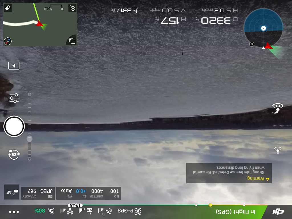

What did I not explain? I mentioned that I got better distance by rotating my phone in the cradle. I gave the distance I was losing my video feed before and after rotating the iPad. I posted a screenshot as proof. The only thing I didn’t mention was that I flew close to the exact route both times.
I posted this tip that worked for me to hopefully help someone else. I never imagined I would get these kind of replies.

Tkogllin, I feel I should apologize for some of the replies you have received. The antenna on your tablet is on the side of the tablet. Rotating the tablet would place the antenna in a position that would increase the theoretical receiving distance. This is because the electronics of the tablet would not be between the antenna and the drone. I would hope that members would not be in such a hurry to criticize members that are trying to help. Thank you for your post. It will help a lot of members who have tablets with side antennas.

It was the wording of the explanation that was the issue. When you mentioned the "home" button, with the screen shot, one would naturally "assume" that the "home" button on the screen is what you were referencing. @Ansia provided a better explanation to your reference.

The antenna on a standard RC is in the center of the RC, not like the other RC's with dual antenna's. Rotating the tablet should have no bearing on reception or transmission in that instance.

Did you also try the same test with airplane mode (wifi and cellular off) on you iPad? If that also gives you this range, I think the answer is wireless intereference.
As this is a P3 Standard, you need WiFi as unlike other Phantom controllers, there isn't a cable between the controller and the viewing device (iPad).
Let me just reiterate something. A P3S uses WiFi from the controller to the iPad. The video signal does not come directly from the P3S to the iPad.
So changing the orientation of the iPad does not directly affect the reviving of the video from the P3S except for perhaps not overwhelming the controllers receiver with the iPad's WiFi signal "noise", thus allowing better reception of the P3S video by the controller. Or possibly the metal in the iPad (due to it's orientation) might be affecting the received signal from the P3.
