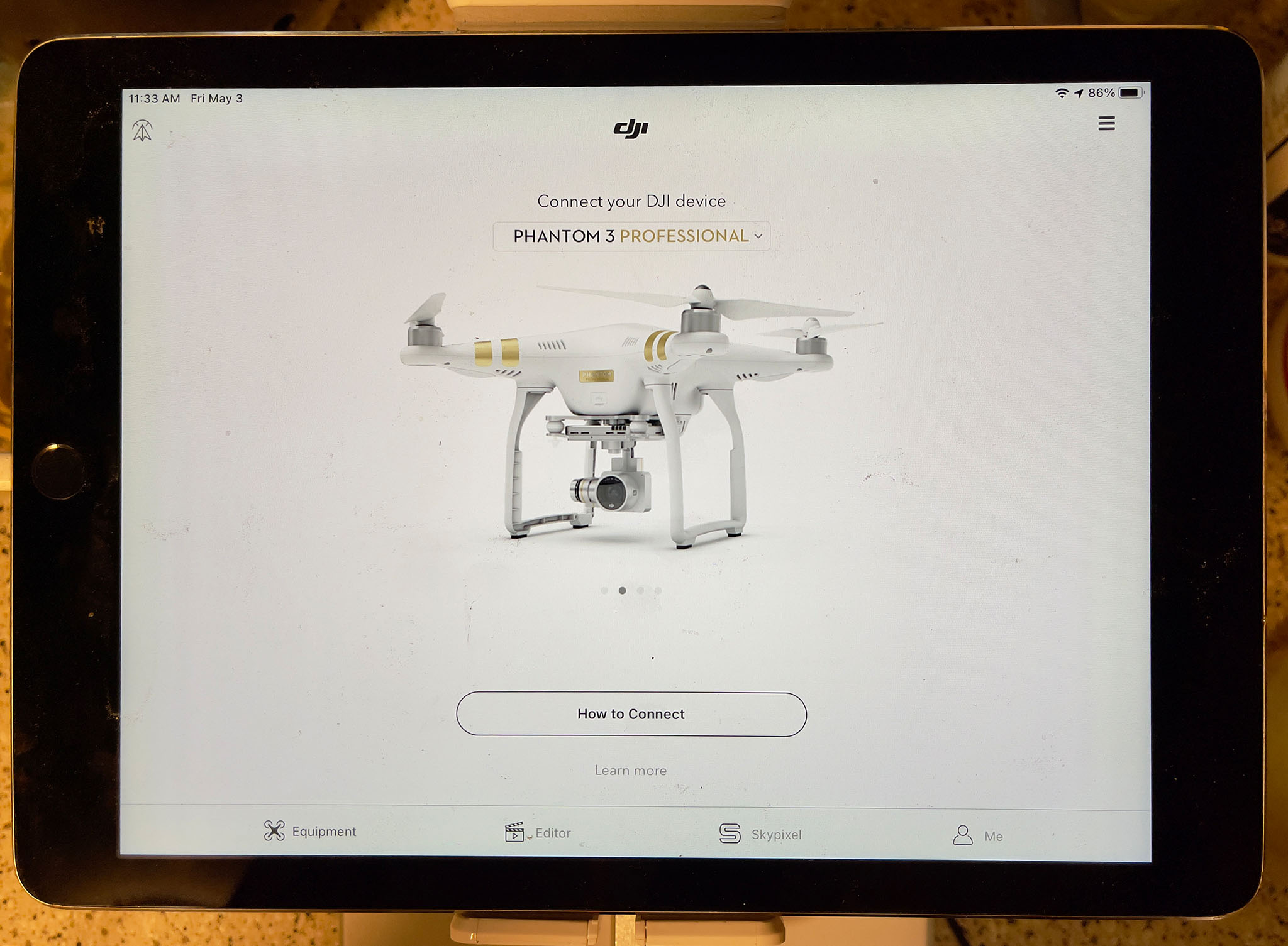

So I have my old P3P that I kept as a backup when I went Mavic Pro.
Now I want to sell the P3P kit, so I pulled it out and charged everything up. This morning, before heading out to test fly it, I decided to just go through the paces here in the kitchen, no props installed. (I'm glad I did because it went through several approval screens and required my home Wifi.)
I simply cannot connect, using the same iPad Air 2 that I did before. After running DJI Go (not Go 4), I got past all of the initial screens (allowing permissions, agreeing to terms, signing in to my DJI account, etc.) and got to the main connect page. It shows the Inspire, so I swipe left until the Phantom 3 page comes up and I select Pro. There is no CAMERA button. There's an Equipment link, which just takes me to this same main page. The only button is "How To Connect" (see screen cap below).
Here's what I've already tried:
  • Made sure I was logged into my DJI account
  • Got the Fly Safe database updated (which also shows the remote can see my wifi).
  • Tried running DJI Go on my smartphone, which DOES go straight to camera, but it keeps crashing. I figure the iPhone 13 is just too new for the old version of DJI Go (so not tested). However, since I can see the camera feed for a moment pre-crash, I take that as a sign that the cable is good.
  • NEW: I just checked the motors and the CSC stick movement from the remote starts them up, shuts them down like normal, without the controller app (DJI Go) running. This confirms that the AC and remote are linked.
What else should I try?
Thanks in advance, Speck

Yes, the P3P AC and remote connect via a USB cable.
For the P3P, I've always had to be signed on to DJI. I believe it's required for flight log sync. Usually, I just do it from home, then it persists for a long time. One time I drive all the way to the desert (from another state) and DJI Go would just not let me fly until I logged in.
Also, if you install DJI Go on a new device, the first time you run it, it's going to ask a lot of permissions for the device (camera, connection, bluetooth, etc.) and several other things (fly safe database, a user-level agreement that you must check), and finally be logged into your DJI account. I guess the install on this tablet had been reset and had to go through the process again.
Perhaps you don't recall having done that when you first set things up. If you've continued to fly since then, it simply persists, remembers its settings.
It's true that the remote and AC should be connected without the controller app. I actually did not try to start the motors up. I suppose I could try that next, but I still won't go out and fly until I got a proper connection in DJI Go. [EDIT: I did try the sticks and it starts/stops the motors just fine, so the AC and remote are linked)
I have LITCHI too, but I would still not fly without a good basic connection to DJI Go.

Hey there,
Indeed, the P3P flies by USB and not WIFI like the standard. But you still need WIFI if you need to talk to the internet for various things (download of fly safe DB, log in to DJI account, authorize approved flights, etc.).
No app compatibility issues: the P3P uses DJI Go (not Go 4). I verified this on the DJI support page for the P3P, I also ensured that DJI Go on both my tablet and phone are up to date (they're still on the App store). Also, when you start DJI Go, you are presented with a home screen that lists the Phantoms, so I know I'm using the correct app. And it's the same app I've always used for the Phantoms, always kept it installed (did not need to download the version I found this morning on the DJI site).
So, as far as I can tell:
  • The AC and remote are linked
  • The remote and AC both work (I can fire up the rotors)
  • The app is the right one
  • The USB cable is good
It's just that the DJI Go app will not connect to the AC (camera mode, telemetry, map, etc.).
It's amazing how much you forget in a few years of disuse. I used to help people with similar problems earlier because I'd worked out all the solutions, but I can't think of any of them now! #frustrating
Speck
