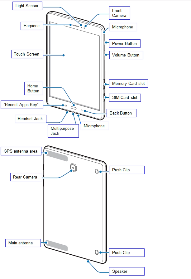

Apparently it is opposite for the Samsung Tab A
