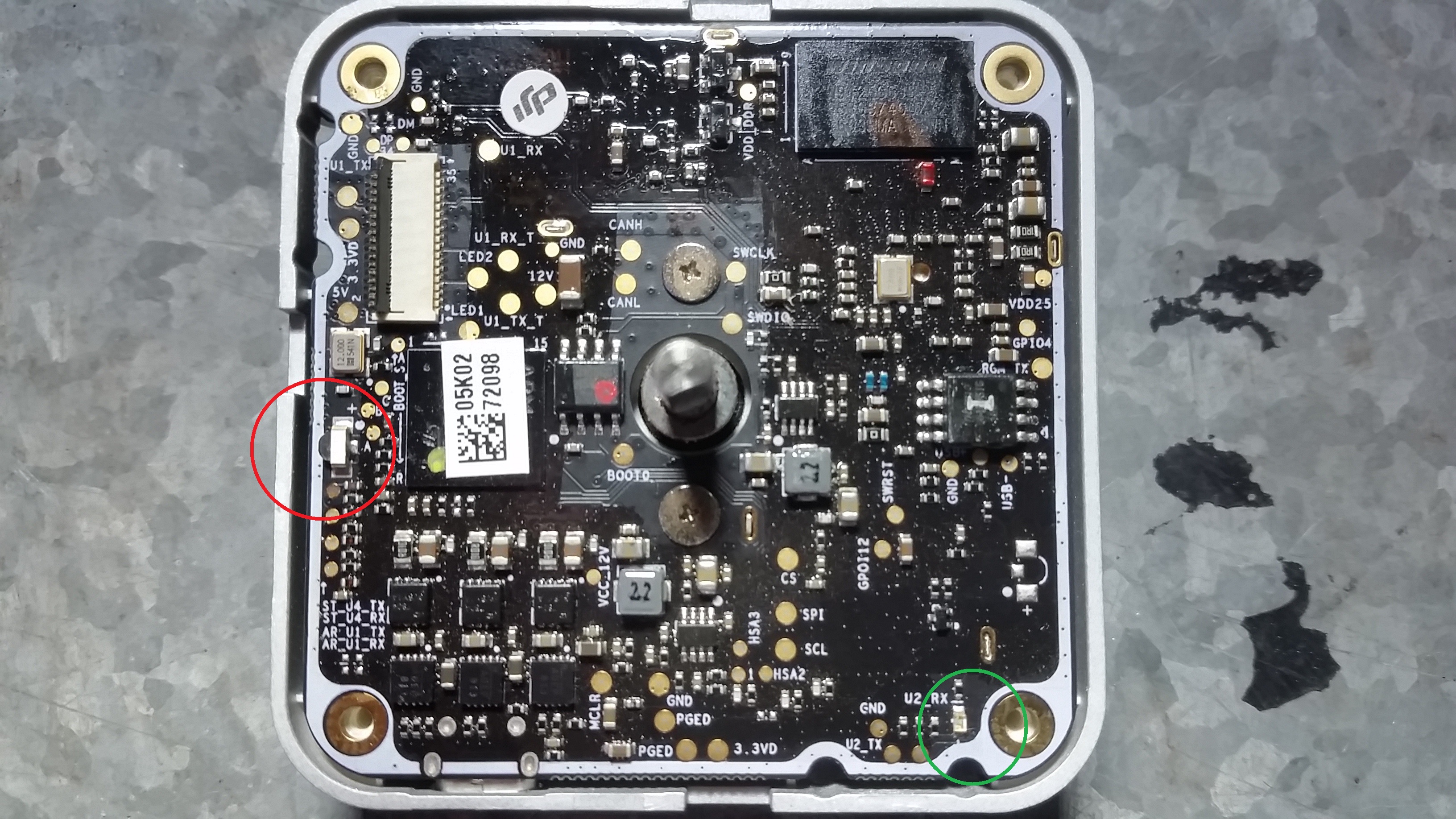

I have taken the cover plate off the gimbal base to reveal the main gimbal PCB. There are two small LEDs. I notice that while the drone is connected the first LED slowly blinks bright green (see green circle below), and just before it disconnects it flashes dim green once, and then the second red (see red circle below) LED flashes bright red (slowly). This connect/disconnect cycly repeats every 5-10 seconds while the drone is on.

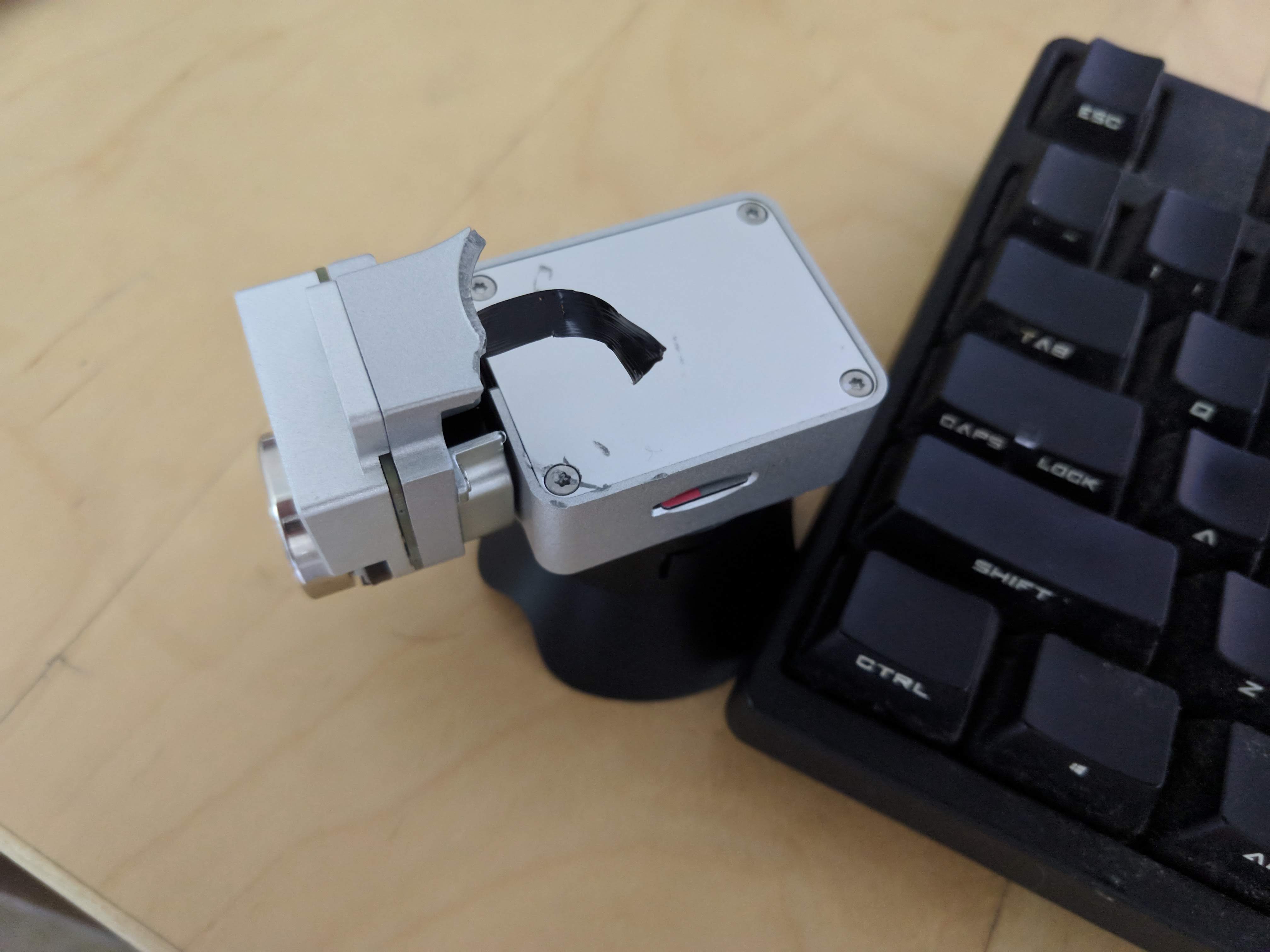

I've got this exact issue after a hard crash which broke my roll arm in half and tore the gimbal flex cable. I see the red LED on the exterior of the board flash red, then the remote loses connection with my P3SE (remote LED changes from green to red and DJI Go says "disconnected"). I'm currently wondering if the disconnect/reconnect issue is caused by my gimbal being partially severed and the main board (the one shown in the original post) being unable to talk to the sub-board on the roll arm. Am I to understand that people don't have the disconnect/reconnect issue while the gimbal flex cable is disconnected?
Noticed something else to add: The gimble board makes a beeping sound which stops when the red light comes on, then restarts after the controller regains a connection. The beeping sound is the same one which occurs prior to the gimble stabilizing prior to flight. No one else mentioned the beeping sound related to this issue, thought I'd share.
I had the same issue with just the gimbal board itself connected to the bird (no flex cable). Connect/Disconnect every few seconds, and the beeps stop briefly when the light turns red.
Replaced the ribbon cable with a genuine DJI one last night, and everything is fully functional again.
Thanks for this info., I crashed my P3 SE and severed the flex cable. The quad then was able to take off, but would then intermittently disconnect from the controller and continue flying autonomously in the direction last commanded before disconnection (scary to say the least!). Reading threads about P3 Standards flying ok without the camera, I thought I may have damaged something internally. Replaced the flex cable and gimbal roll assembly and it now works perfectly!

I have taken the cover plate off the gimbal base to reveal the main gimbal PCB. There are two small LEDs. I notice that while the drone is connected the first LED slowly blinks bright green (see green circle below), and just before it disconnects it flashes dim green once, and then the second red (see red circle below) LED flashes bright red (slowly). This connect/disconnect cycly repeats every 5-10 seconds while the drone is on.View attachment 92386
