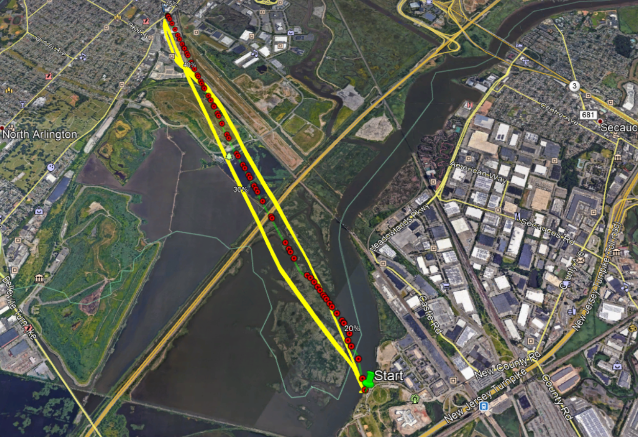

Just for reference, these are close but not exactly a match. This is your RTH device log file with FLY291 overlayed in yellow.

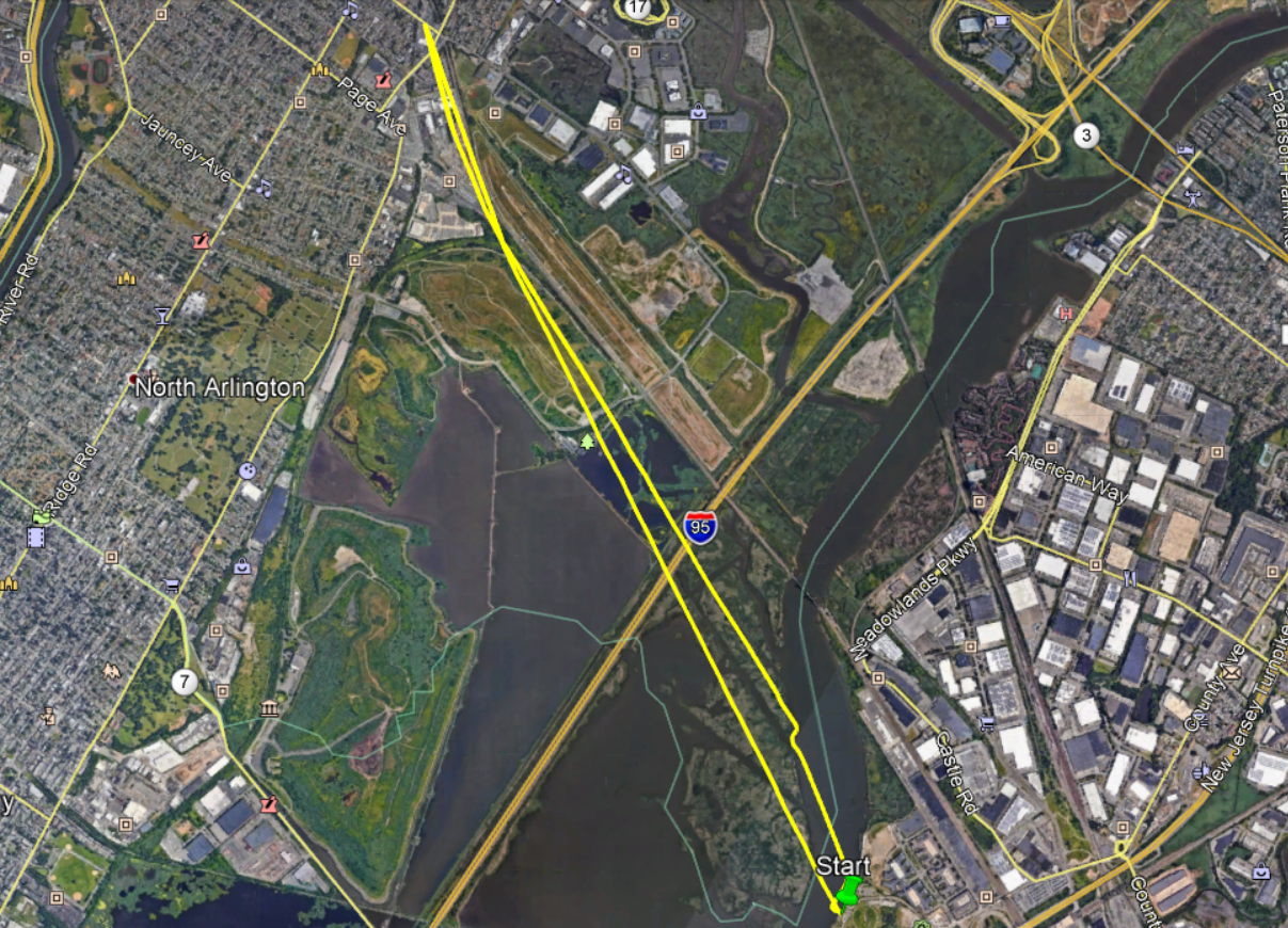

I was able to open your FLY288 directly in CsvView and it appears to be a long out and back flight with a complete log of the flight. Must be a different flight that you are looking for,
Yes it’s a flight right after this one
Looking farther at FLY 288, this is a normal flight. There is no RTH in the logs. Battery was fine and no signal loss. Also, your failsafe for this flight was set to hover, not RTH, just to throw that out.

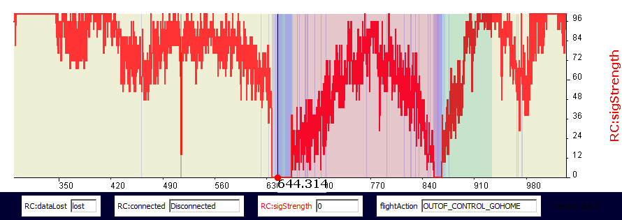

There were two disconnects that occurred beccause the signal strength dropped to 0. When the first disconnect happened at 641 secs the P4P initiated an RTH

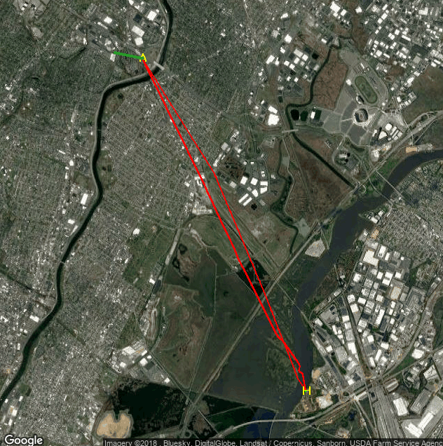

The P4P was here (where the yellow A is)
