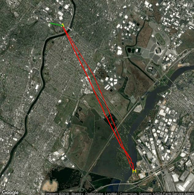

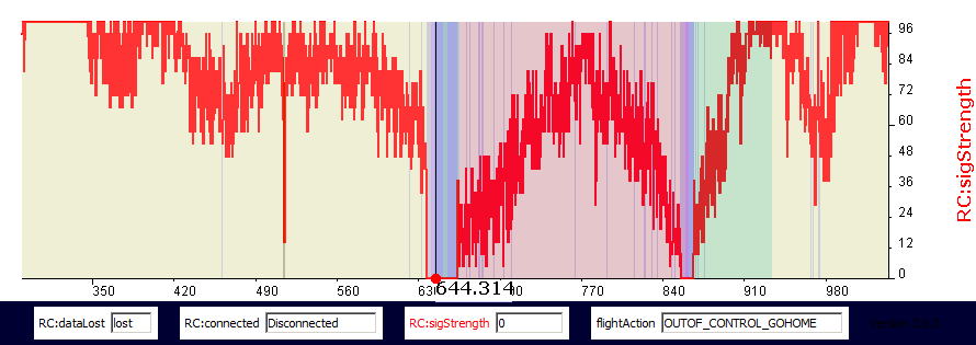

There were two disconnects that occurred beccause the signal strength dropped to 0. When the first disconnect happened at 641 secs the P4P initiated an RTH
The P4P was here (where the yellow A is)

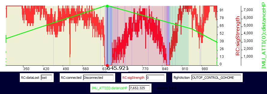

Thank you Sir ,Ill forward a copy of the file to DJI they asked me for it so they can take a look, may I ask the distance when the disconnects happened, I only remember one...
The first disconnect occurred at 645 secs with a distance to the HP of 7,652 meters.
