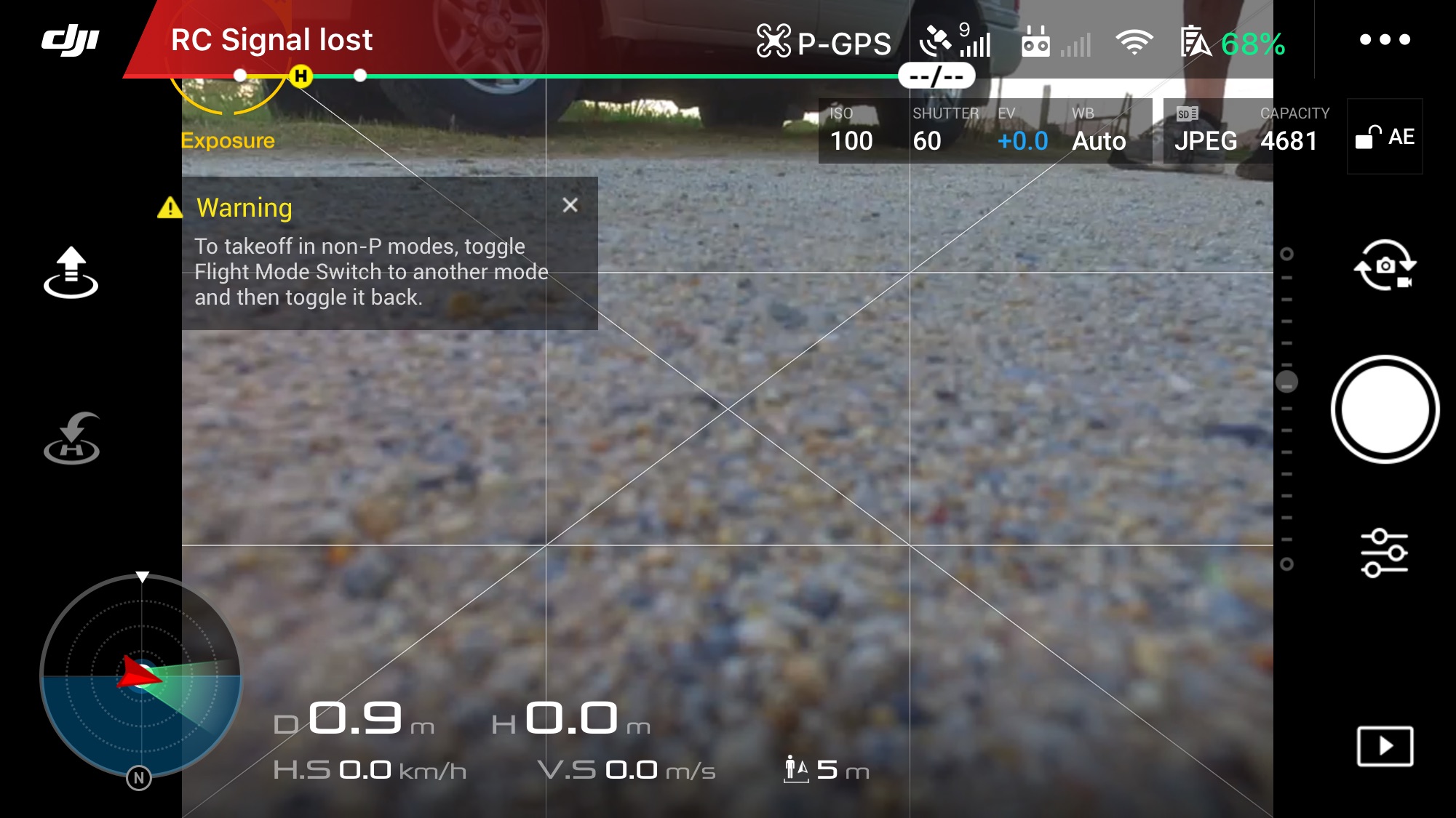

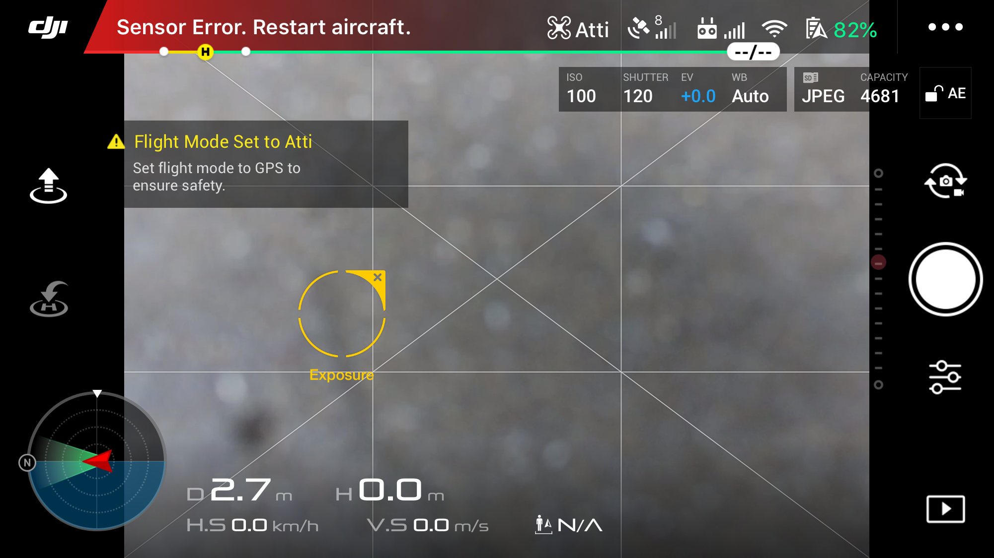

My P3S has recently started to display the lost signal after only a short time after takeoff within a few meters of hight and distance. In every incident the AC RTH safely to the home point, but I couldn’t cancel the RTH due to lost RC signal. I today picked up an additional error message “Sensor Error - Restart Aircraft” Could not restart normally and switched off AC and RC and started again to link and get to GPS takeoff mode. Never took off or flown in ATTI MODE. After scanning as many threads and e-mail as I could find I decided to do the following to try to rectify.
  1. Calibrated IMU successfully
  2. Calibrated compass every time I tried to fly
  3. Re-linked the AC & RC successfully
  4. Always took off in GPS after home point was registered

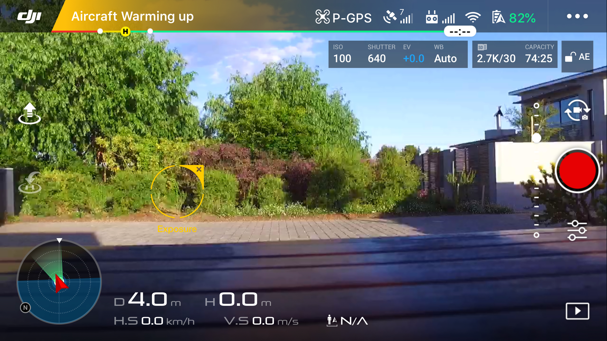

Latest update. Today I upgraded my firmware to latest available for P3S as some of the issues raised were addressed in the later versions of firmware. Took a test flight and after 60 sec it again switched from green GPS mode to red with RC signal lost, RTH and landed safely. After reading suggestions in P4 forum to eliminate causes of “RC signal lost”, I fired up my P3S but flew a short mission in Litchi, without a signal loss after a few minute. Will fly a longer mission on Monday when I can go into countryside. Weird, but it worked! Did my preflight check with DJI GO app and “Aircraft warming up” appeared on screen. Is this normal?

Put the drone in a cold place,like a refrigerator or freezer for 30 minutes. Then do a IMU calibration. That will remedy the aircraft warming up issue.
Thanks for your interest
The warming up AC is normal for 30 secs. The rear LED are blinking up in yellow befor it record the home point too and will change to blinking green to GPS ready to fly.
