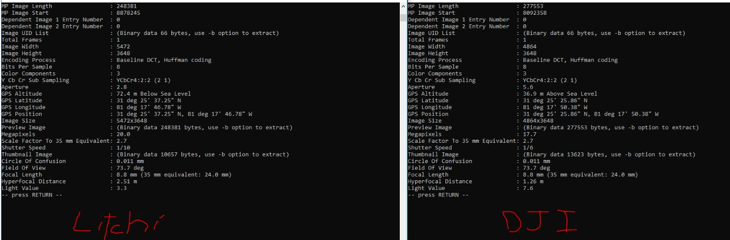

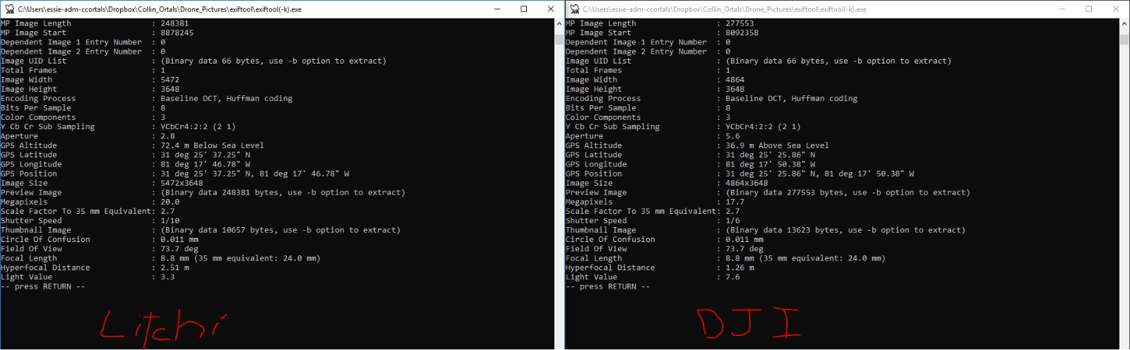

Hi,
I have flown my Phantom 4 pro over a coastal marshy area first with the DJI app and then with the Litchi app. Still pictures taken with the Litchi app are much worst than with the DJI app. I cannot see 1 foot ground control point with the litchi app, while I can see them with DJI. Same elevation, verified by the size of the rectangular field of view on the ground. Not too different atmospheric conditions and lighting. The metadata file is here attached, and the following entries have different value:
Aperture
Shutter speed
Hyperfocal distance
Light value
Also the pixel size is different, but that is normal because the litchi pictures were taken at 3:2 while DJI pictures were taken at 4:3, and 4:3 is just a cropping of the pictures taken by the camera sensor at 3:2. Should I change somehow those values manually in the litchi app in order to match the values in the DJI app? Do you know where I can find these settings?
Aperture, Shutter speed, Hyperfocal distance, Light value

You mention a GCP which suggests mapping, but your shutter speeds are around 1/6 sec so it seems you are almost flying in the dark.
The difference in settings isn't important. WHen the aperture is changed, that changes the hyperfocal distance and a change in shutter speed is needed to maintain exposure.

It might be helpful if you could attach two actual images rather than their exif info.

Hi, I am working with DroneOnCoast on this project. We were flying at 225 feet in both cases (DJI and Litchi). DroneOnCoast will upload pictures, he is coming back from the field soon. I am walking with him on this project. We are taking still pictures of coastal features and we rectify them in ARCGIS by using the GCP. The cropping thing is correct not need to worry about that, I asked DJI, 4:3 pictures are a crop of 3:2 so you have less pixels, you can see that here ( DJI Phantom 4 Pro – Specs, Tutorials & Guides – DJI ) in the specs under "Image Size ". could you articulate a little more on the shutters speed? Both were under partially cloudy days, mild sun, all camera settings were automatic, why do you think the values shutter speed are off, are you saying they are too high as if it was in a darker day? I do not much about camera settings and cameras in general, so any help would be appreciated.
