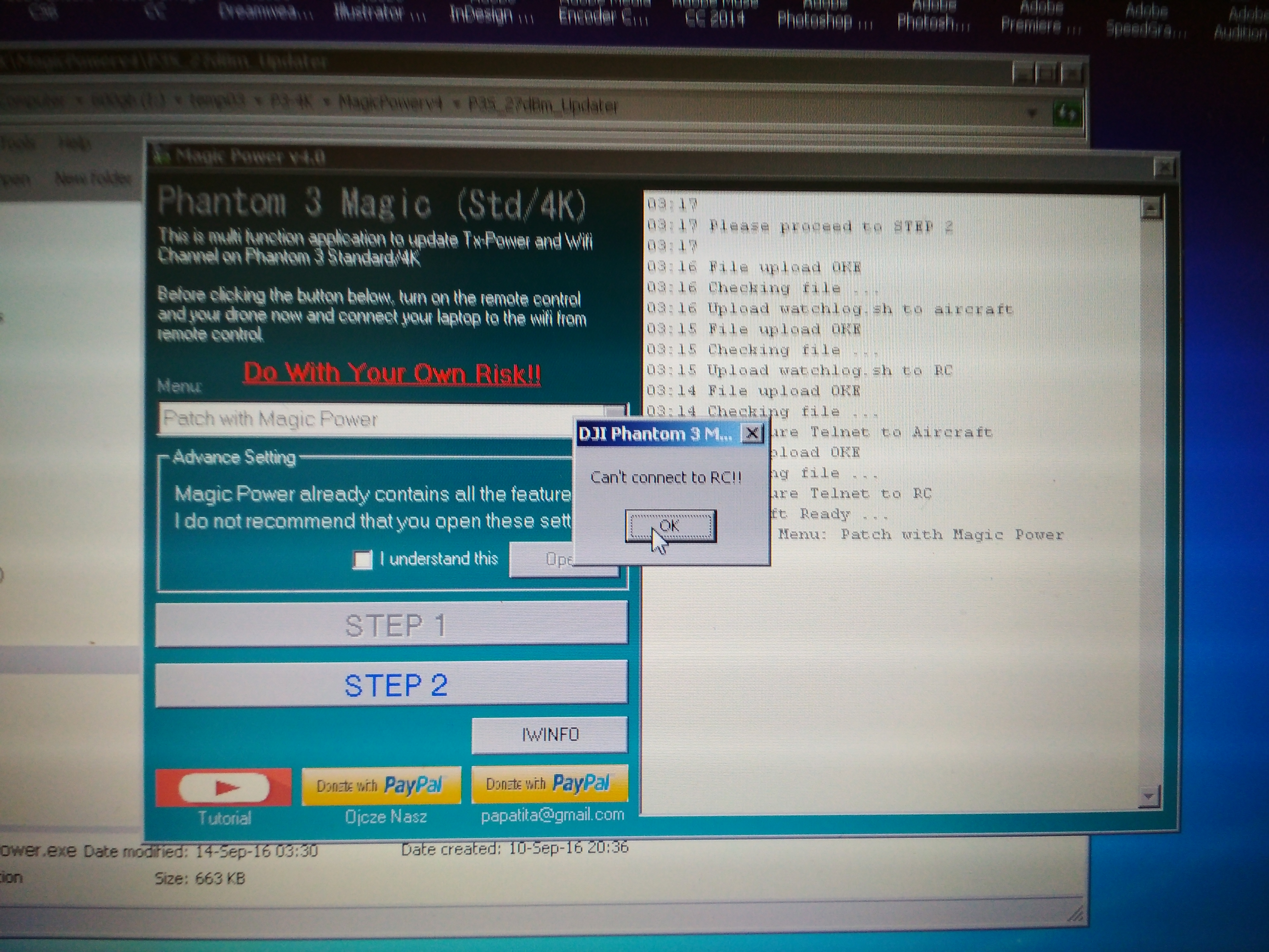

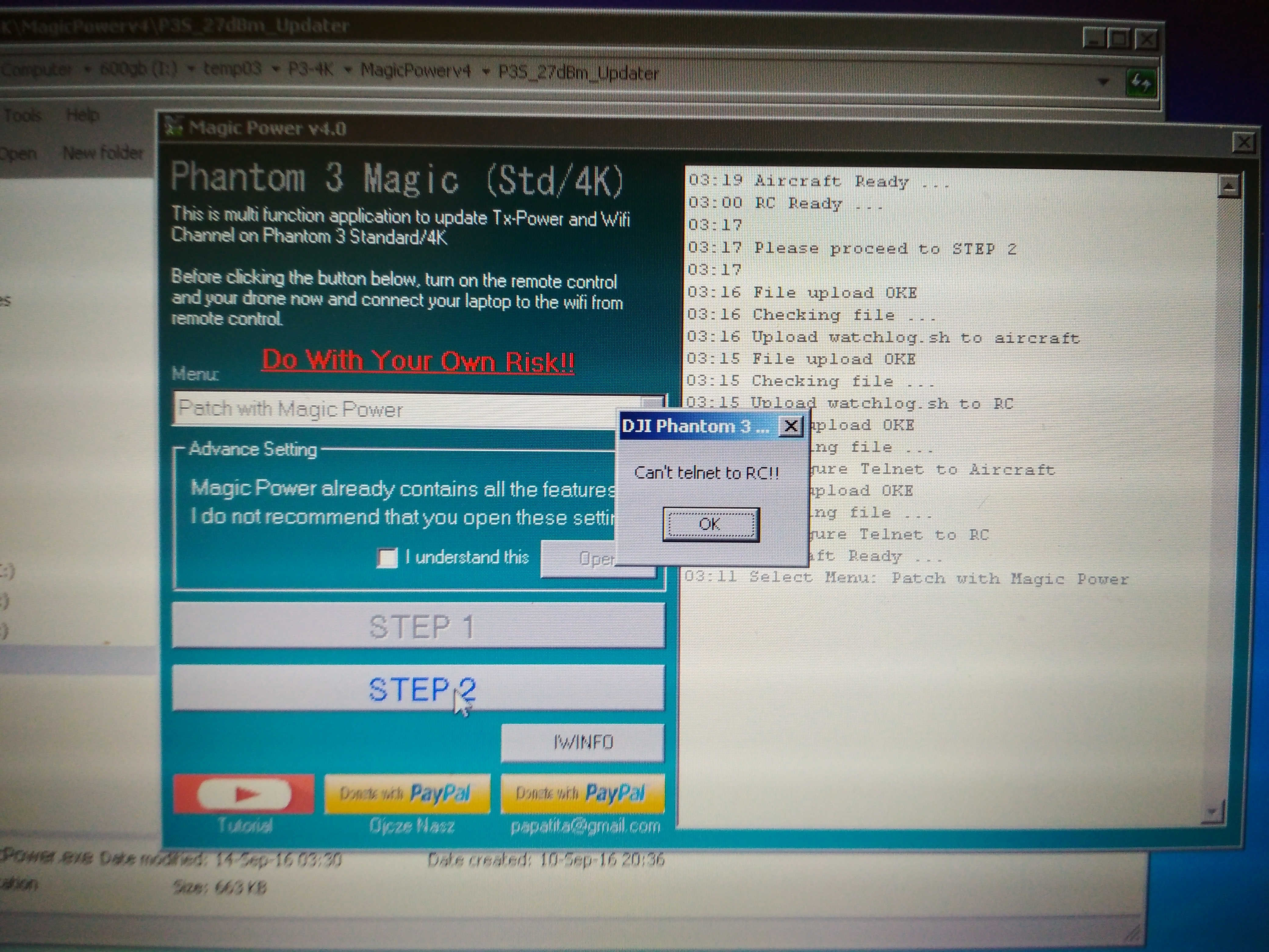

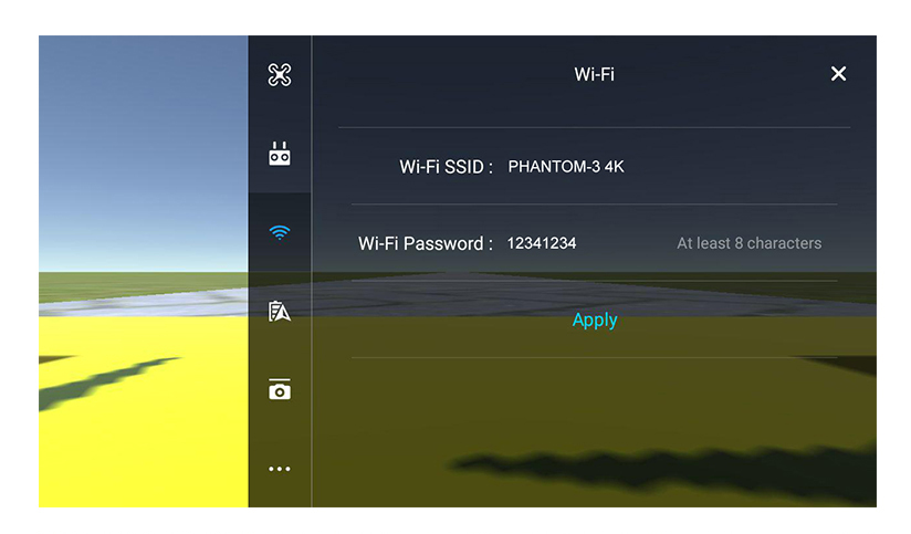

Hi, I'm woman from Bulgaria and I fly with Phantom 3 4K.
1. Is this app just for P3SE?
2. Can it be used at P34k and P3S?
3. On both models, the video is only 2.4 Ghz and the channels are not shown (see pictures).
4. Should the drones be old firmware?
5. Can this mod app be synchronized with the AIRDATA as I need it?
6. With Magic Power 4.0 things did not happen to me. In 2 steps I first wrote " Can't connect to RC!!" I pressed the button and the step 2 "Can't telnet to RC!!"
Thank you, Regards Tsvetty.

Yes, of course I do it on the videos of PapaTita but in the 2 step with Magic Power it gives me that the remote is not connected with the drone, but everything is green. Daungrade 2 versions of the firmware back, just the message comes out - first one (see pictures) after the first step has finished completely and I have restarted the devices. Perhaps you need to distribute the RC. separately.
I do not know anymore, yesterday I tried all the methods described to go to the FCC and all were unsuccessful. With Fake GPS, with the modded application for DJI go for P3SE - just nothing worked.
I'll think you have more luck getting help if you ask in the right forum section. :)
