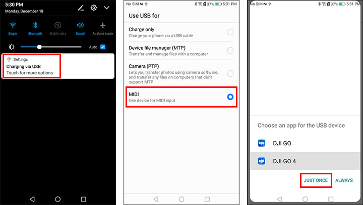

When I connect to my Galaxy S8+ it pops up and tells me that I'm slow charging, there are no options to change the USB connection type though like there would be if I connected to a PC for example; I did set to MTP and MIDI in the Developer Settings just to see if it made a difference, nope.
Did you try swiping down from the top of the screen? When doing that, you should see this USB setting:
