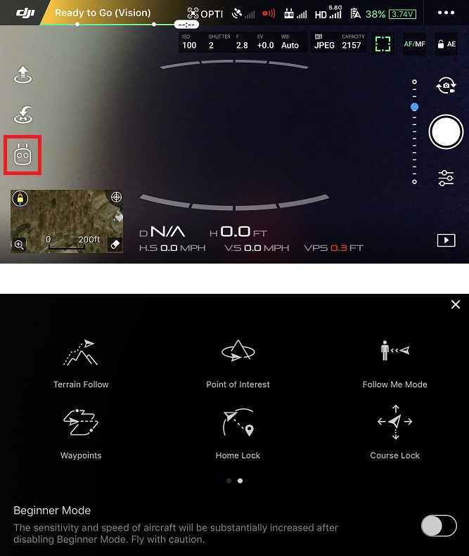

I'm trying to set up a POI flight, and am set up for "Enable Multi Mode".
I'm following a video tutorial from a couple years ago, and am finding that switch to "F" mode is not triggering the menus to pop up and prompt me through.
Did DJI change the process .... or worse, did they eliminate this function?

We finally got some favorable weather, so I thought I'd try a POI shoot. I got my engines started, took off to a height of 12 meters overhead. I set my RC, and I did get the screens you showed here.
I selected POI, and thought it would step me through the setup.
But I kept getting an alert saying something about the rotation/orbit range being 5-500 meters, and I could not figure out how to set the circle to the 10 meters I wanted.
I definitely missed something.
Please help if you can!
Thanks!
simply pull right stick back , moves your phantom back from the center point of the POI , increasing radius , numbers will go from red to blue , I think 5m is the smallest allowed by the app , orbit rotation will show as a slider , always starts to the right , sliding right increases orbit speed , slide to left slows and changes to left direction , then increases speed to the left , DO NOT MOVE SLIDER RAPIDLY FROM RIGHT TO LEFT , causes problems
