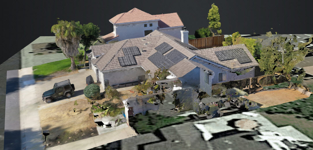

The attachment is a flat export image and not the actual model, but it was shot with POI and a few manual shots from lower, then trimmed to include only obstructions for solar panels. Turned out you can get a better model and still get the solar info with Google Earth if you trim out the other buildings.
I use Scanifly for manual/POI imaging. Unfortunately, they do not allow sharing of the model; I have to provide customers with DXF files if they want to use it outside the cloud software. They're working on a sharing feature, though.
