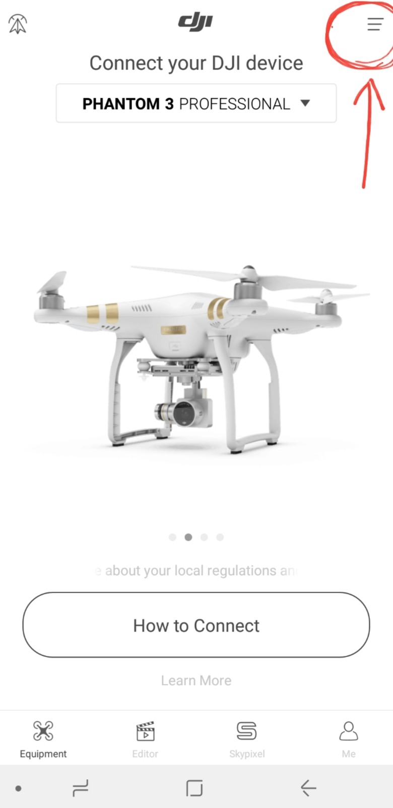

Ok it sounds linked if green on rc and ac,,if you can control drone it is linked but not talking to app,,,,check USB configuration on device,,,,,also to check firmware it might show with press and hold 3 black lines top right

Ha show it one of these it might suddenly wake up lol,na serious those 3 lines top right to check firmware does it show a roll back version,if was ok before firmware update we need to rewind somehow,sometimes there a option here,I dont have pro so cant check,,,was the update fast or take ages,,I just ask incase something in cam got hot during this time
Ha show it one of these it might suddenly wake up lol,na serious those 3 lines top right to check firmware does it show a roll back version,if was ok before firmware update we need to rewind somehow,sometimes there a option here,I dont have pro so cant check,,,was the update fast or take ages,,I just ask incase something in cam got hot during this timeView attachment 121135
Haha thats what i feel like doing haha yep ive looked into can i revers the updated apparabtly not on this version, im not sure how long the update took as its not my drone ill ask now though
