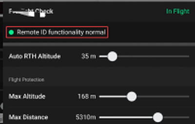

This is the screen that DJI said was in DJI Go 4 and that would show me if the RID was working. They provided this screenshot; I wasn't able to find this screen in the Android version of Go 4 - does anyone know where it is located? I was told that it was accessible from the splash screen of the app (the screen that displays the photo of a Phantom 4) but I couldn't find it. (It looks like the partially obscured text at top left says "Preflight Check", if that helps.)
Just looked pretty hard - didn't see anything like that.

After going in detail through DJI's help documentation at User Guide for FAA Remote ID Compliance, I think that the screenshot she showed me was actually from DJI Fly, not DJI Go 4. It also looks like most of what she told me during the chat session was cut and pasted directly from this support doc, which doesn't fill me with confidence that she actually knew what she was talking about. Very frustrating.
