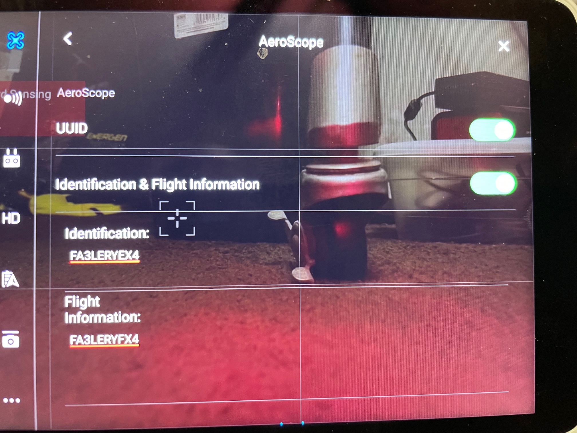

Thats what I think you are supposed to do. I'm guessing the Identification field is for your FAA number. How else would anyone monitoring know what your FAA license number is? The drone does not know. I suppose it would broadcast the rest of the info. automatically. Serial number, location, take off point, etc. I just can't find any app that can receive this info which makes me question whether its working or not.

Still stuck on what the ID should be though. Tried the FAA id - says invalid. Says check with manufacturer for ID?
There seems to be a fundamental problem with saving the RID in Go. Has anyone been able to do it? The correct ID is 20 digits per DJI, but the field "Identification" says it is limited to 10 characters. I've put in a request to DJI to explain. But when I put the correct ID in Go says "apply failed"

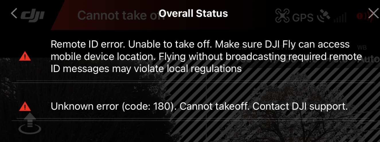

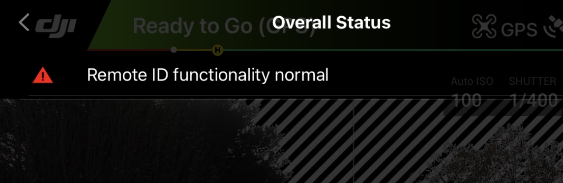

Before I let the aircraft warm up!
After it sat awhile
Not sure why the red triangle when normal

I tried. Updated app. Updated firmware. Inputted a number in Aeroscope. Put 10 digit number in Drone Zone, invalid #. Put a 20 digit number in Drone Zone, invalid #. Connected drone to DJI assistant, no remote ID listed. Used Drone Scanner, no RID. Downloaded Drones Flying Near Me, no RID. Did a search for "proper numbering sequence for drone remote id", propeller says it's the same as the aircraft serial number, invalid #. Anyone have an idea how to be a good boy?

I've got a request in to DJI Support, since the person chatting with me on support couldn't answer why the real ID is supposed to be 20 digits, but the Go app only accepts 10.

The RID on my other drone is 20 digits so I assume there is some format that makes the FAA happy. I was able to put 20 numbers in the Go app. DJI has always, IMO, sucked at documentation. The FAA is the the FAA.
