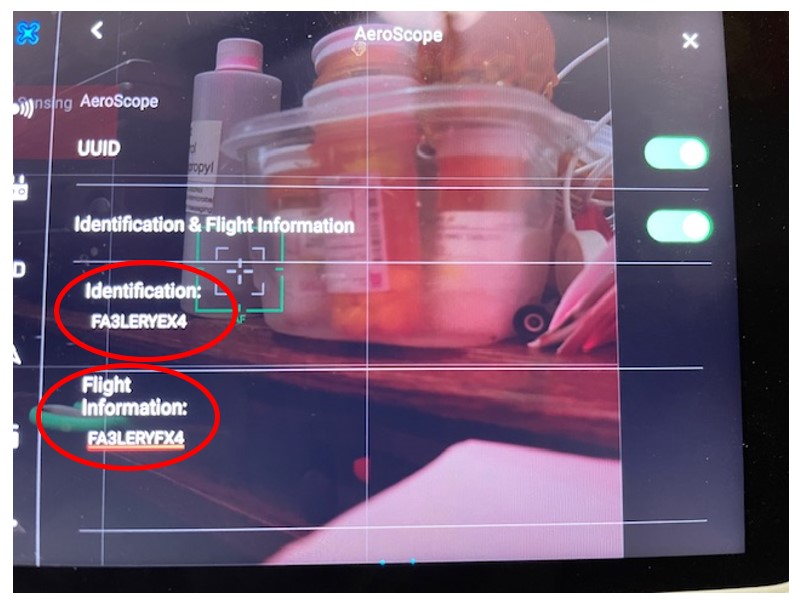

Let me go back and start with the settings. I entered the FAA number of the drone in the circled areas but I'm guessing that is wrong?

SO, I have tried multiple times scanning for a wifi signal with the motors running and have not seen any wifi network that starts with RID. BUT - I have not tried re-registering the drone entirely with the FAA; I just modified my existing registration to add the RID number. I guess I will try a complete fresh registration and see if that makes any difference. As has been discussed, it doesn't seem to make sense that the FAA registration would cause the RID signal to be transmitted or not - but I'm willing to try anything at this point.
EDIT - just to clarify, I never did re-register the drone, but I was eventually able to get a successful RID test anyway (see my post further down). So it's apparently not necessary to actually re-register the drone, you can just add the RID number to an existing registration.

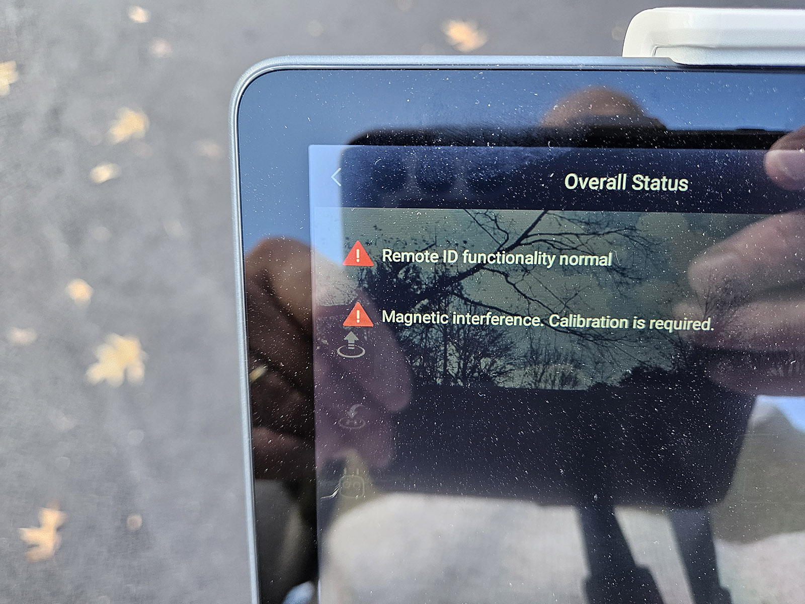

I've been (maybe stupidly) doing my testing up to now inside my house, with the props off the drone, just firing up the motors when needed. Today I took the drone outside to make some actual test flights. Turns out that makes a big difference.
First thing I saw in Go 4 was an alert under overall status - when I clicked, it turned out to be a standard compass calibration alert, BUT there was also an additional alert of "Remote ID functionality normal". This is the first time I've ever seen any reference to Remote ID in Go 4. (Note - later after calibrating the compass, I tried to go back and view remote ID status, and couldn't find it - I was only able to see this message when I happened to have an alert about something else, in this case compass calibration, that I could click on to view details.)

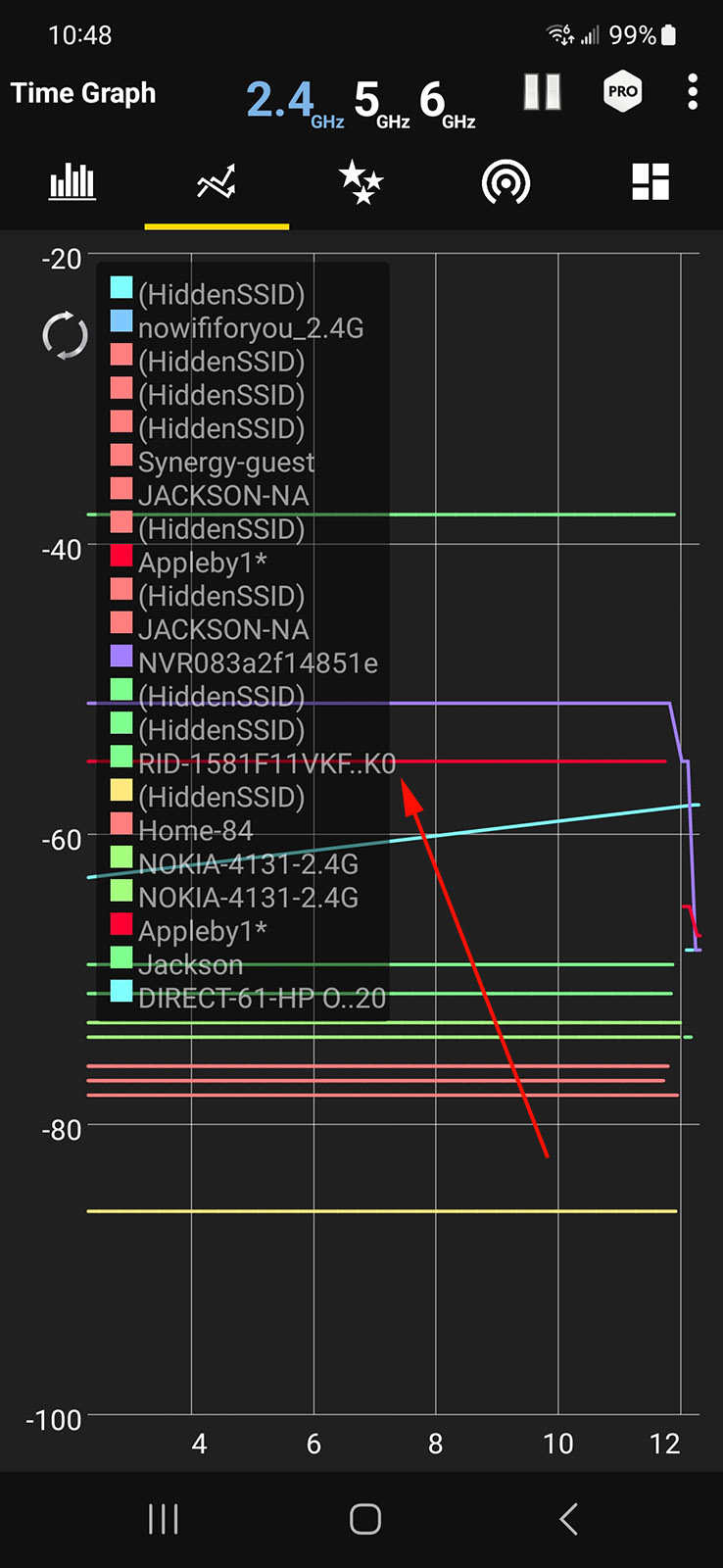

Then I tried a short flight, and checked Wifi in the settings on my Android phone, and also using the Wifi Analyzer app. No sign of an RID network. After a couple of minutes, I landed the drone, then took off again and re-checked for Wifi. This time after a few seconds Wifi Analyzer showed an RID signal (indicated by the arrow in the screenshot below). Wifi Analyzer doesn't display the entire RID number, but checking it later against my RID it's pretty clear that this is indeed the RID being transmitted by my drone.

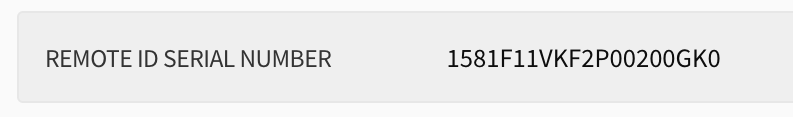

Here's the full RID from my FAA dronezone registration - compare the number to the one after the "RID-" prefix in the screenshot above:
So upshot of all this - I can confirm that YES, IT WORKS. (sigh of relief)
