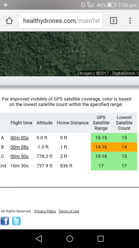

I’m also attaching a pic that may or may not be useful. A day or two after losing my P4, I connected my RC to my phone; no camera view of course, but I clicked on lower-left box (map), then clicked dot and selected aircraft location, not expecting it to show anything. HOWEVER, it showed its location as being a mile or so from me – at a location I’ve never flown over. After looking at the map of my flight, its trajectory would’ve put the aircraft around this spot. In the attached pic, the yellow arrow on the right points to the last known location of aircraft (seen on healthydrones.com); the red dot on the left is what djigo was showing as aircraft’s location a day or two after losing P4. Useful info, or just a coincidence it showed the disconnected aircraft’s location at a location I’ve never been or flown over?

Problem I see is that at 16m 04s mode was changed to sport at 736.5ft and after that at 16m 22s it lost contact at 736.2ft and never did come out of sports mode.
Now could be a chance the wind carried it off as I believe sports mode is also known as ATTI mode. But wait until a few others chip in as they will be a lot better then me on this

Because RTH failed, I figure that's when rc also disconnected - unless that failed because of being in gps dead zone thus not knowing which way home was - but the sound became fainter while I was waiting on RTH & continued getting fainter as I eased right stick forward, then nothing when I tried "making noise" with full throttle. When I stopped touching sticks and went running after it, the sound outran me
Are you sure it's registered as landed? It shows last known location "at log time of 16m 30s
and altitude of 737.9 f"
OK so despite the battery voltage being quite low it wasn't dangerous as the cells was all good.
I notices that it also is registered as landed so that's a very good sign. It also landed with quite a lot of satellites. View attachment 74935
Neon Euc
Actually this is conflicting. I was always led to believe that it will register as landed, if signal is lost then it will remain unknown
but the other report just says "end"
Makes me wonder how it could have registered as landed at 21% as that does need to be triggered when the props stop
