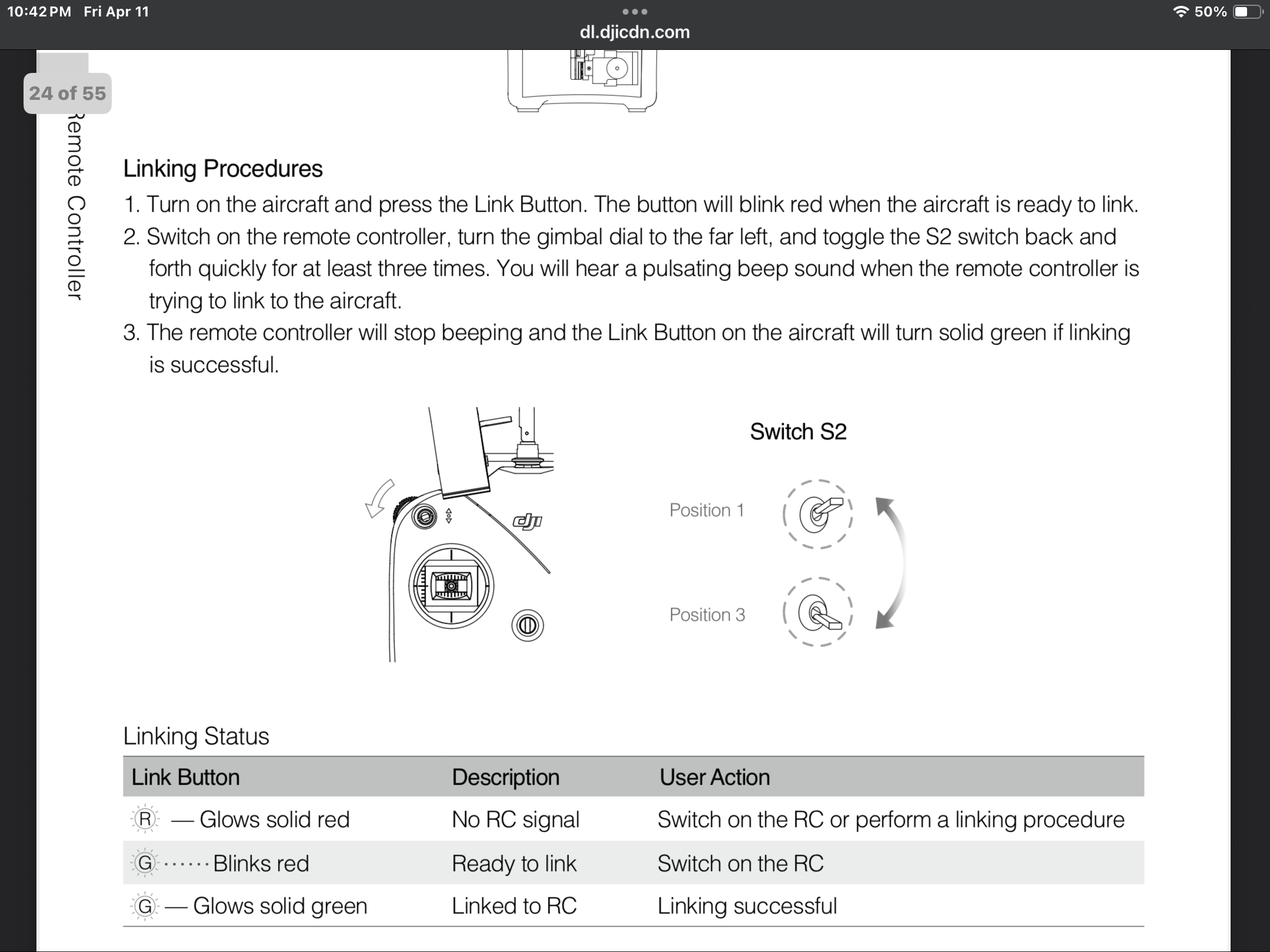

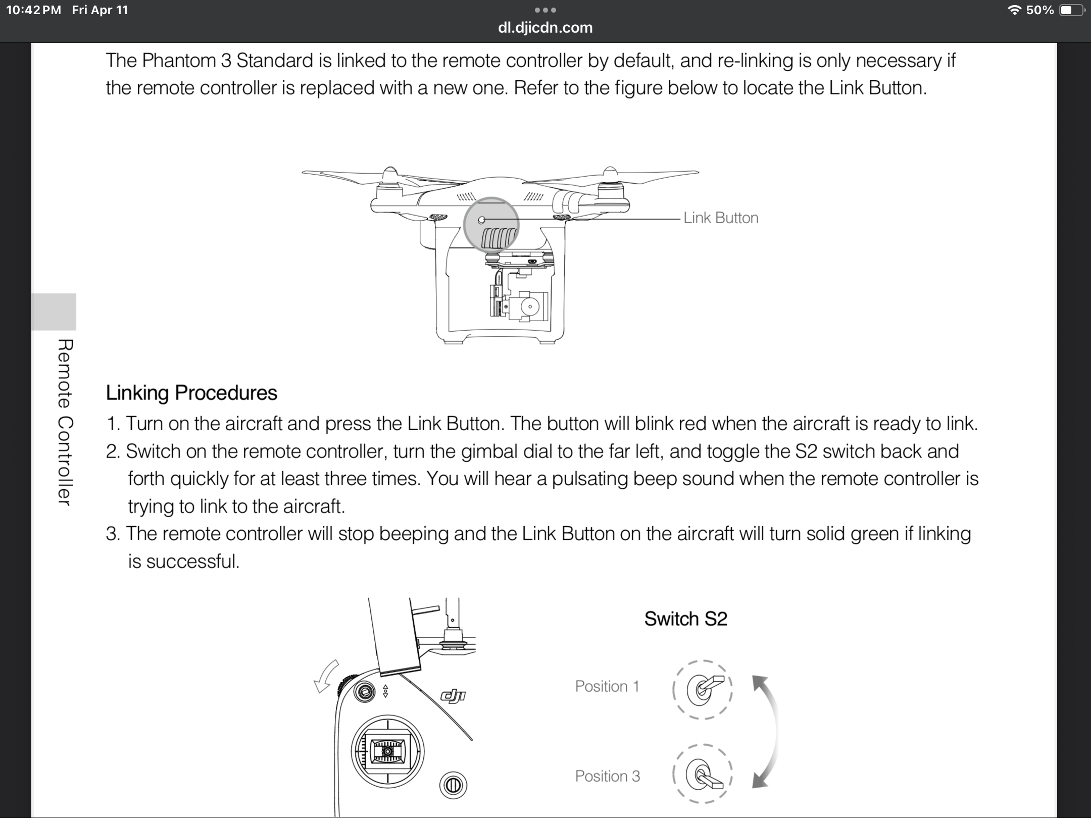

Check out msingers' site 'Phantomhelp.com' for everything Phantom. Just be sure to select the correct drone model from the drop-down menu. From there, you can reference and download the Phantom 3 Standard Manual.
The linking procedure below is from the manual:
I'm tagging along to seek answers also because a year ago I bought a Phantom 3 Standard, and haven't yet been able to link it with its own controller, or indeed with any other controller, since I do have a few spare P3S controllers lying about
