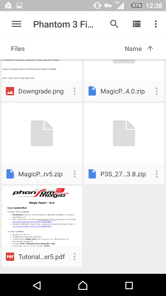

Yes indeed, at the beginning of step 1 there is a checking if need to step 2 or not (Magic Power v4.x)
Hi, great Pata Tita, two questions,
1.) Magic V5.1 is improving the range compared to previous V5.0 ?
2-) for the ones that have already Magic v5.0 , do we need to Revert back to stock conditions before applying the new Magic v5.1 ?
Thanks !
