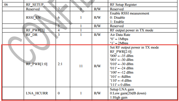

Have been in pursuit of 5.8Ghz boosting. Having no opportunity to touch my P3S recently, so I have searched for documents.
This is what I found so far.
From Ocjze's comment that 5.8g board uses BK5811, I looked for its datasheet for chip setup. Alas, there was RF power setup in that document.

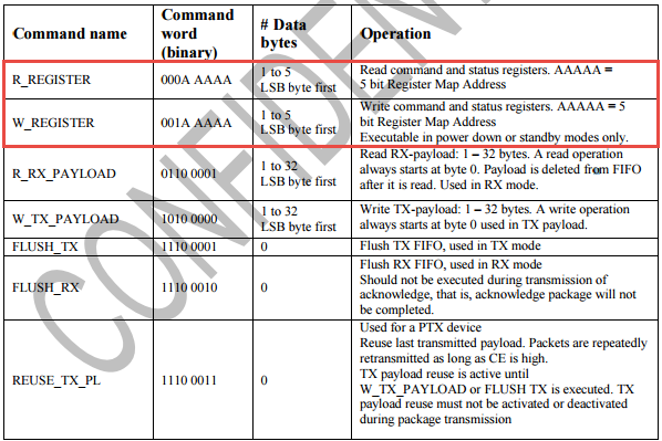

Giving CE pin output 0, BK5811 enters into standby state. In this state, we can give it SPI command. That RF_SETUP register address is 06, so we can write that register with some values.
with this command
With SPI protocol, we send 2 byte to BK5811, which is 1 byte W_REGISTER command with register address 06 (replace with AAAAA), and next is the data value 1 byte. The value can be guessed by above chart.

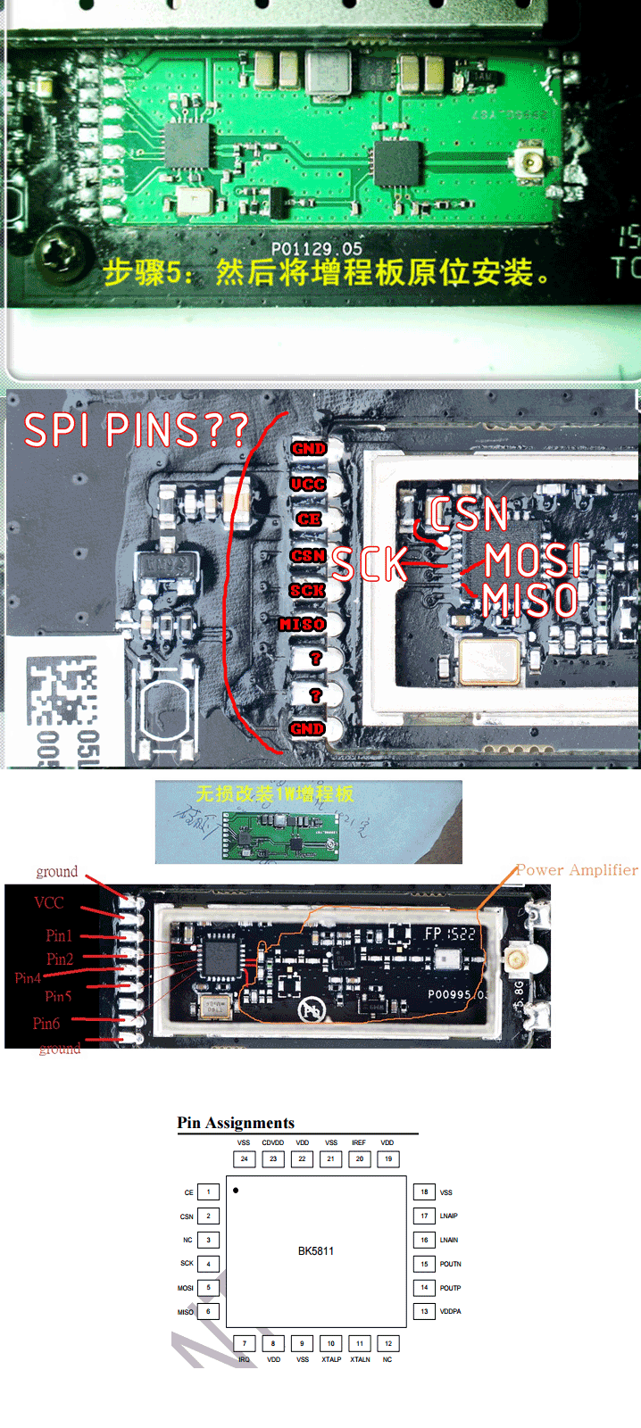

All SPI pins are out for use. I did some puzzling with above pictures. I marked red chars to highlight the purpose of each pins.
One last question. Of which way we can initialize and command that BK5811.
Easy method and currently long shot : 2.4G Atheros module is equipped with SPI interface with GPIO. Somehow if it is connected to 5.8G pins, we can give some commands to setup and boost 5.8g module, on the telnet console. Load spi kernel module, /dev/spi1.0 pops up, and echo "command" > /dev/spi1.0 could be the key commands. Disabling CE pins is another problem.
Another way : RC controller is only way to give command to BK5811. If it is only way to do the mod, I have to know about the RC controller specifics, including model number. I have no idea in this way for now.
Don't have all the clue but felt there's hope for the boosting.
