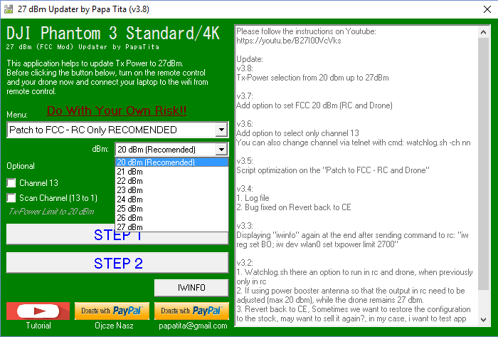

hi, thank you, but how can i change dbm via telnet?
DJIUpdate versi 3.8:
- Tx-Power selection from 20 dBm up to 27 dBm
** This may be the last update.
i personally wouldnt have needed that dropdown menu because its easy to change the values on pc by editing watchlog, and i use different values vor rc and drone (24 and 23 at the time) but your new menu is for sure really helpful for people with stock antennas, and boosters etc!
this 2.4 ghz mod appears quite finished, seems to work great in most cases, if you accept the possibility of strange behaviour from time to time (which cant happen also without any mod), and seems quite safe for the hardware if you dont use too much dbm. will report outcome everey few months. thanks to all, esp. ojczenasz, whatever hes doing now..

how did you apply the mod? ftp program and modifiying files yourself,
or using papatitas tool? if with the tool, use it to revert to ce,
if you modified files, what did you do exactly?
normally it should be enough to replace djiled , rcs with unmodified ones

the internal 2.4 ghz patch antennas on the remote are quite good,
if you dont hold your fingers in front of them (there are little texts on the remote wich mark the antenna position)
you could use scan channel or if that doesnt work,
the app "wifi analyzer" to see which channels are free at the moment,
then set channel manually via telnet app, connect to the remote 192.168.1.1
and type "watchlog.sh -ch 3" (without exclamation marks) (for channel 3 etc)
that function requires a relatively new version of the patchtool.
btw it seems a good idea to reduce dbm, at least in the copter, to less than 27
because of possible overload damage

Hi, I'm using PapaTita's software. Never try to use manual way.

Copter is orignial, only RC is upgraded to 20dbm
