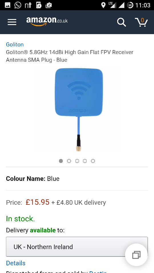

Hi did the upgrade and getting around 1200 metres before loose r.c I bought a patch antenna and only getting 500metres with it, are these not suitable or maybe its a dodgy.
Any insight is much appreciated!!

this antenna should work, no offense but did you mount it so that the front where the most rf is emitted, is pointing away from you to the aircraft?
the antenna has a quite high gain, so in greater distances it is required to point quite exactly directly to the aircraft (with the flat front of the antenna, like it would be a parabolic mirror ( of course it isnt))
you might check if the pigtail u.fl plug is placed correctly, the sma is screwed properly, the cable itself is not defective (short, broken etc)
i use this one for 5,8 ghz: 5.8 Ghz patch antenna - FPV flying maximum range without booster was (with modded 2,4 ghz antennas) up to 2,4km (beforce, with stock, it was 500m)
Looking for a good one myself - and I remember researching that one...
That exact panel gets a poor review here ->
Reviewer getting same results as you - he takes it apart - says it cannot work as its not laid out internally correctly.
That's good to know, I'll send it back.
Which antenna are ya thinking of getting?
