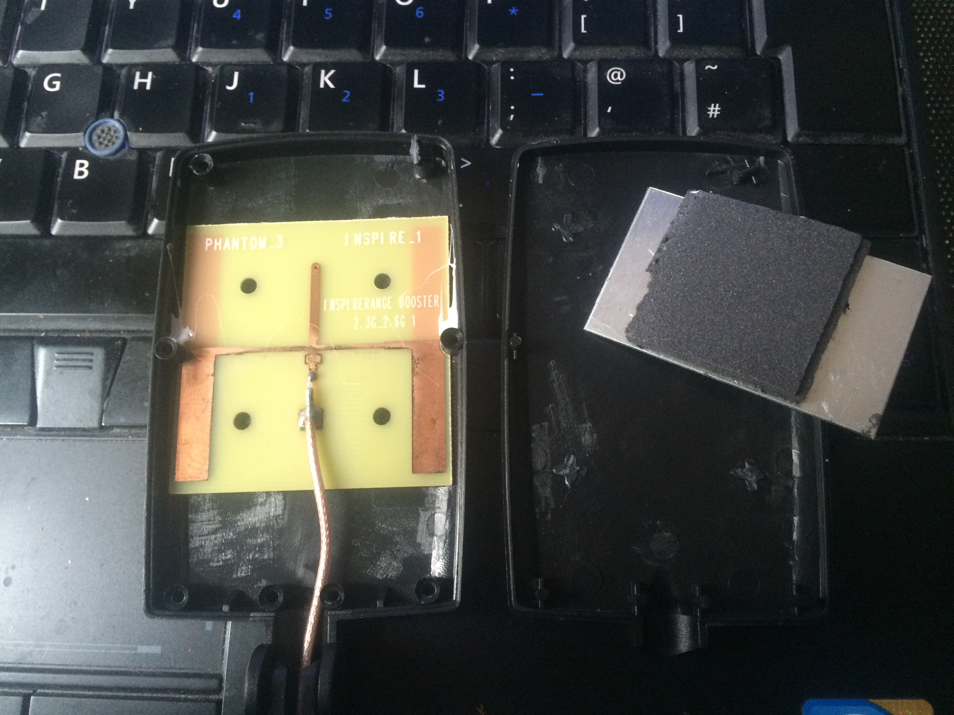

In fact I also put back original 2.4Ghz antennas. They are actually very good.
This is what I found inside the "pseudo argtek" antenna I bought cheap from china.
This is pure crap, and I'm going to paint it green and throw it into bushes so nobody will ever see it again.
Original antennas are 100 times better. The're now back in my remote and I'm very happy with them.

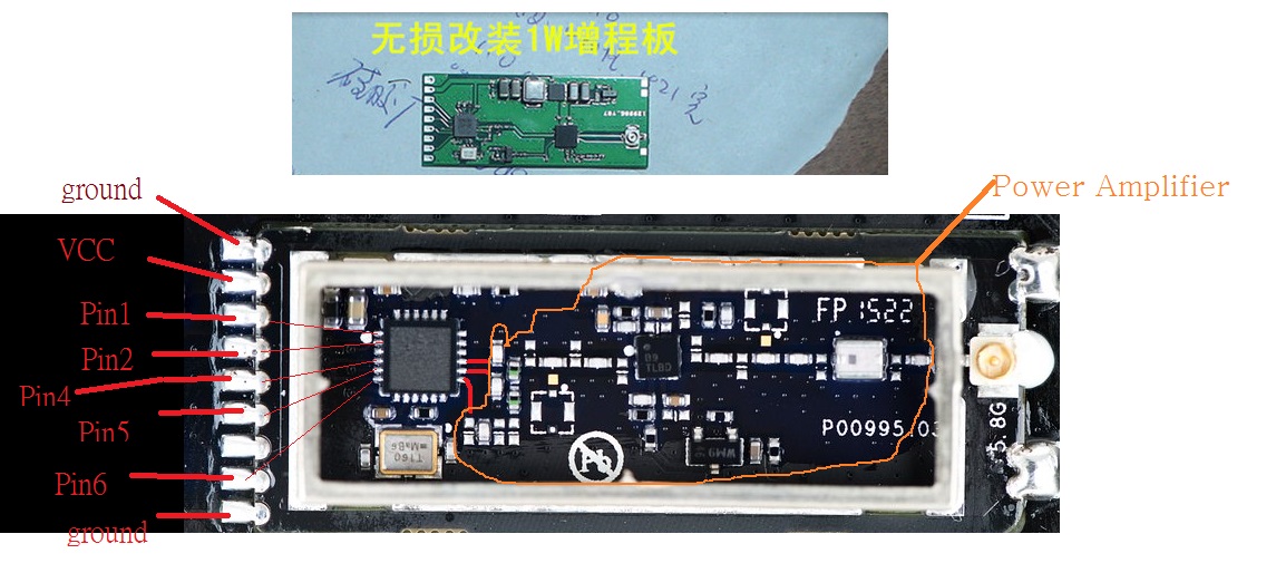

There are (were) also 1W replacement board. Or rather simplified version of 5.8 board which outputs constant 1W
My friend SingLag sent me this couple weeks ago.
I was not able to locate one on the net however. Anyone can read Chinese ?

These are my findings so far.
I measured 0.4V at what I think is the Pdet. It would translate nicely to 14dBm according to some other similar chip specs.
Removing all those unneeded capasitors should bring up input level at the amp which should also result higher output. Also after amp there are multiple caps and a filter (?) than are not needed.
*** by "not needed" I mean I refer to the simplified chinese replacement board which you can find just couple posts up :
Phantom 3 Standard range mod , let's do it together...
Original phantom board was design with additional connectors which are not being used for mass production. Therefore they got replaced with line of caps. Each cap reduces power tiny bit.
