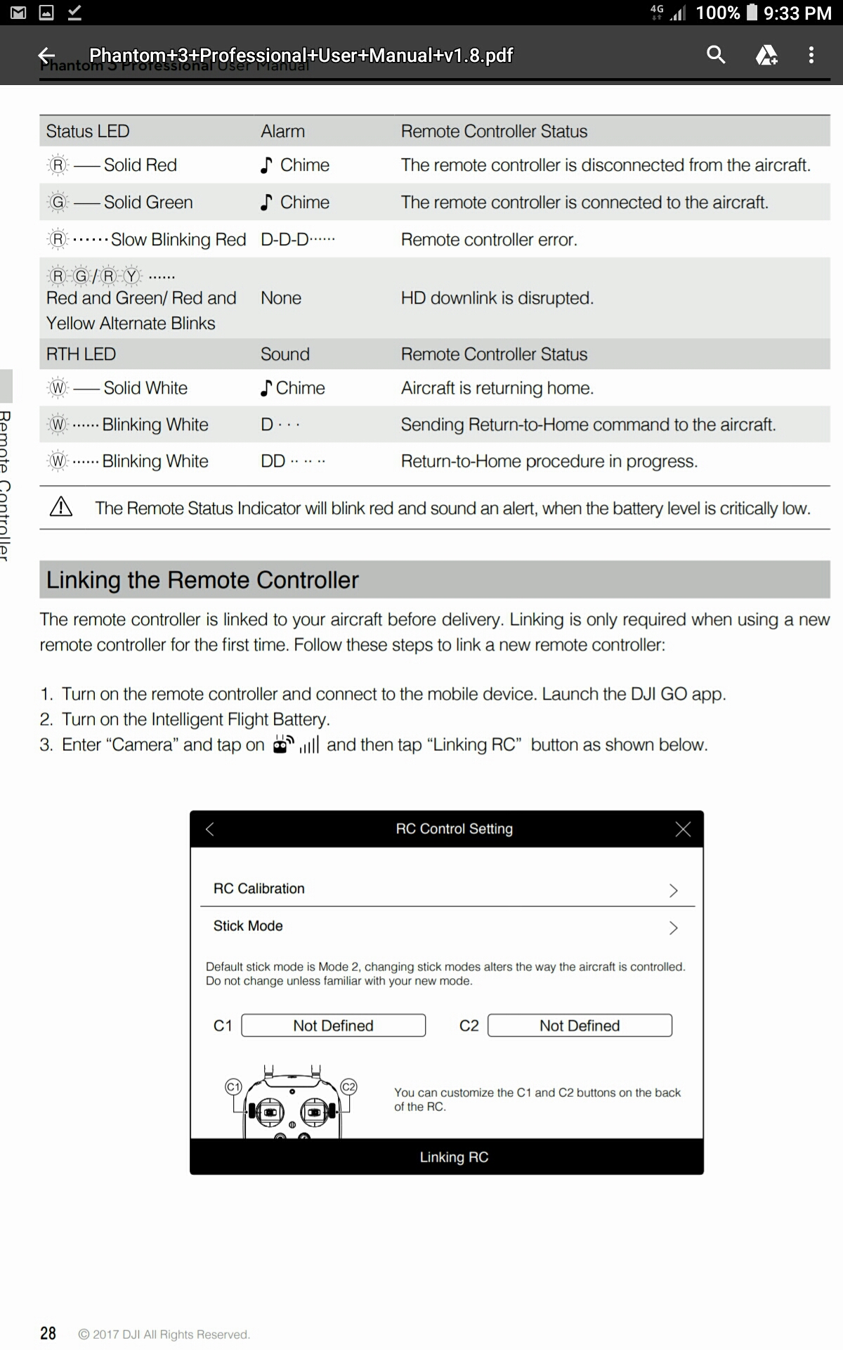

HI just checking are you sure the link button is being pressed in properly,can you feel it working,try with a pin ,yes when link button pressed and held it shod change to red to show its been activated and then should go green with remote,,,how are you trying to update firmware by computer or with the app..looks like you trying to link properly but make sure that button goes in,,here's another linking picture or was this what you try,
HI just checking are you sure the link button is being pressed in properly,can you feel it working,try with a pin ,yes when link button pressed and held it shod change to red to show its been activated and then should go green with remote,,,how are you trying to update firmware by computer or with the app..looks like you trying to link properly but make sure that button goes in,,here's another linking picture or was this what you try,View attachment 100120
Hello, thanks for answering, what I do is exactly that, I already try to press the button with a pin, even though I feel the click it makes but it does not turn on any light or anything, what I did is exactly what the video was about. And with regard to the firmware, what I do is download it from the page, place it on a sd card formatted in fat32 (try 2 cards) and start updating until it is in a constant DDDDDD all with red lights
Been searching posts looking,couple said phantom not like usb stick and try do through djigo app,here's a pic,but you do need Internet for this,,watch that vid a few times now and just notice you got gps green flash,that tell me it linked but can't see remote light in vid,,is it red still ? Do you have any light on the gimble showing,can you move camera up and down with gimble wheel
Been searching posts looking,couple said phantom not like usb stick and try do through djigo app,here's a pic,but you do need Internet for this,,watch that vid a few times now and just notice you got gps green flash,that tell me it linked but can't see remote light in vid,,is it red still ? Do you have any light on the gimble showing,can you move camera up and down with gimble wheelView attachment 100121

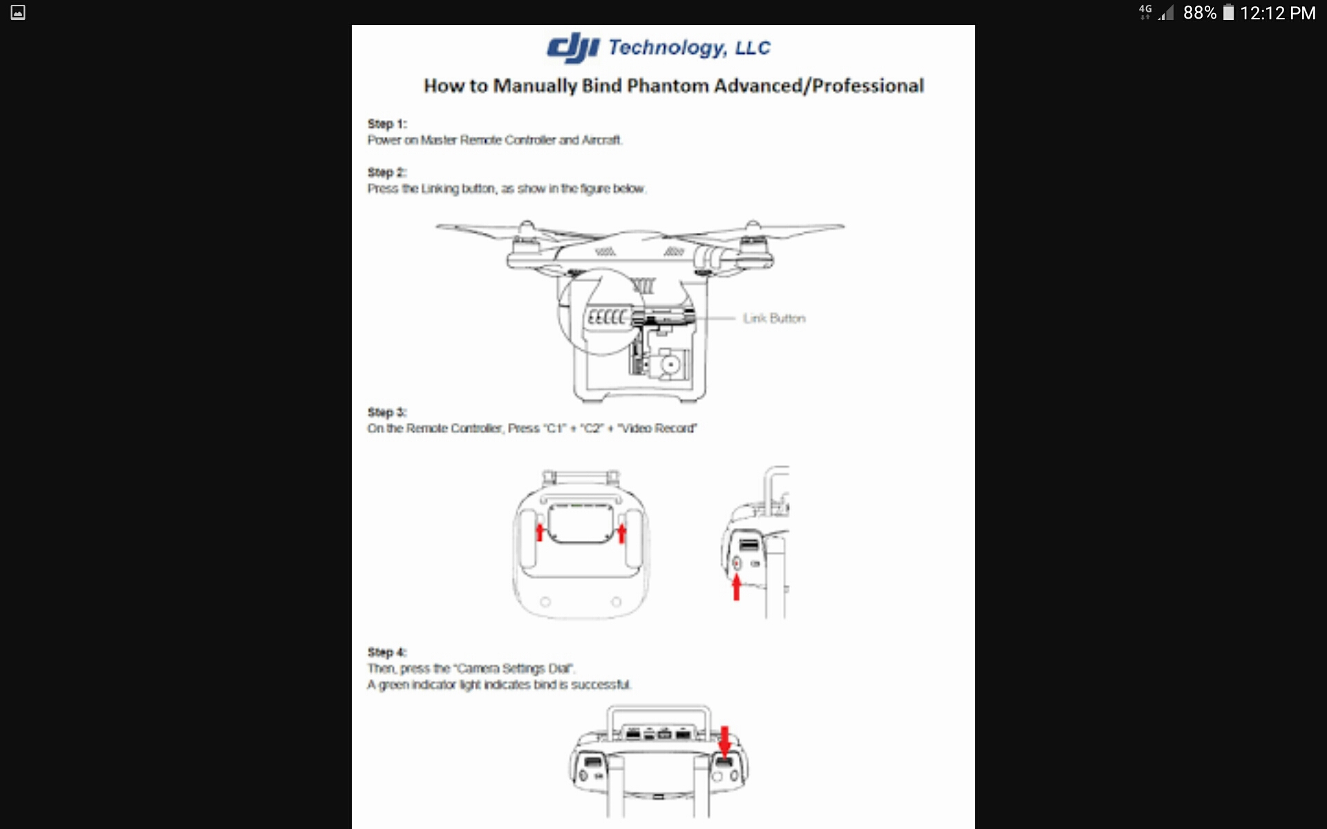

Hello, thanks again for answering, no, I can not directly link the control with the drone, if the video is not seen, but after doing all that the control light turns red and does not link, therefore I can not update it from the dji app since it is not connected to the drone, and the control does not show that there is an update for it

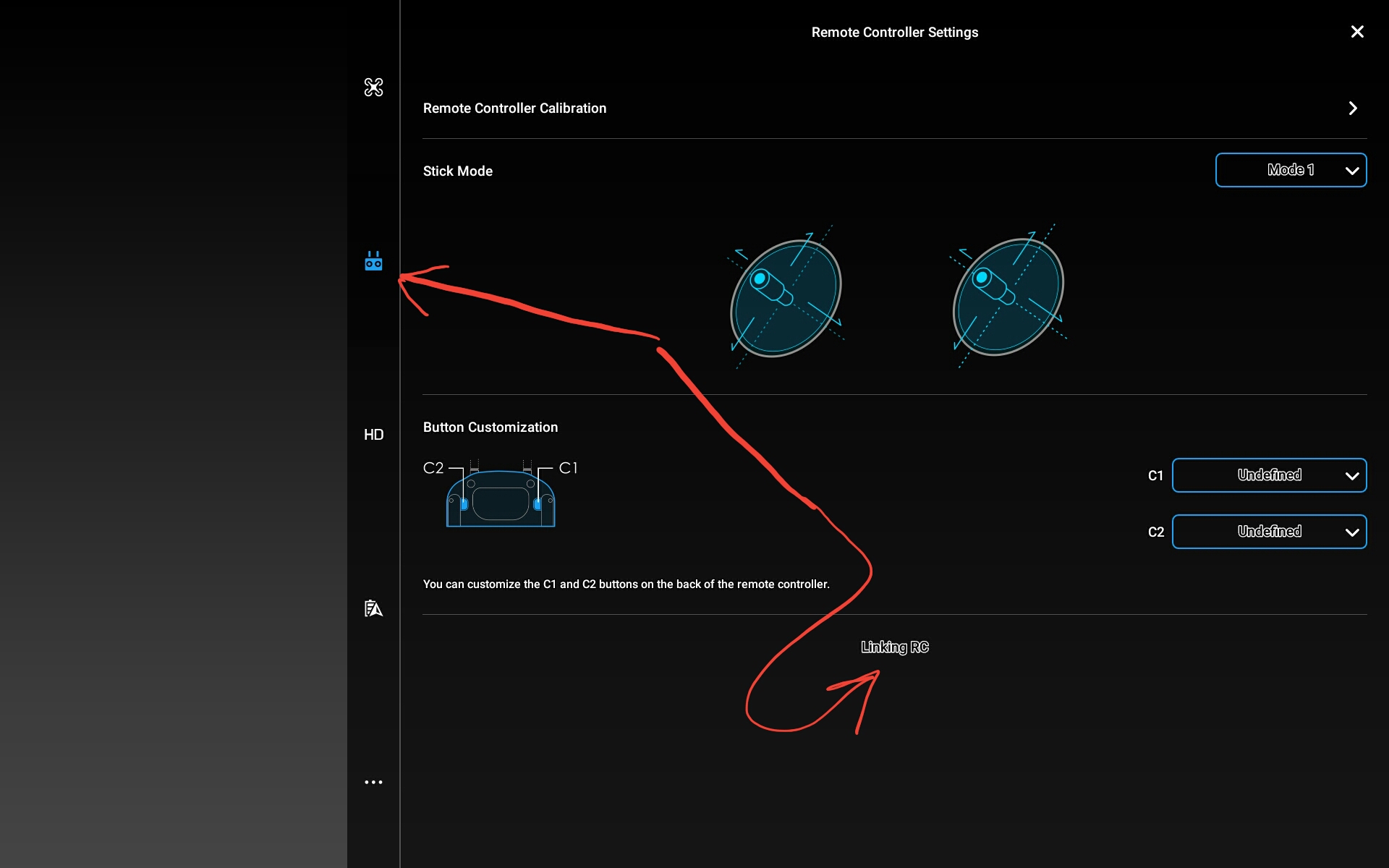

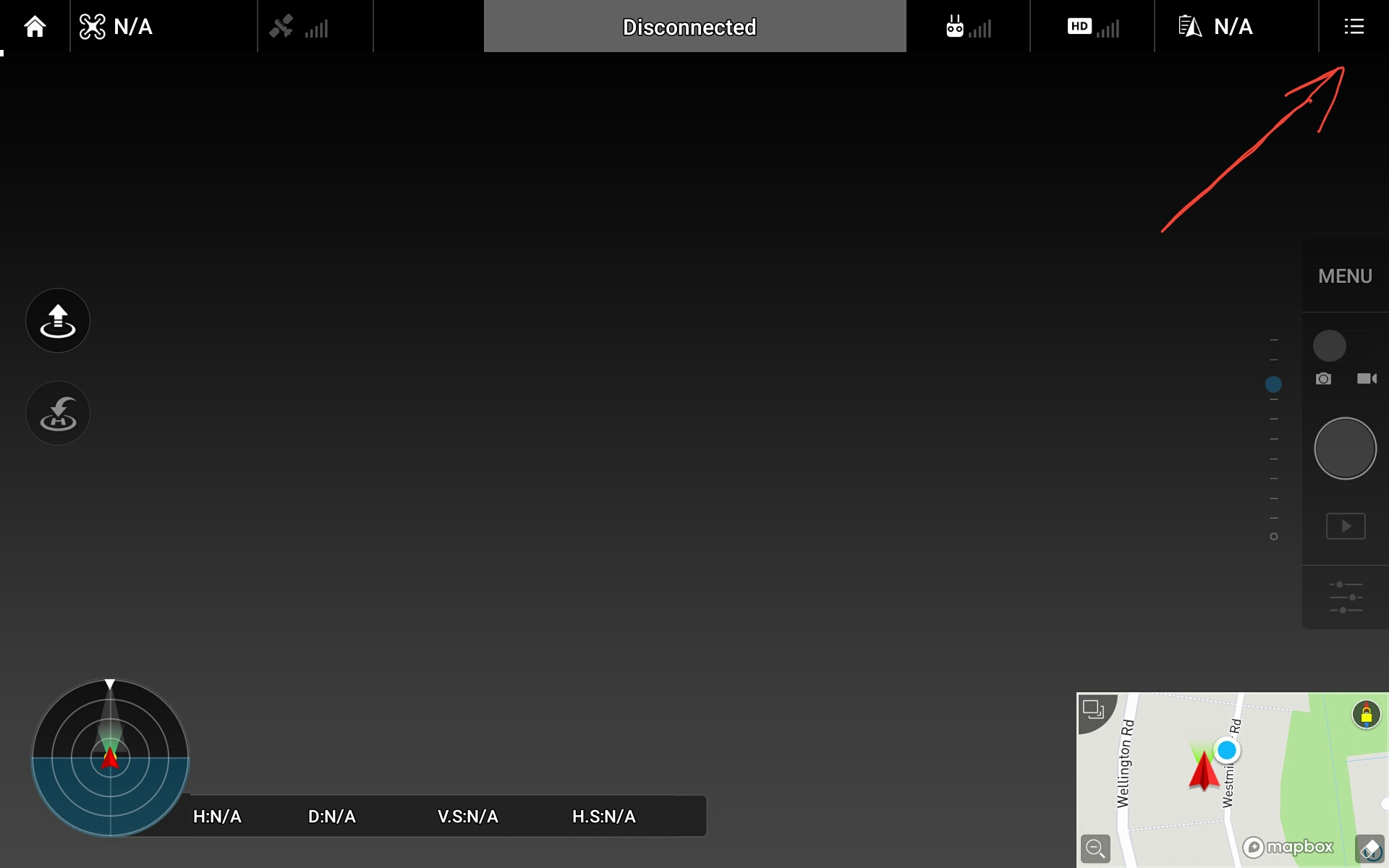

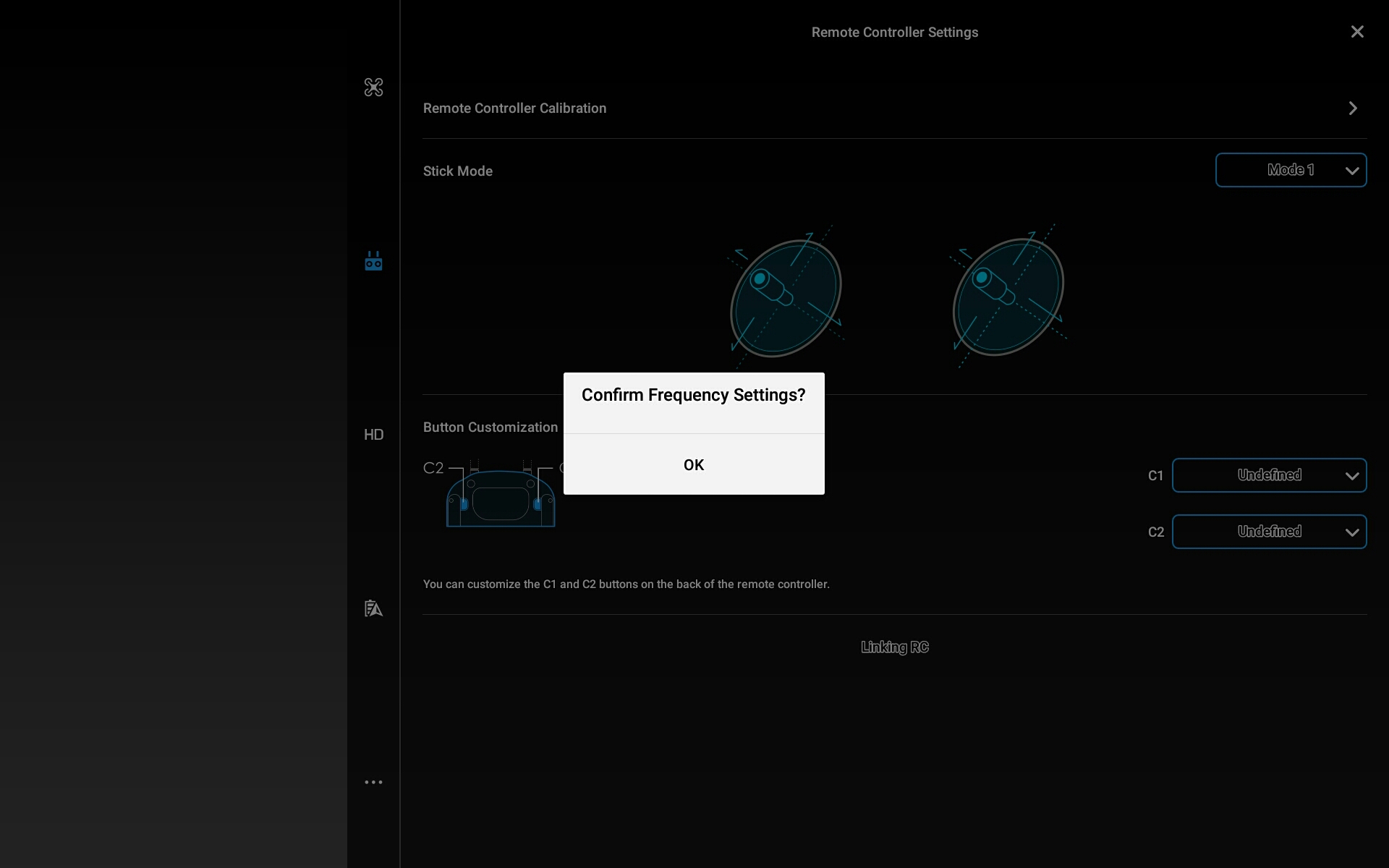

OK try linking this way,turn drone and remote on while doing this
,and remember to try push button while it beeping again or it will time out

Got light charts,I was speed reading the manual,,Yeh I notice Noone else got much to say so this is a head stratcher ,I hate that,,phantoms not like to drop ,very sensitive,since unable to get anything out of that linking button almost says it broken,,,me go have another search on it,see what comes up
Yip every post I read say same thing as we been trying,if you good with tools open it up see why no power at that link button,,it should be red when not linked or green when linked as you know BUT we go nothing there ,should be something there,might have to recheck all those connections, mate hope you get this sorted,I'm going to stop looking because all I find now is all the same replys,I'm burning lot of data searching getting no luck,I think the fault lies in that button area,
Yes there should be a red or green light on the side of the vision positioning system if not your OFDM module is not working. It can be accessed by removing 4 vps module screws and the small connector underneath (be gentle). Check that OFDM reciever wires are all connected properly.
