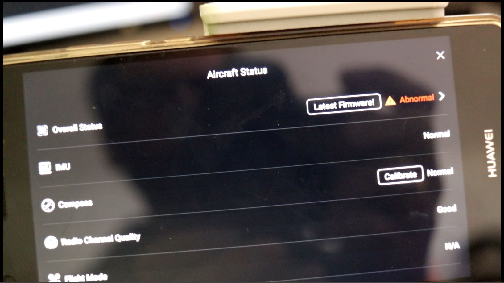

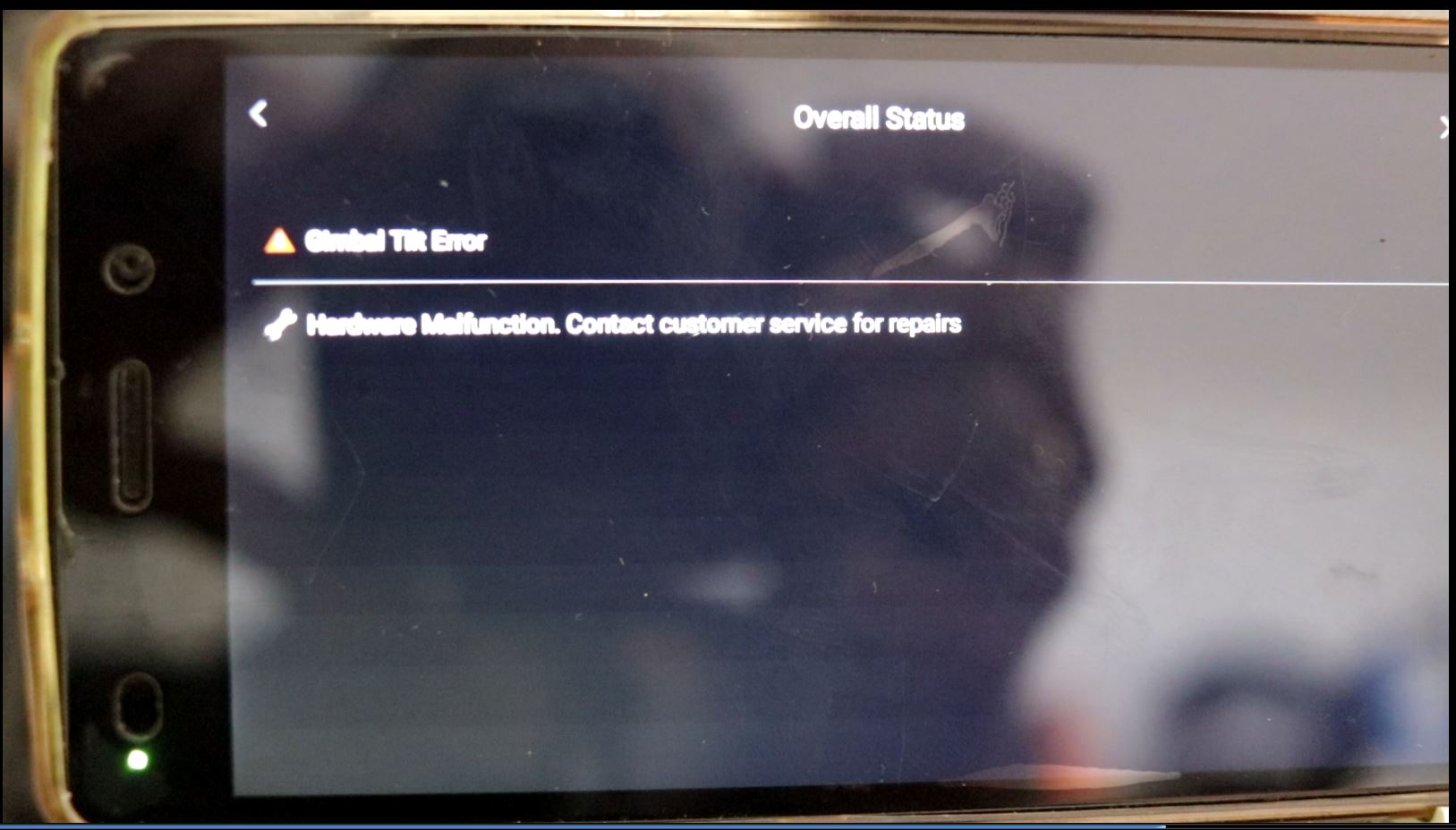

Can anyone here help with advice!
I had a prop come loose and my drone crashed from about 100m up. It fell onto relatively soft ground the body looks OK but the camera and gimbal smashed (couldnt find the camera). When I start the drone up it beeps loudly but connects to the controller. The controller reported a gimbal tilt error (no surpise there!) Is there anyway I can disable or remove the camera to see if the drone still works/flys? I dont want to replace the camera and gimbal only to find the drone is broken...
thanks

Yes, you can disconnect two ribbon cables and remove the camera. Drone will fly, only will turn off longer.

Ok thanks for your reponse, I removed gimbal and disconnected ribbons, I no longer get the error but drone still beeps

Thanks that's good of you but I am in South Africa, it fell from 100m up so I am not holding out too much hope! removed the gimbal and connectors but although the drone connects to the controller it is still beeping loudly
