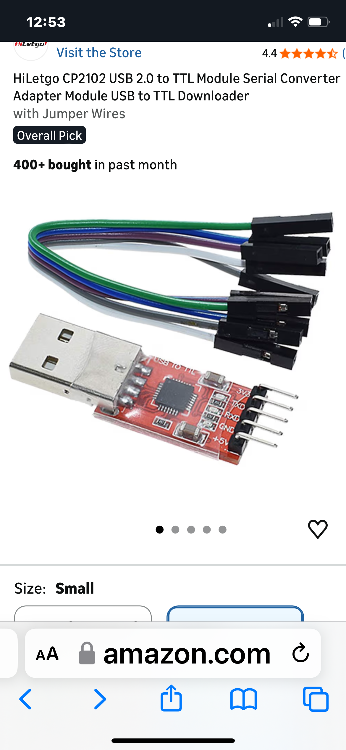

Any recommendations on a serial to ttl adapter to do the flash ? Quite a few on amazon but im not Sure which would be reliable.
Thanks again
Not really. They all do the same thing.
This what i need ?
