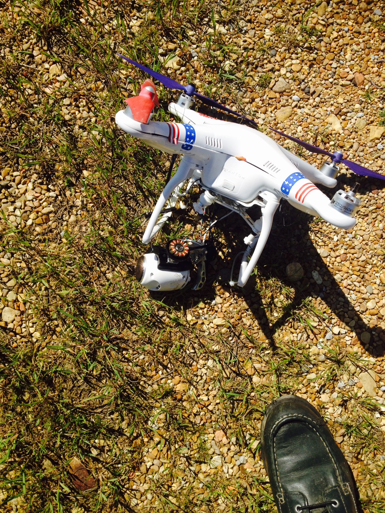

OK..this one lost power directly over my head from a hover at 249' Easter of 15 . Landed right where you see it at my feet .
Had a RPG gimbal on it and weighed almost 3 lbs . Would it have done that to that roof I don't know .
Hit my head ...uggggg
Just missed and it came down so fast when I heard the motors quit I looked up and it was passing me coming down .

Dang, you are lucky it didn't hit you! I've had a rib broken from a baseball that sure didn't come close to 3 lbs. (0.3125 lbs) that was probably traveling about the same speed (50 mph).
Take one in the head... well, you wrote the post, so I am assuming you're ok, lol.
