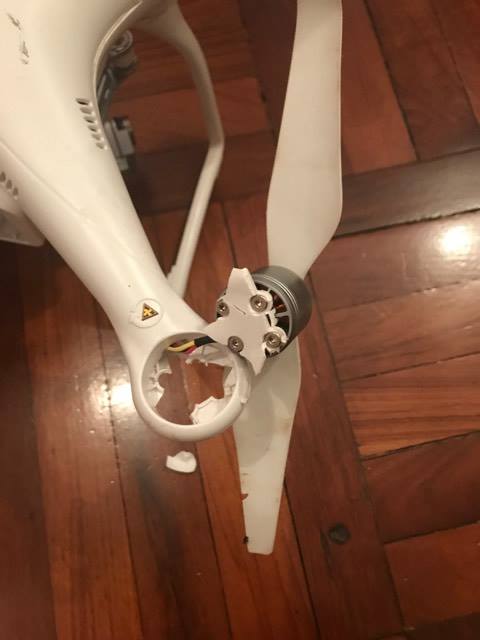

So what should I do as next steps guys? Below here are the photos of my drone (I removed all the propellors except for the one where it seems to have been the problem) and uploaded the flight data video. At the moment, I really don't know what caused the drone to fall out of the sky, but I can say that I saw the propellers were still spinning as it crashed down.

Did you inspect your Phantom before taking off to check for any cracks in the shell? It appears it might have been cracked beneath at least one of the motors.

If the shell was cracked prior to flying, DJI might have covered it under warranty if you had contacted them and sent it in for repair. They still seem to be fixing issues like this since it's a known defect in the Phantom 3 shells. I think you're going to have a hard time proving those cracks were not caused by the fall at this point. You could contact them and see what they say though. Perhaps they'll cover the shell and make you pay for everything else that's damaged.

i've broken the propelle once, so I know they're very fragile. Definitely more fragile than the plastic shell of the drone. If the crack happened after the fall, I can't see how you can damage the motor mount on the arm without breaking its propeller. I think you have a good case against DJI here. Good luck!

If it the crash was caused by the shell, then I put my hands up and I say, yes I should have checked the shell. However it is worrying that a leading drone company would make their product to fail so easily. I'd only had my drone for just over a year!

It might be that the shell failed in flight, they don't fly on three motors.
