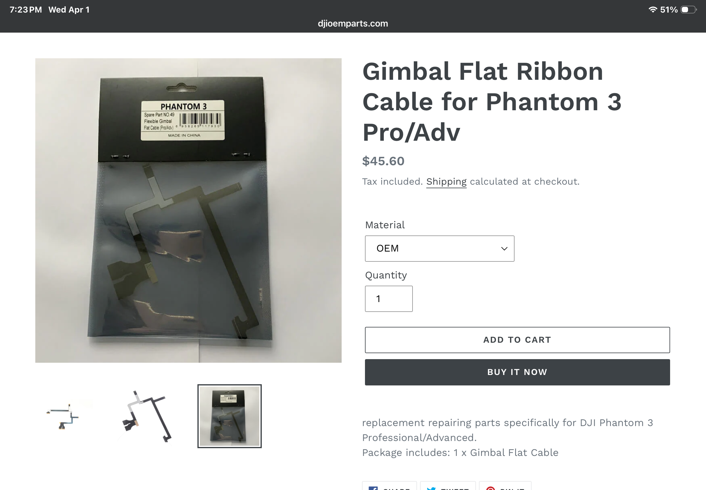

The OEM part number for the DJI Phantom 3 Professional/Advanced/4K gimbal ribbon cable is
Part 49. This flexible flat ribbon cable is designed for the 4K camera system on these models.
I'd recommend ONLY a OEM DJI ribbon cable #49. There are copycat aftermarket cables out there, but most rarely work correctly. Good luck.
Reactions: brigerdrones
It will look like this, come in a smoke colored bag with correct DJI Part # 49 labeling........and will probably be priced near this price listed.
There are knockoffs out there for $10-$20......but they rarely work correctly....if at all. Again,.....good luck. 👍👍
