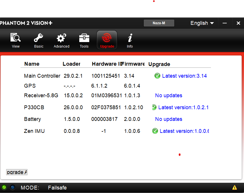

I dont think the issue is just the ceramic disk, even if this was smashed the quad would see the board it was mounted to and show GPS details. you need to buy one of the units I mentioned in my last post to rule out GPS or mainboard issue
Got the new puck today hooked it up and this is what I got in Vision AP
I’m stuck because the batteries to test with I have are bad, I tried to revive one but it’s not working right, I can’t find an affordable used one, so I’m gonna try to do a battery mod and try a 1800 or 2000 mah and see if I can proceed with the testing, so far no motors but that's probably due to a low battery.
