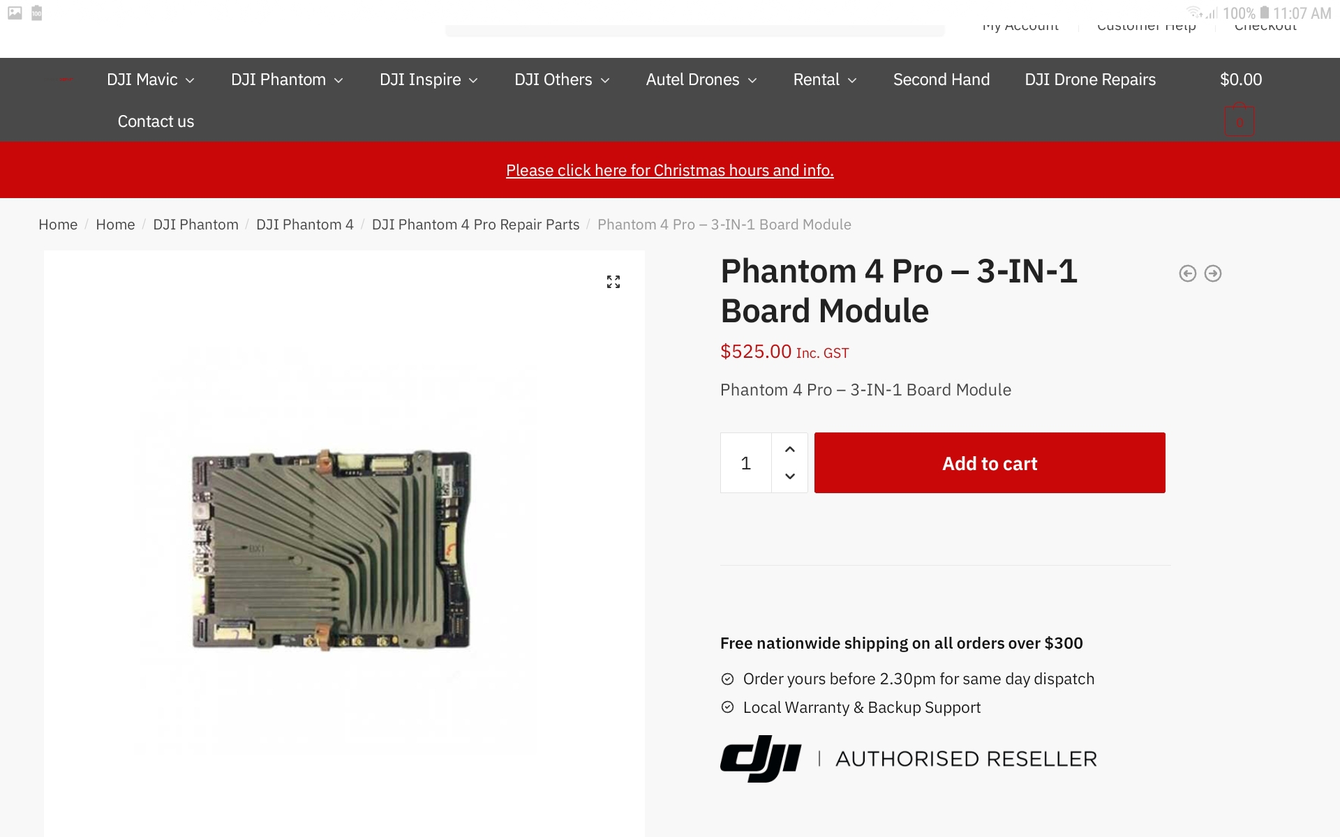

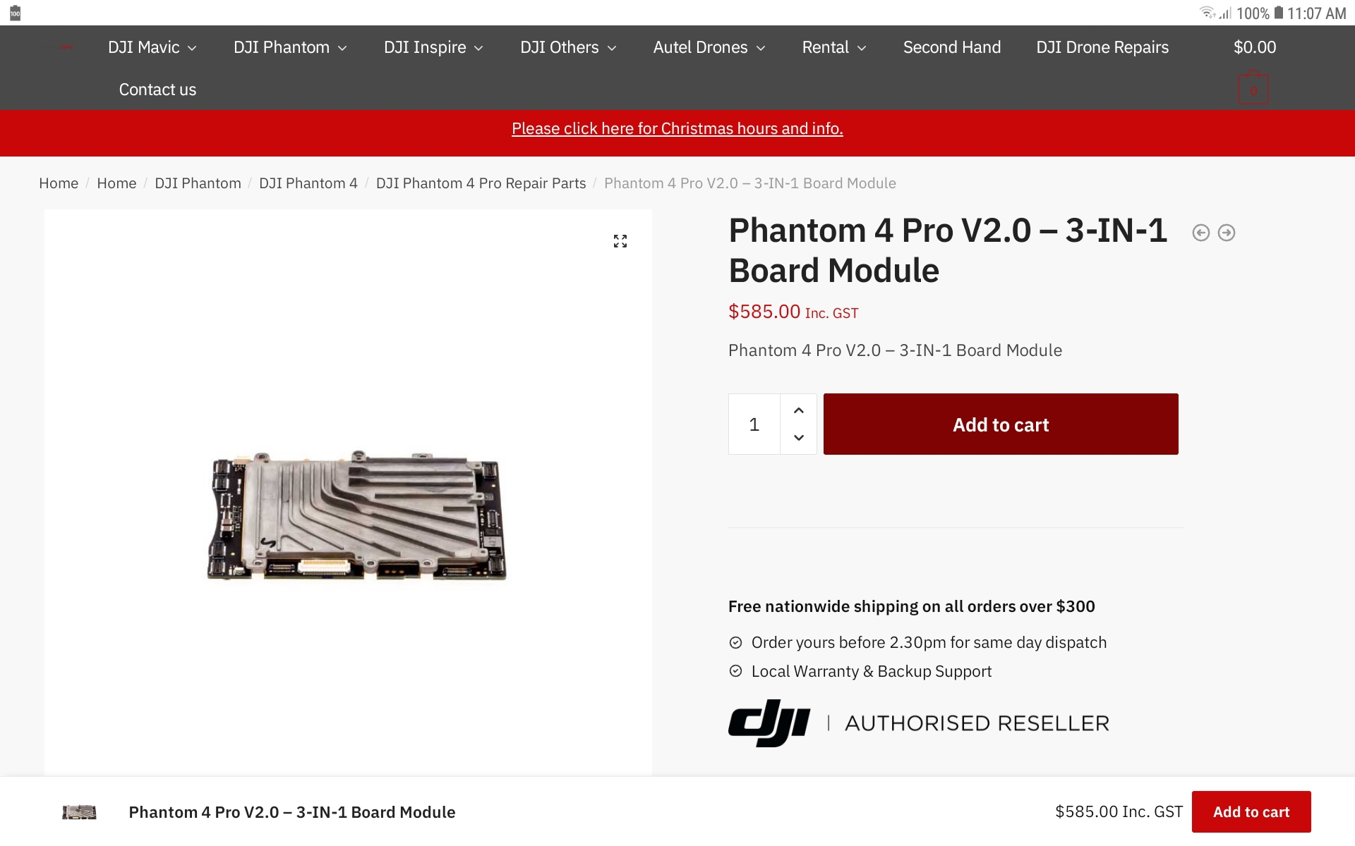

It's a long shot, but does anyone know if the 3-in-1 board for a regular P4P will work with the parts for a P4P v2.0 or does it need to be explicitly for the v2.0?
Um,,,just looking out of curiosity and they appear to be different,,couldn't find if they compatible or not so must not be just to be difficult,,,yes top $$$ here for that part,,best bet I think is try find a crashed one for parts,,and welcome to phantom pilots world
