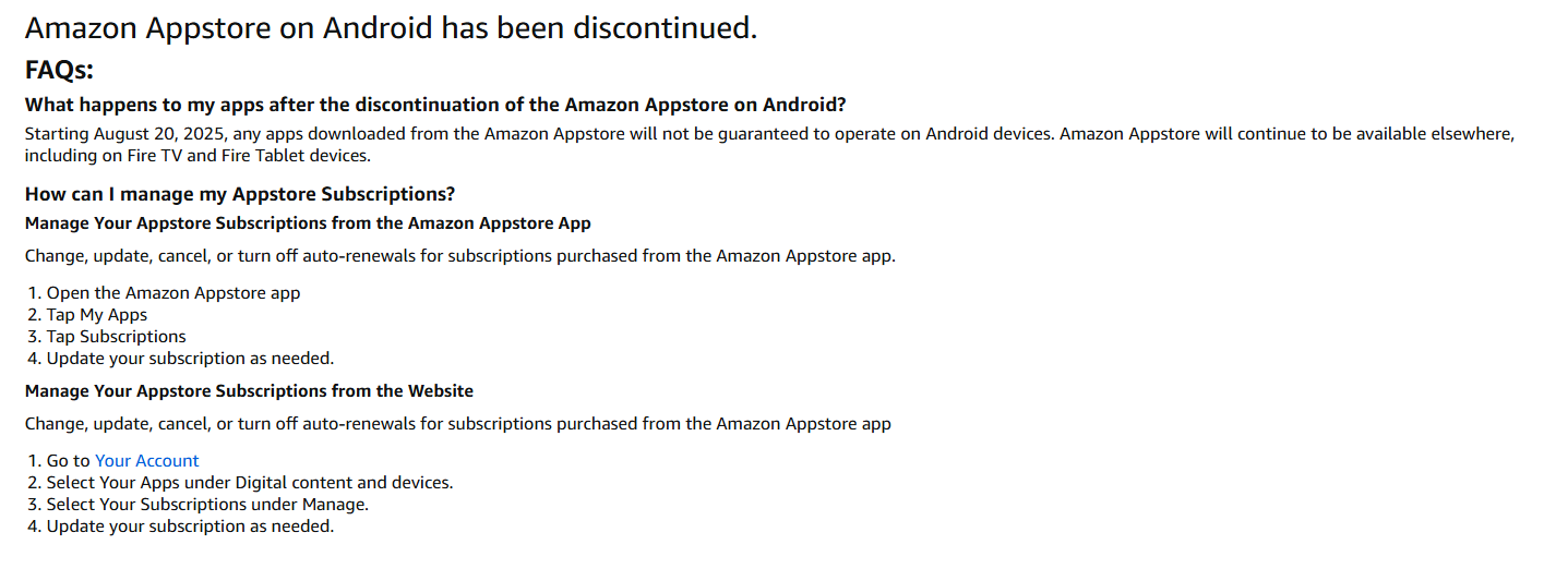

The information is no longer relevant. :(
