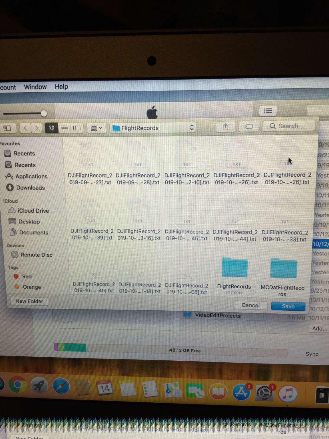

I am sincerely appreciative with the help! I’m still trying to download the itunes on my mac which is super slow. Then syncing the ipad to gather the data(s) requested. Pardon my ignorance. But as you can see, I’m mostly active in the forum browsing and reading to gain more knowledge. Although not much of a commenter.

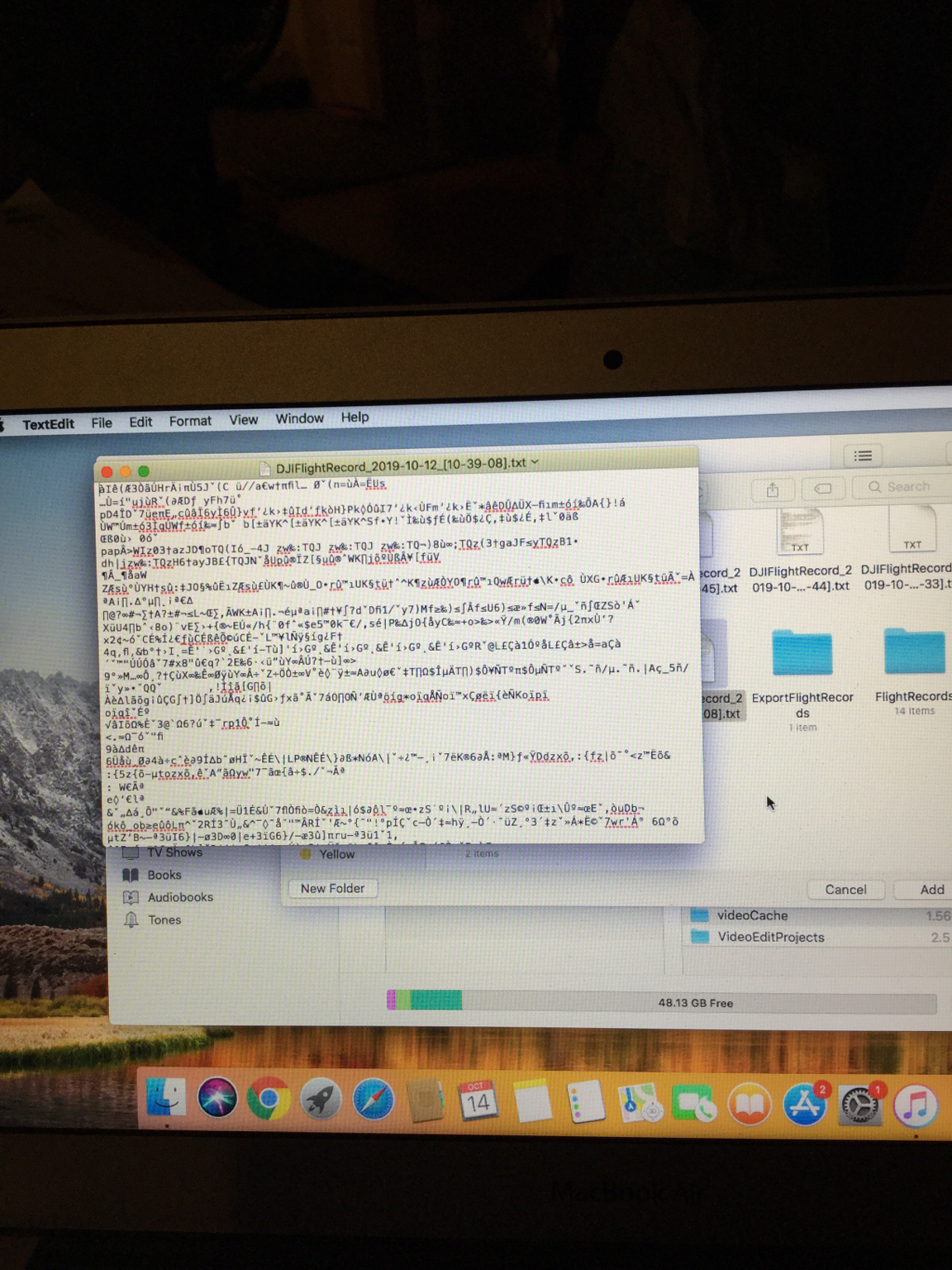

No matter what I do, the text won’t open. Ah well, maybe I need a better Mac.
I was actually able to open it but it’s encrypted/
You don't have to open the .txt file.
Go to the link shown in post #12 and follow the instructions there to upload your .txt file to that site.
It will deal with the encryption and show you a report of the flight data.
Then come pack here and post a link to the report it gives you.
