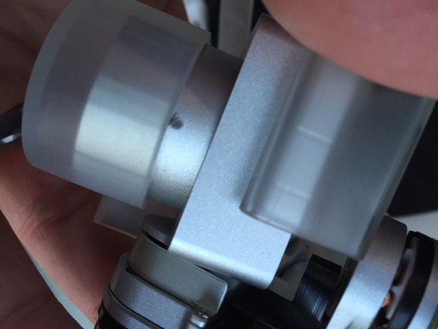

Still trying to figure out how to remove the camera. There are two other wires besides the ribbon???
Thus far the landing gear is cracked on 3 of 4 corners, one motor seems loose but the housing is popped so I need to straighten that to really see. Upper camera mount is broken, black wire??? Pulled out of camera, single grey is still connected. Can't figure out how to loosen cover to remove. 3 of 4 carbon fiber blades damaged. Prop guards shot. Haven't gotten inside cause I can't remove the camera to see if anything is loose or broke
To remove gray wire, look at the small door like piece that the wire goes behind . on the back side of that are 2 screws that release that piece and then a small connection so you can release that wire and the camera will come free. Same for the black wire that is broken. Mark where they go as I think they need to go back in the same place

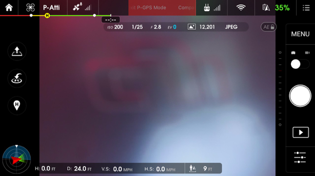

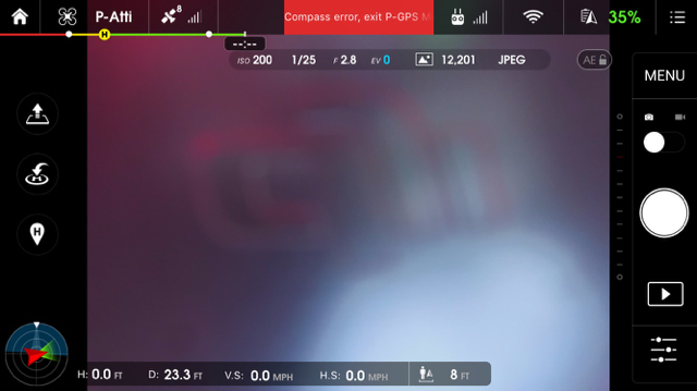

It came Down slowly and got to about 100 feet and all of the sudden the bird began to wobble side to side vigorously. I tried to ascend and basically had no control of it. I turned off the RC and turned it back on and that didn't help either
The comment portion "it came down slowly" would seem to contradict the notion that VRS was the probable cause since it is only likely to occur during rapid descending and even more unlikely in a P3 model with the design and firmware changes to prevent it.
I've flown with DJI prop guards and OEM props for > 100 times in all kinds of situations and done some very aggressive descending to the maximum vfps that the firmware allows and NEVER had any level of VRS occur... this is regardless of whether descending with pitch or straight down...
Prop guards serve a great purpose but, like anything added to the P3, have some penalty to be sure and have to be considered in the overall flight results... but simply adding them to your P3 doesn't automatically mean they will cause problems as so many seem to suggest.
