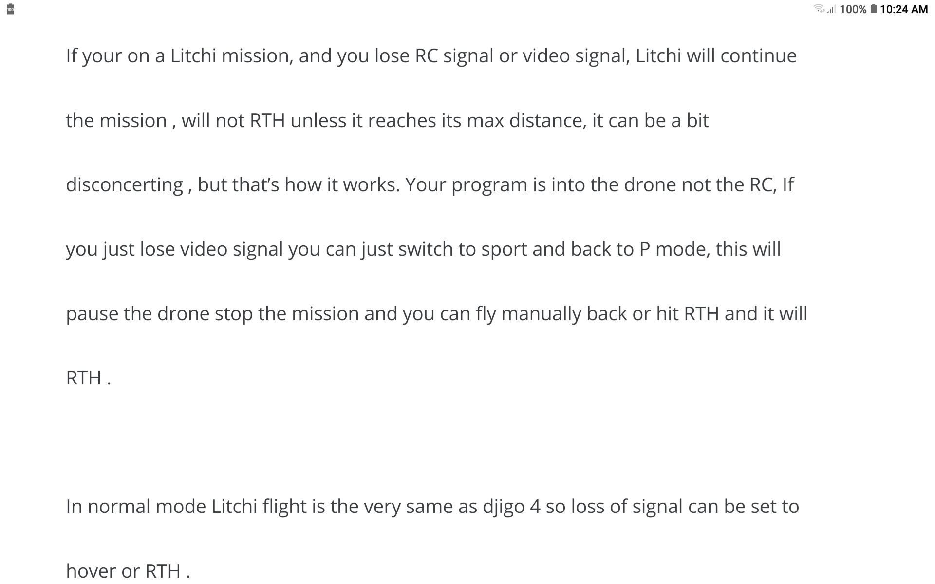

Um if using litchi if signal lost it will still complete its rounds as planned
Litchi will complete its mission, but what it does to complete its mission depends on what you program in to it, whether it is RTH, hover, return to first waypoint, reverse mission or none. Make sure if you use RTH or return to first waypoint your altitude is set high enough to clear trees, houses or any other obstacles that may be in your way. If you are flying low, make sure the RTH altitude doesn't cause the craft to fly into low hanging branches or other obstacles before reaching the RTH altitude you've set.

Yes the mission will continue with out remote control signal. I make mine come all the way back. (I actually set it take off and land)
