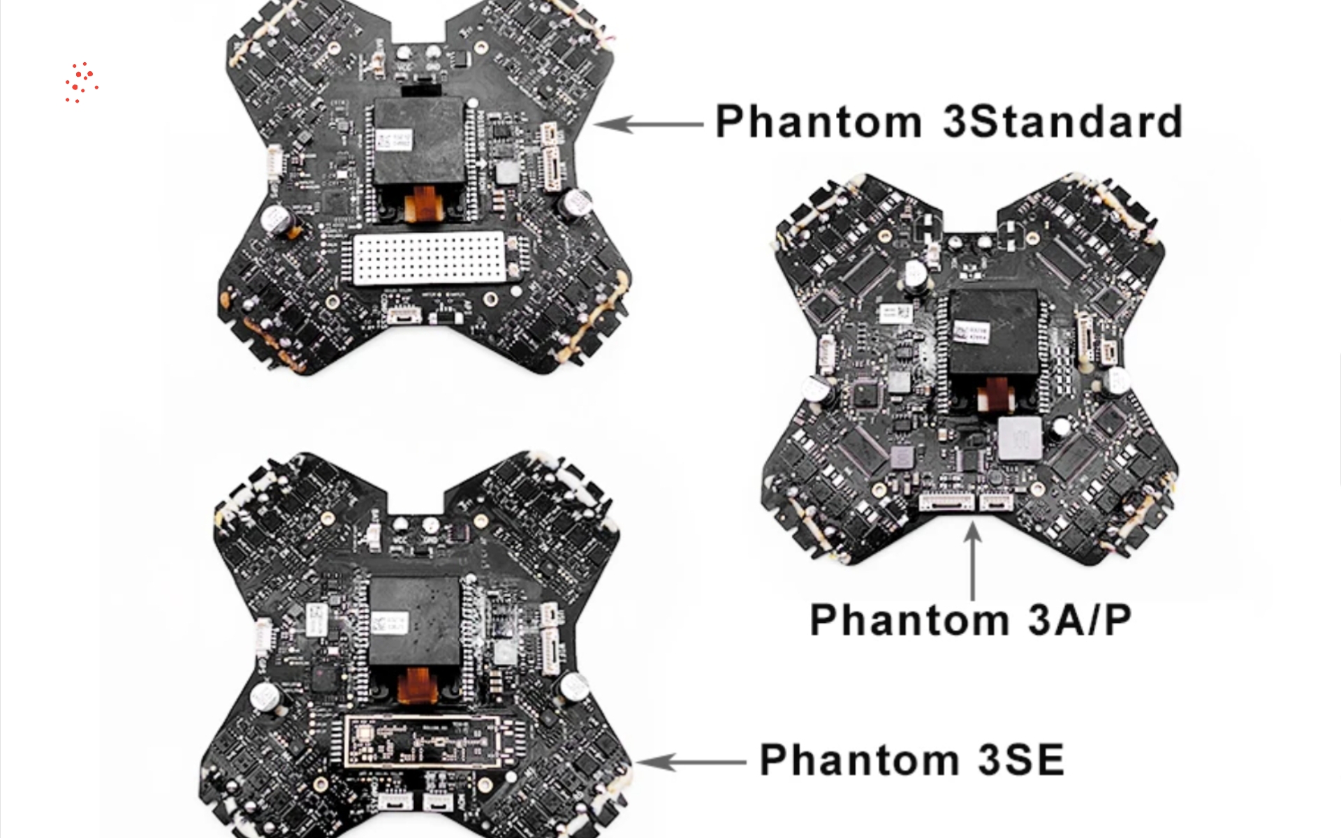

Me can add to this ,unfortunately no not the sameView attachment 125796
Typical of DJI to make things awkward
It would be to easy otherwise,SE seems unique,,I better go how before I get yelled at lol
Ian.....those are great comparison photos of the internal differences of the P3 models 'guts'. These are good to have for future reference. Thanks. Gonna' keep them in my endless drone info and pic file. Great research NZ !

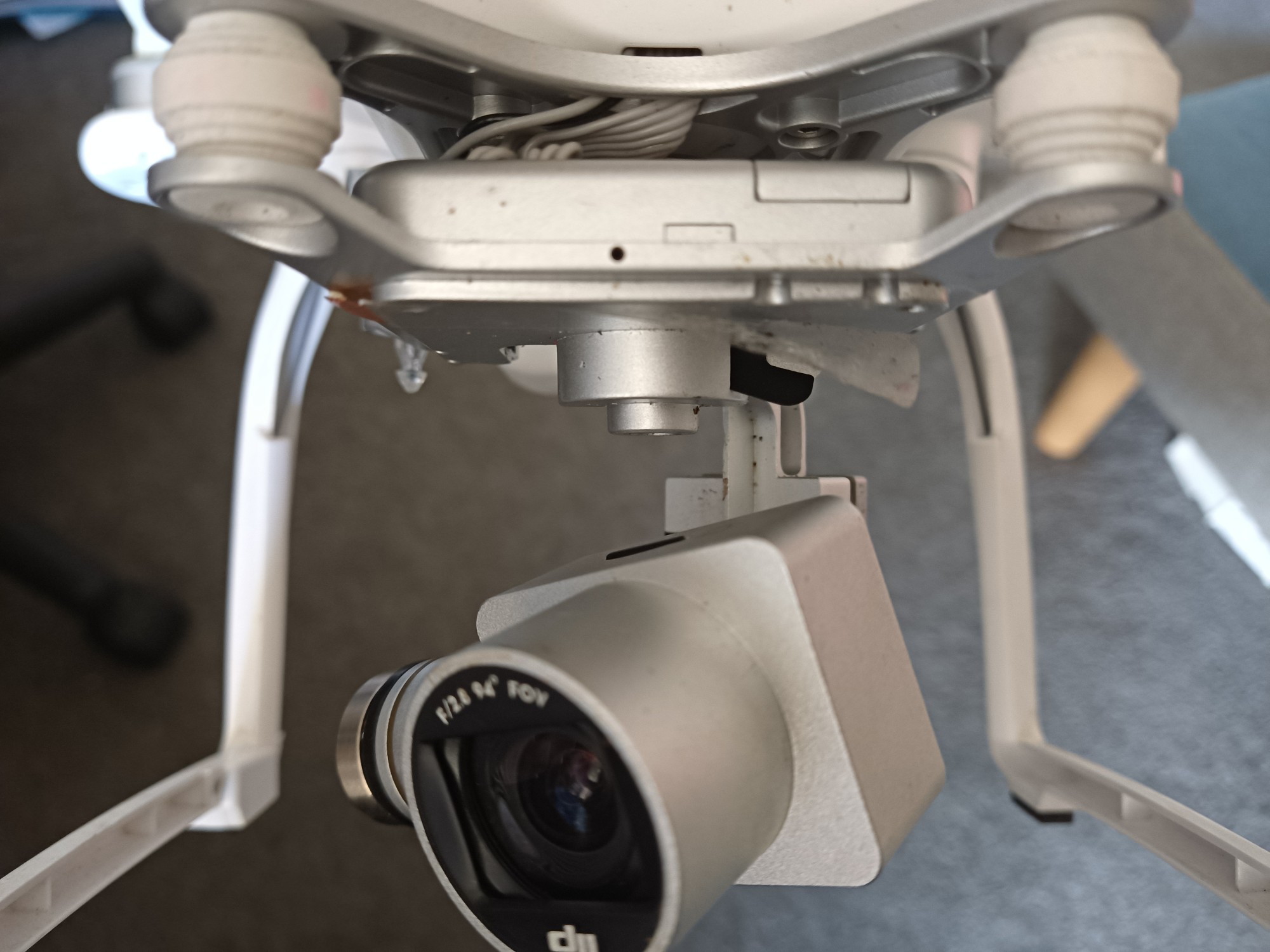

Be nice to see a picture of camera with gimbal and what I call the gimbal block? The part that hangs from the rubber shocks.
It looks identical to P3 Standard, though may be different inside: the specs for the camera say P3S is 2.7K and P3SE is 4k.

Thanks for the pics.

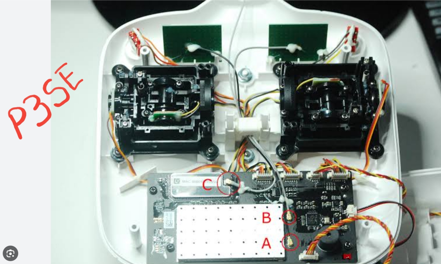

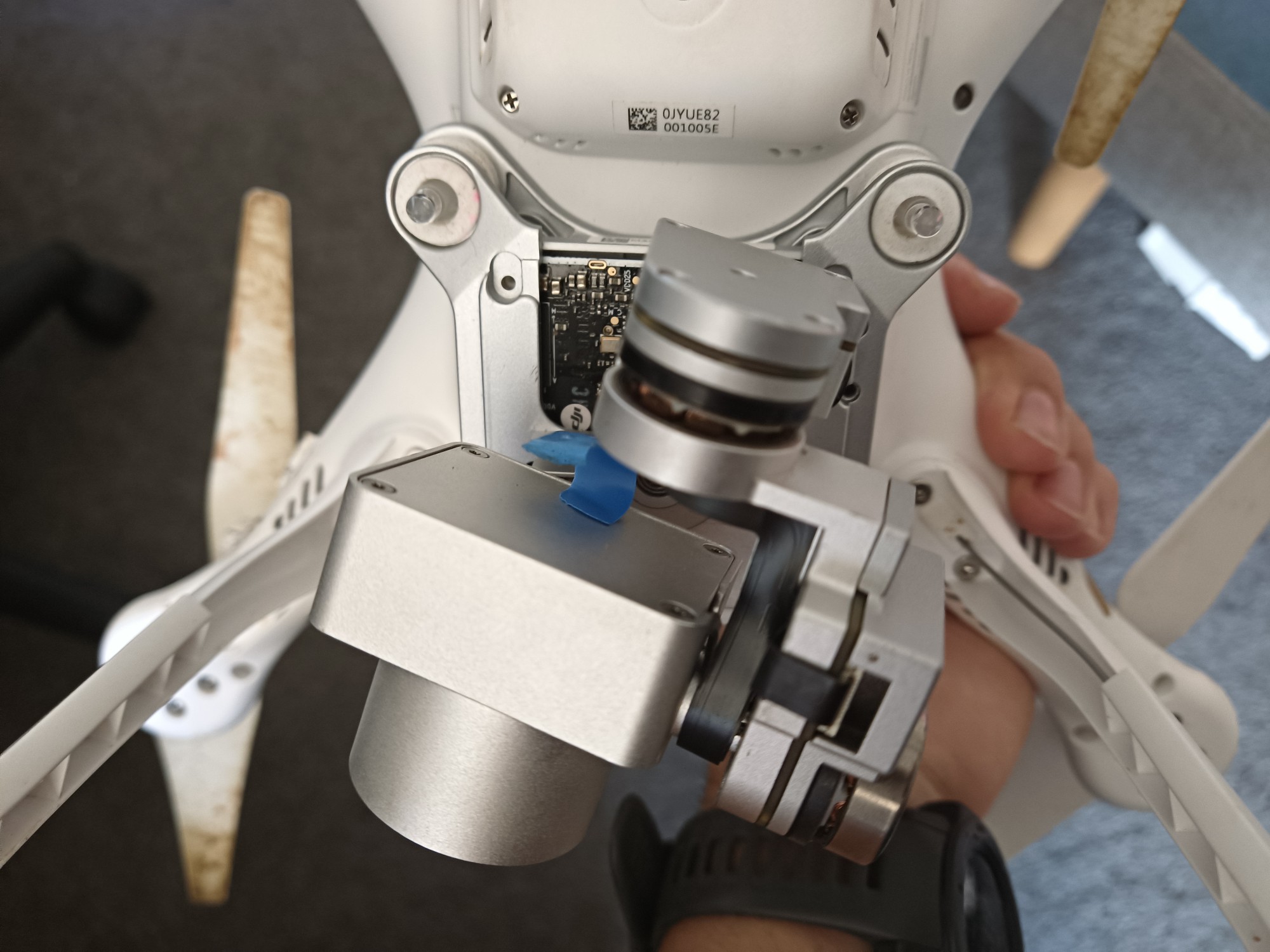

I bought it second hand of course :) The camera differences could be in software ? Also had a chat with another drone enthusiast, he suggested checking antennas (apparently the remote external "stick" antenna may have coax inside worn/broken). Checked inside remote, couldn't see anything obviously broken/loose. Flew one battery more or less ok (dropped connection about 3-4 times), second battery was again, unflyable.
Also with my camera dangling on the odd angle - apparently it's near impossible to get the correct zero on potentiometers that sit on the gimbal motors, and feed back into gimbal orientation logic. He suggested looking for the complete gimbal assembly (hopefully intact when people convert phantoms for fishing).

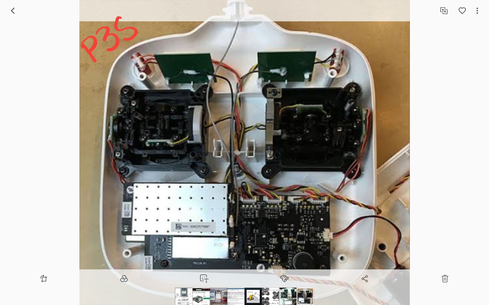

Hum, this is getting deep, since you looked inside the remote the two pictures that where posted by LOVE :) , which remote did you have.
and
I don't know if the remotes can be swapped.

Thank you for all suggestions. Today I tried to fly again, same story, intermittent loss of connection with recovery after flicking GPS/ATTI switch a few times. Until after one of the connection losses it crashed into a water tank and gimbal assembly got detached completely (rubbers gave up), ribbon cable and two coax antennas detached and left on bottom of the drone. Now it doesn't connect to remote at all, app has constant 'Remote Controller Signal Weak' message flashing.
I guess in P3SE gimbal does play part in the comms...
Also my remote has P3SE configuration inside.

Yip gimble relays telemetry too and sounds like ripped ribbons , it's not happy ,detached antennas or broken probably weak signal onscreen and now you have to weigh up the cost to at least fly this one again,,,picture say 1000 words
