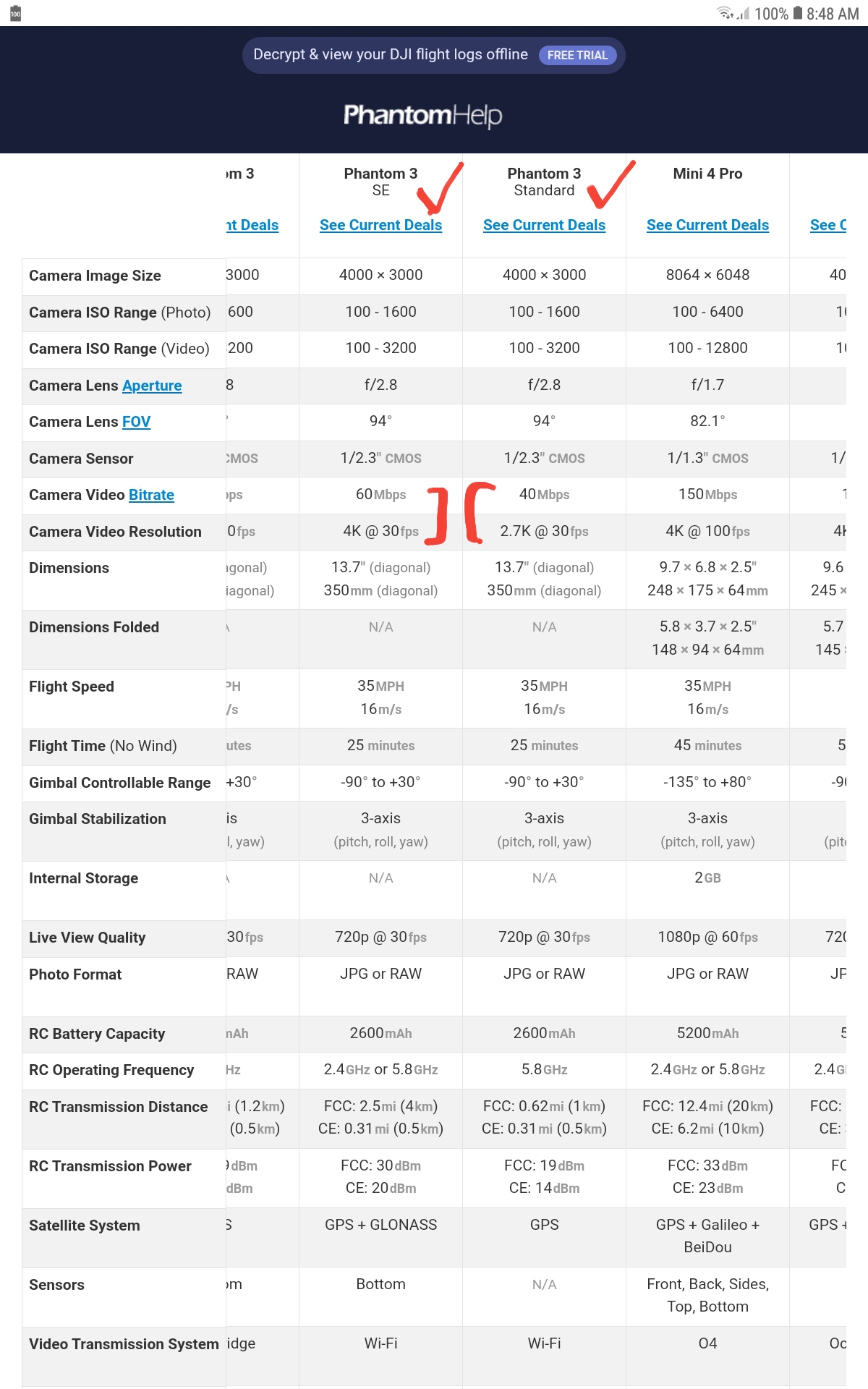

Deleted specs on p3se & p3s cause its irrelevant to ops question

Anyways what do you know about the difference between a P3S, P3SE is it just the camera?
I would like your opinion before I actually post to the OP.
Rod ..

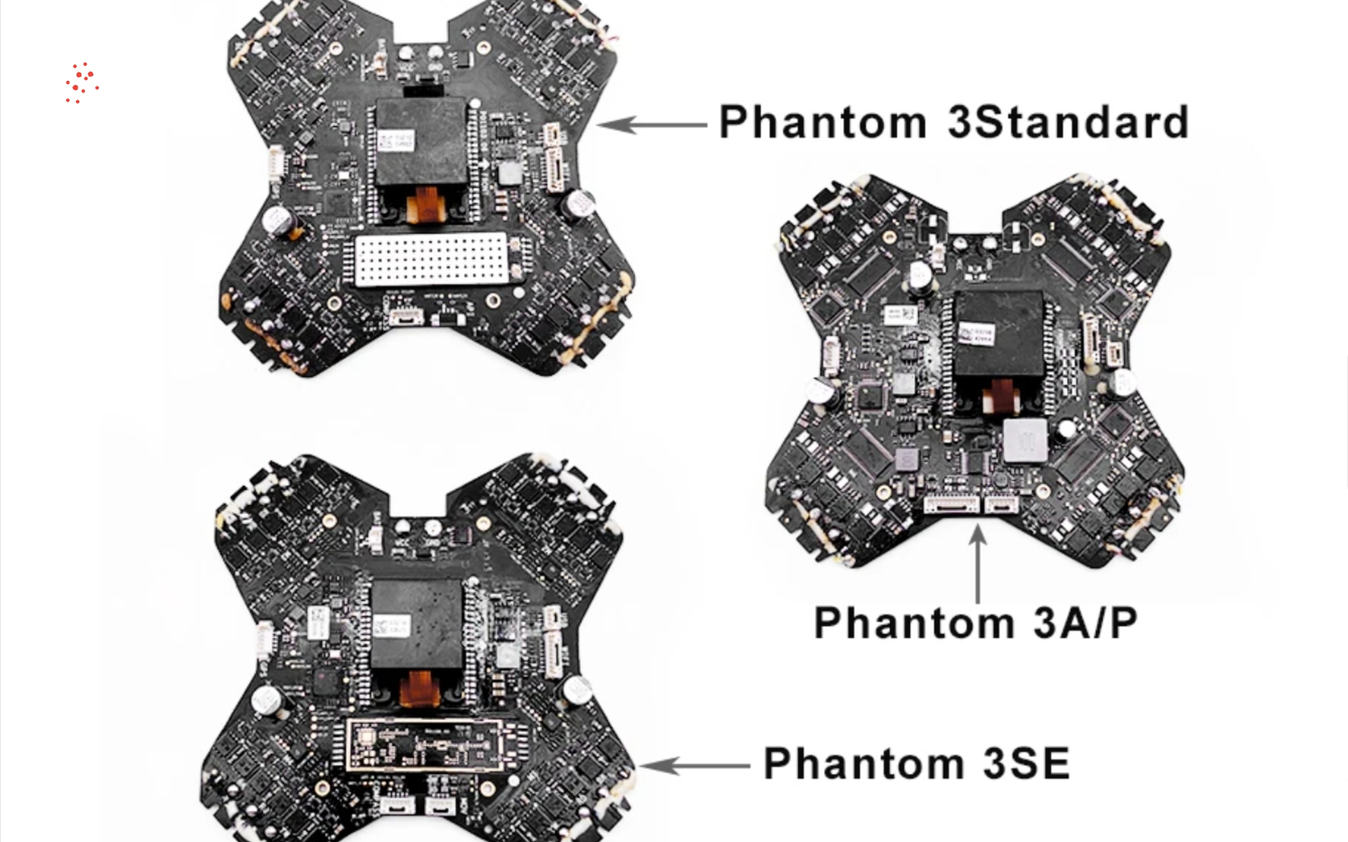

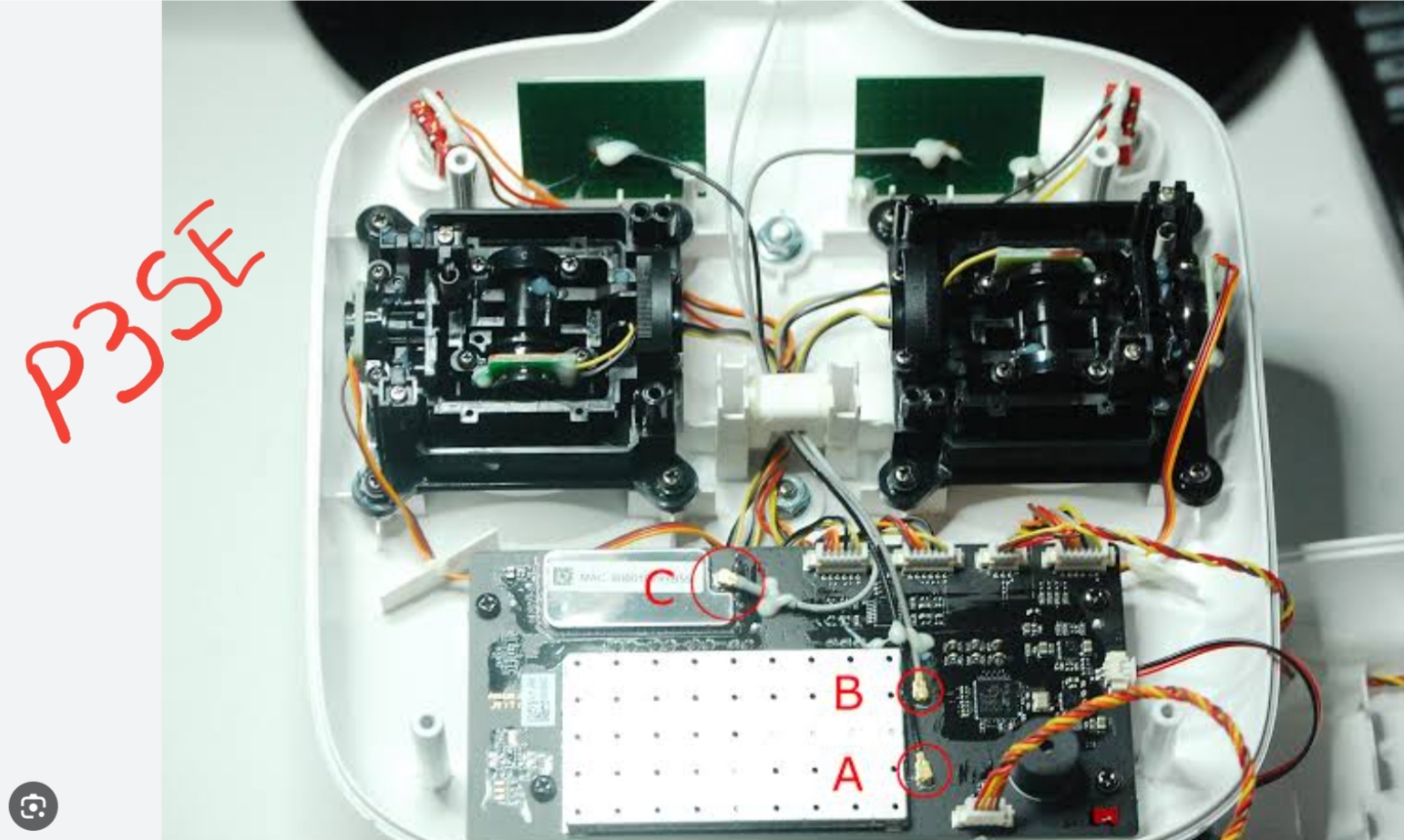

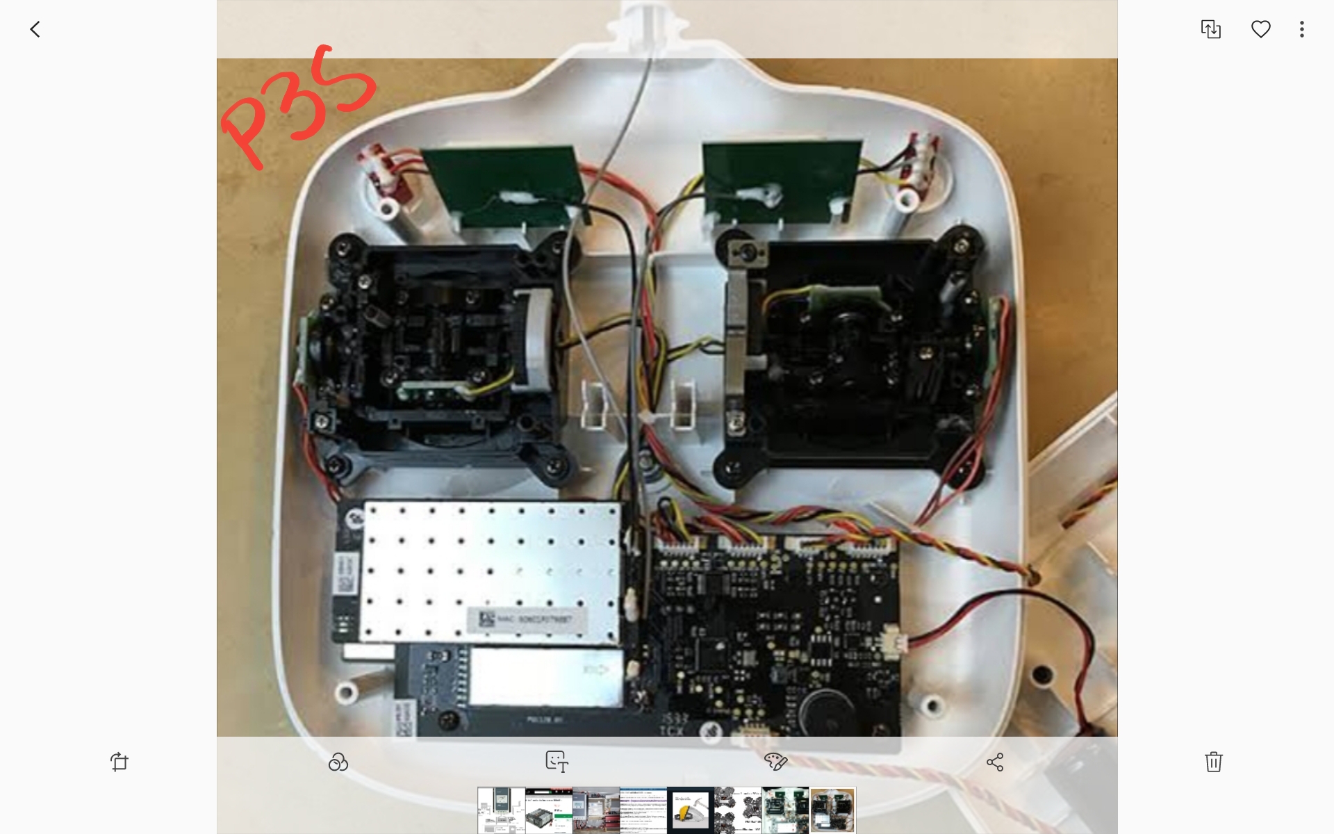

I'm guessing the P3S, P3SE use the same remote and mother board.

Me can add to this ,unfortunately no not the same
Nope. Got two P3 Standards in pieces (got them for parts from fishing idiots, so they are all full of sand and salt corrosion), and they are internally quite different, particularly in radio gear.

Thanks for those pictures those are !!!!
