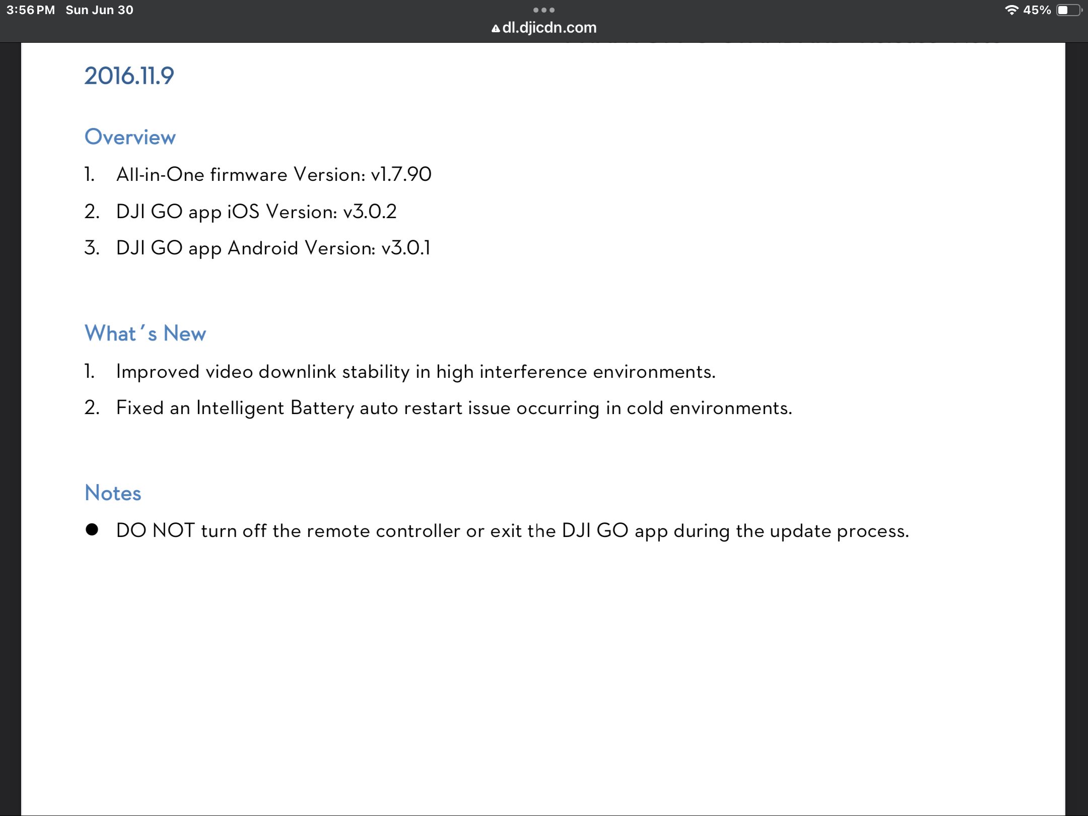

The firmware (1.7.90) and the GoApp version (3.1.80) are mismatched. Preferred match is listed: The GoApp version is the newest (04/21/24) and the firmware was released 11/09/2016. As mentioned, a firmware update doesn't always work......and since DJI no longer supports the P3S Standard, it is a risk updating when it can cause issues. The GoApp versions can be downgraded however.
I downloaded and installed DJI go app 3.0.1.
