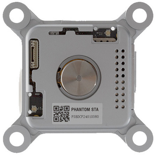

The gimbal / camera assy needs to have a sticker on top that says PHANTOM STA. Is that what you have?

The RC needs to be model GL358wA for a P3S. Is that what you have?
Thanks forthe reply... Yes those are exactly what I have. I made sure that the components i bought are for the P3Standard.

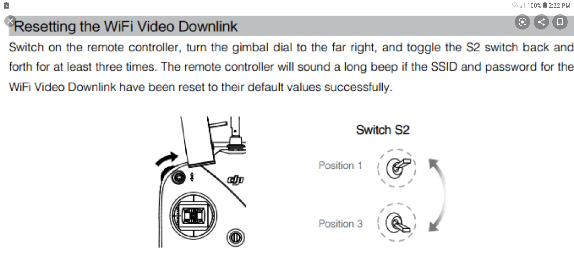

Gimble light green and presume remote green and single red light,,,,reset the remote might do it since gimble light green but no control from remote,,,I see if I can find the process,,,,,try this then try link

Ok, so i tried to reset the RC as you suggested and then did the binding method (with the full charged batt and remote)... but it still did not work. What could be the problem?

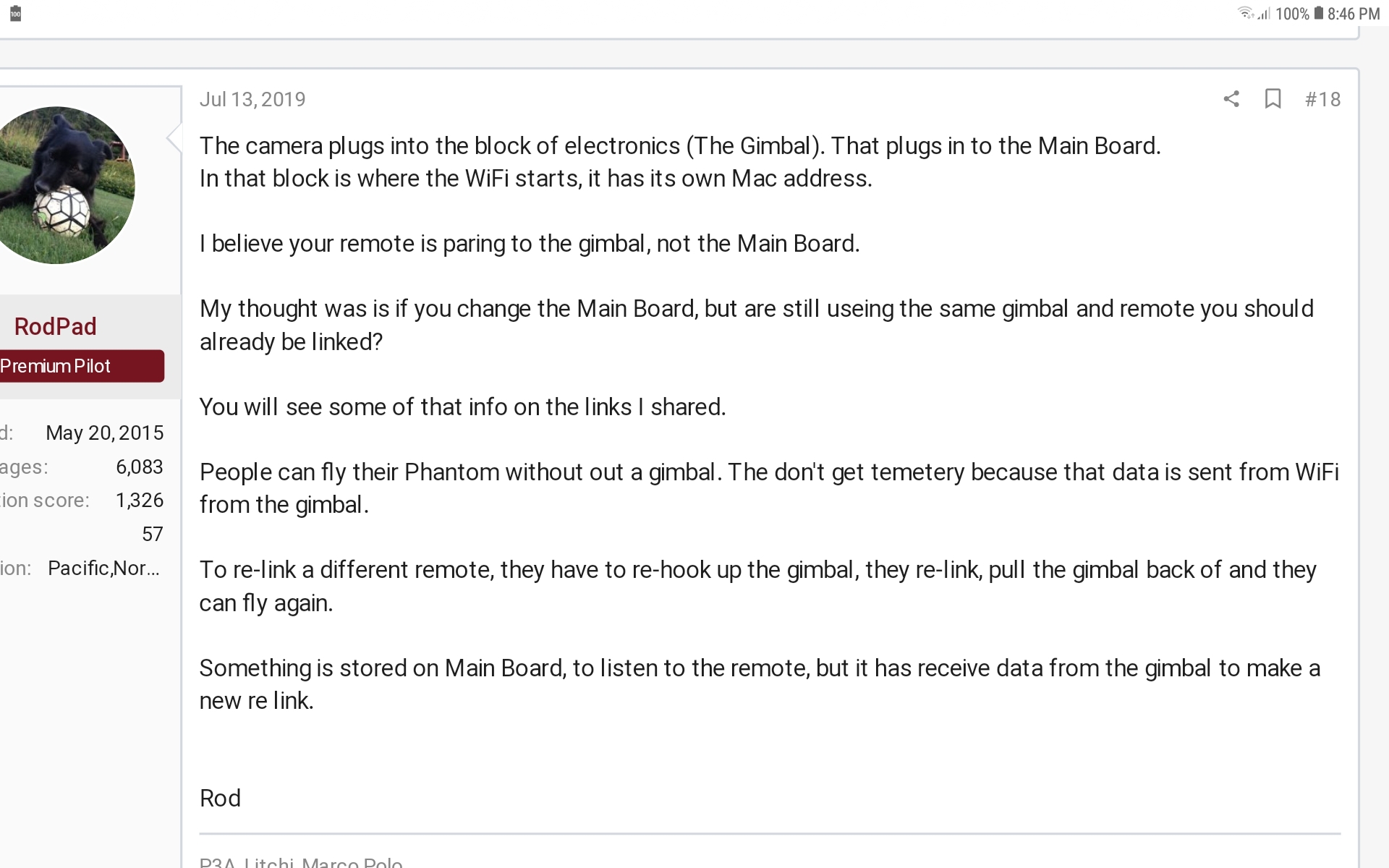

I did find this post from another member here a while back,it mentions the main board as it needs to talk to the gimble,

I did find this post from another member here a while back,it mentions the main board as it needs to talk to the gimble,View attachment 120417
Ok....So how do we make them talk? I’m sure that the connection between the two is ok since there are activities going on everytime i try to install a FW (but evertime i try, it fails). While holding the link button, power ON the AC, and not releasing until you hear the D-D sound on the gimbal which is an indication that the upgrade/downgrade has started. At this point the led light flashes red and green alternatively on the gimbal and the led lights on the AC shows some progress on how the FW is being installed. So somehow, they are communicating, right?
